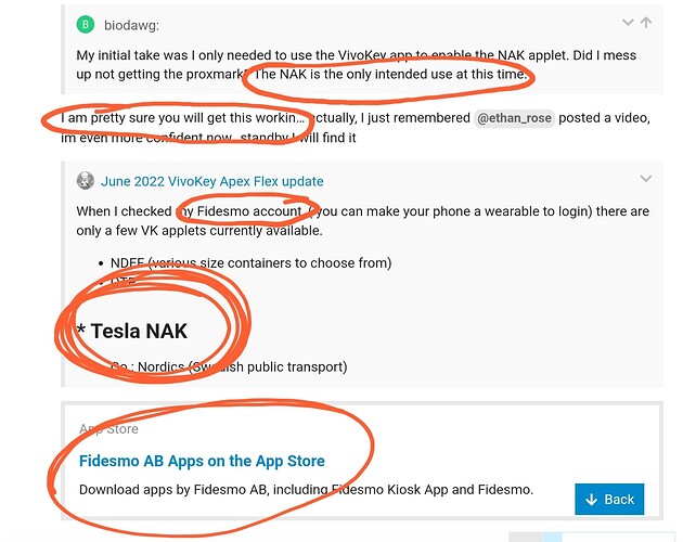

My initial take was I only needed to use the VivoKey app to enable the NAK applet. Did I mess up not getting the proxmark? The NAK is the only intended use at this time.
The Fidesmo App will pick up the AF. The iOS VivoKey app will not allow me to set it up. Just that OAuth error. Actually, the Fidesmo app picked it up amazingly quick. I just used it for scan testing. I have no use for it. Unless I missed something. I’m going back over what you posted.

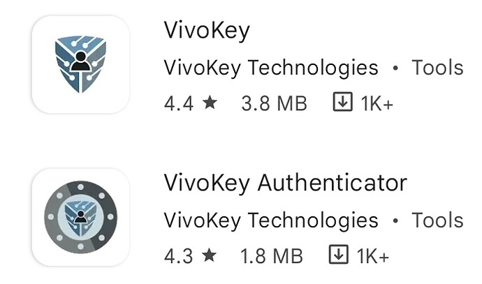

Sorry the VivoKey platform app does not currently support Apex and actually will never support it. The current VivoKey Platform is going to hit end of life soon as we are totally re-creating the backend to be modular and focused on providing services. The Apex will be supported on this new platform.

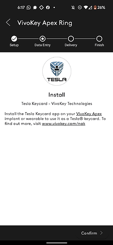

Right now there are no vivokey smartphone apps that load any applications onto Apex. The only smartphone application is Fidesmo… they are our partner for managing applications on Apex.
Once you install the Fidesmo app on your phone, you can scan the Apex and then choose an application to deploy to your Apex.
Interesting. Can you send some screenshots of what it looks like on iPhone? On Android, I have to go into settings first and enable screenshots before I can take any screenshots of the app.
