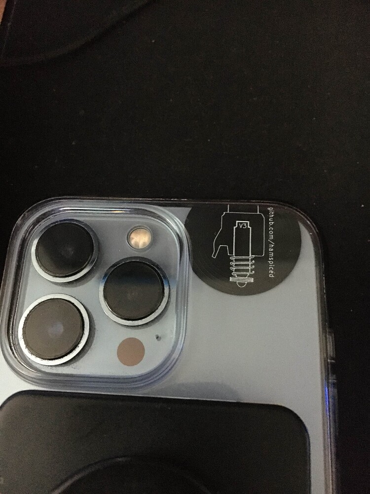

iPhones don’t have the best NFC antennas, but you can improve your odds of a succesful read if you place the very top edge of the iPhone parallel with the Apex.
Also, a MFGC can really help
With the android, place the NFC antenna parallel to the Apex and try that again.

The 2 flex’s I have scan every time with my iPhone and Samsung A23. I have a marker on the phone to show were the NFC antenna is and I also put a dot on the skin to mark the exact location of the chip so everything lines up perfectly.
