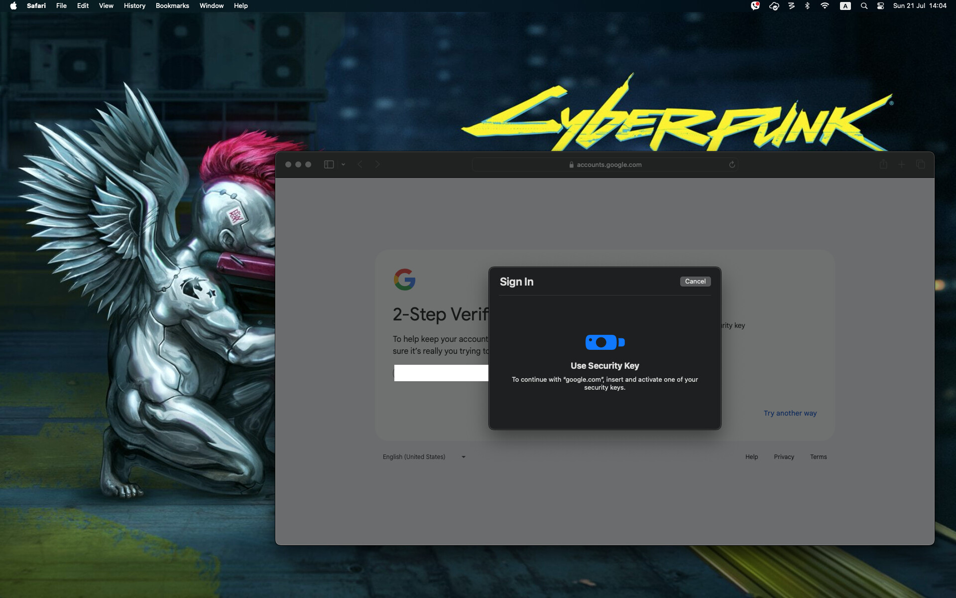

Ehhhh kinda. It’s really bad support, but if you have the acr1252 connected and use Safari specifically, it should support contactless passkey / fido2 security key functions in Safari only. Firefox and Chrome etc. still do not support it though on macOS.
What I can report so far is, no matter what I do(after half day pulling my facial hairs) - install ACS CCID PC/SC Driver, or install pcsc-lite from homebrew, safari and any other browser do not allow external reader to be used for fido2/u2f
My mac os version is 14.5 (23F79), safari version is 17.5 (19618.2.12.11.6)
Yet another perfect example how good mac os is for the general use case, but in case you need something more spicy you’re completely toasted.
Pcsc-lite maaaay be messing with things… maybe.
Can you post screenshots of this? What do you mean exactly?
What I do is nothing out of the ordinary.
Loging to gmail, when we reach the two step verification, I am choosing security key. Afterwards if I tap my apex nothing really is happening. If I insert my yubikey it works. Behaviour is exactly the same despite installing or uninstalling the pcsc-lite or acsccid. As StarGate01 mentioned, CTAP-Bridge can be made to run on mac, after all it’s python + a few shell scripts. The issue there is the mac os kernel itself. Anyways. Next step would be to try his project and find a orange pi. (like I have a few but they are big boards left over from a k3s project, and I prefer something smaller).
