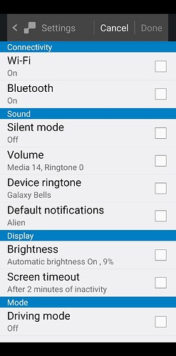

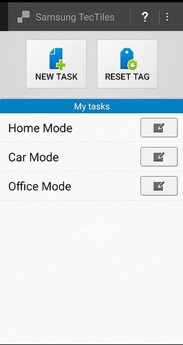

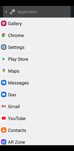

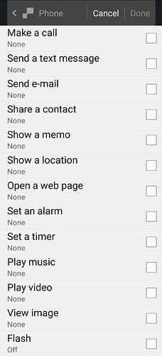

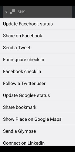

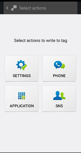

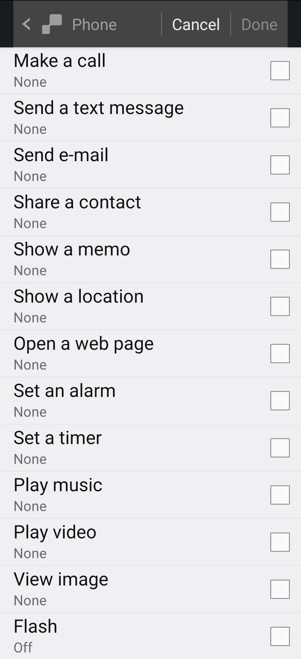

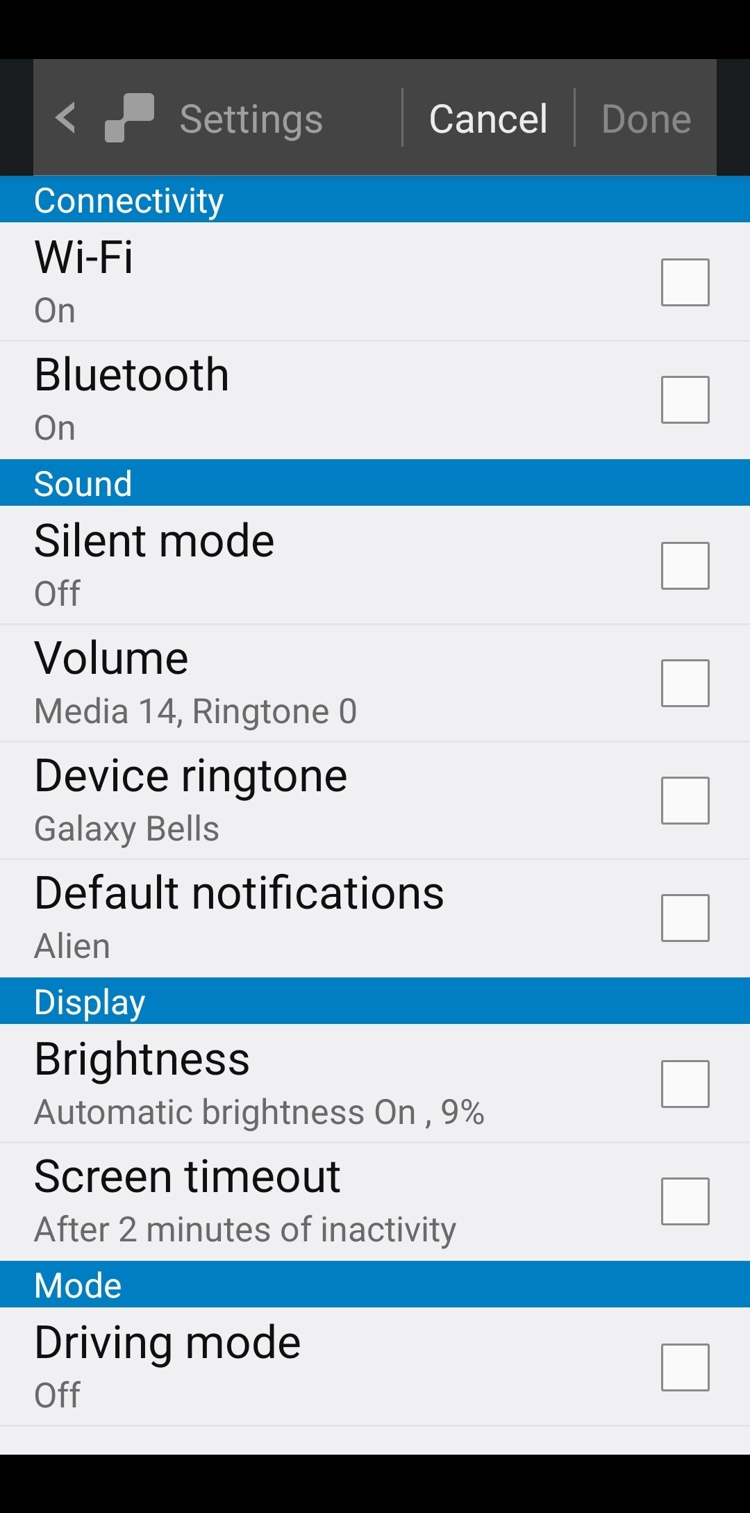

Here are some screenshots
If you want to do the same, you will need to do a couple of steps.
- Install the .apk
- Format implant as NDEF
- then you HAVE to add the following url
tectiles://www.samsung.com/tectiles - Use the App to write your task / Dataset
