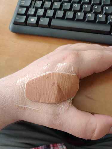

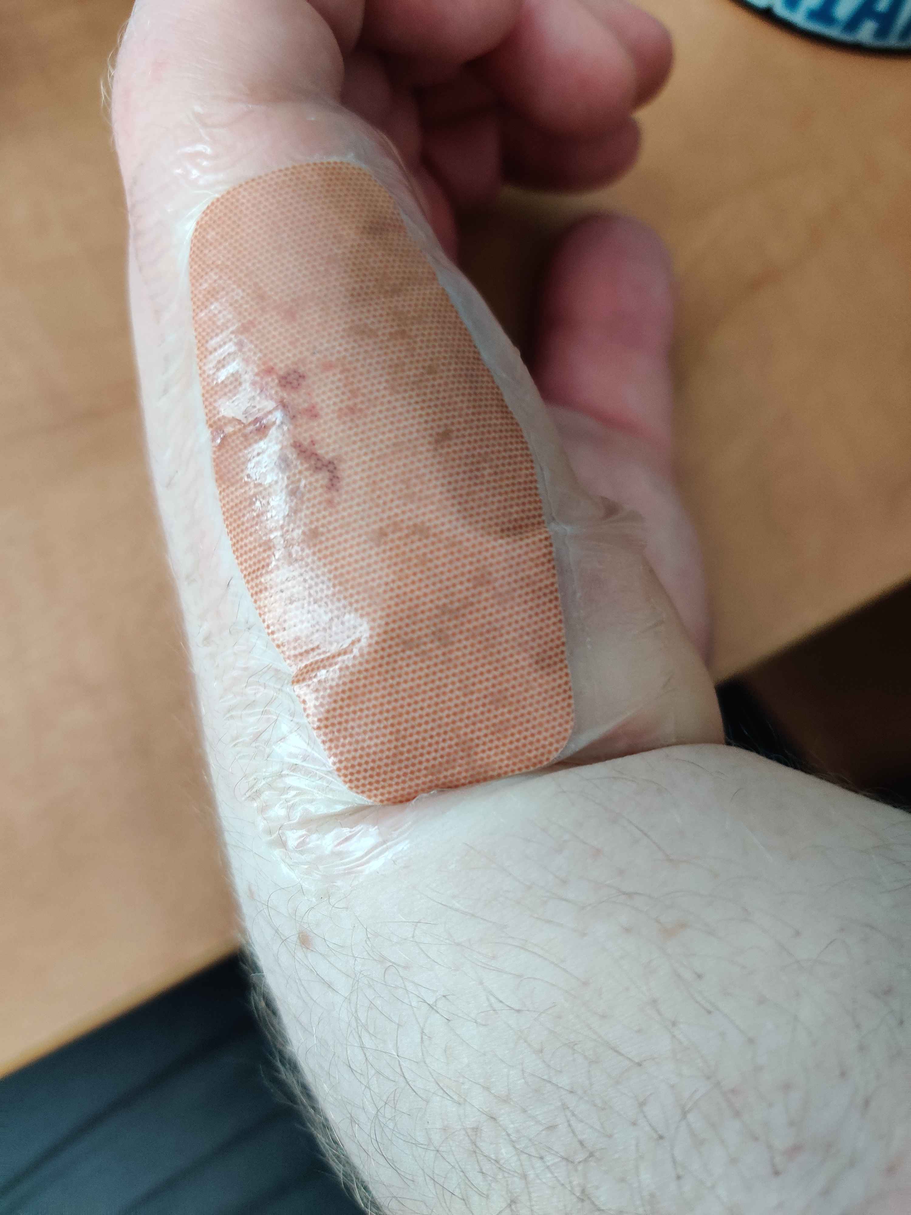

So after years of waiting I chose to make the purchase and few weeks after I get to know that soon™ might be soon™er than I thought after so long. So here we go.
What did you go with?
NExT and xSIID and I still have some left to install.

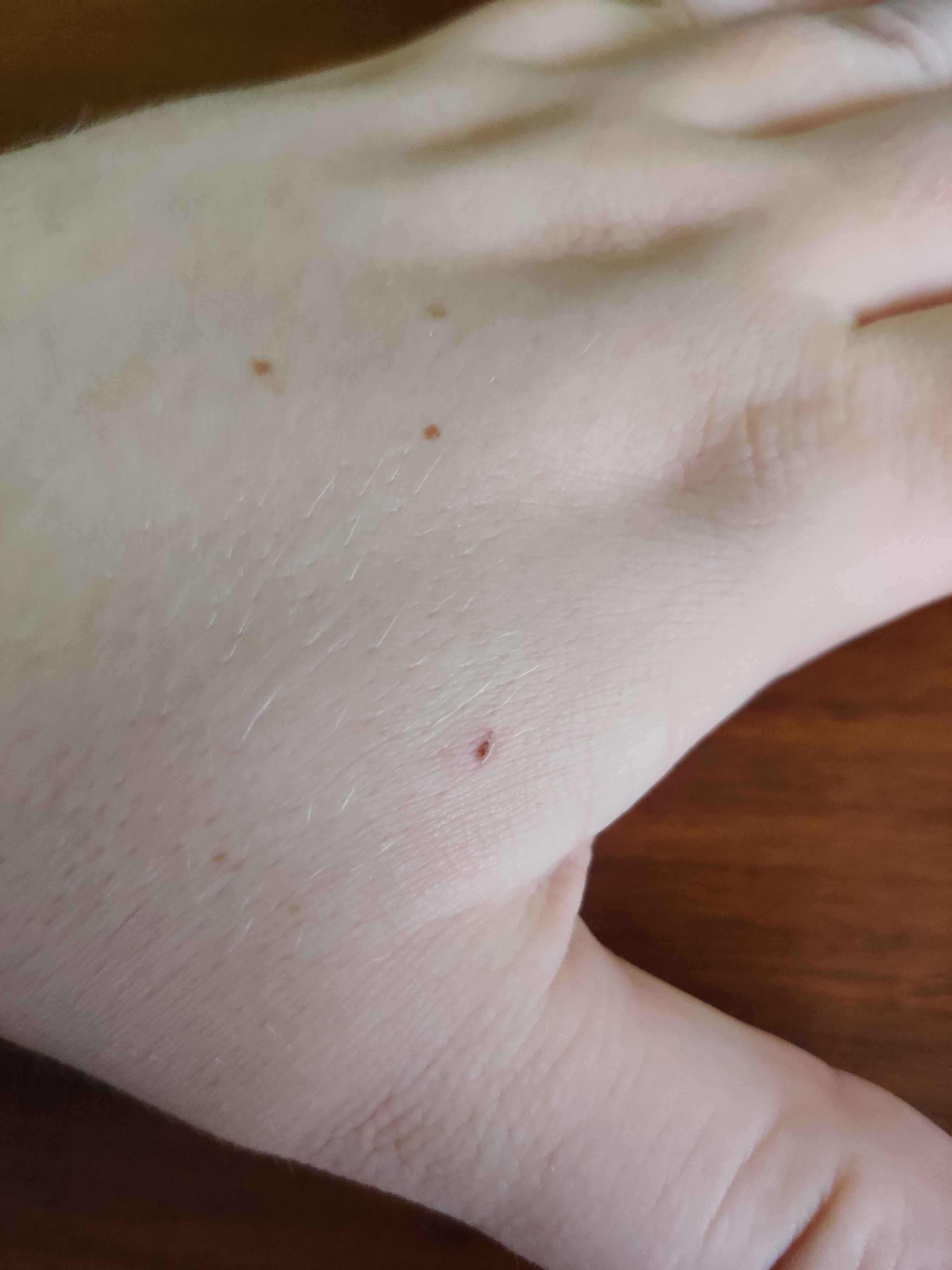

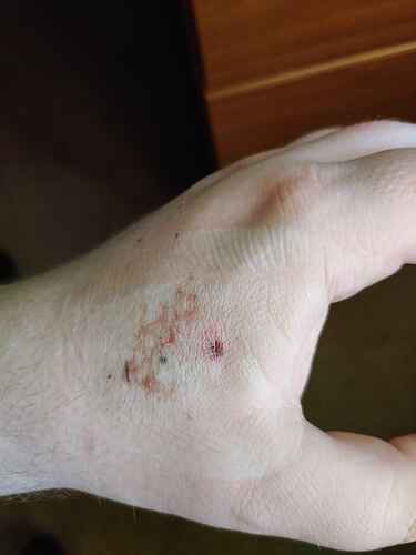

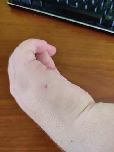

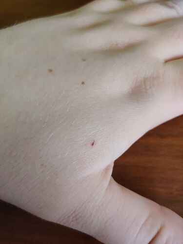

So the L0 started peeling pretty much immediately.so at least you have picture from that.
2nd day and few hours from implantation wound near to closing.
