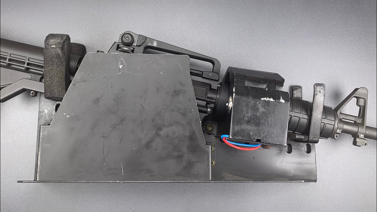

BIG gun safe RFID conversion
Might be starting a new related project

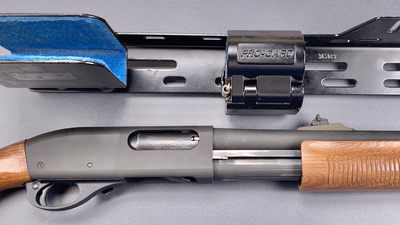

This is a electronic shotgun rack out of a cop car,
I’ve had this bouncing around my junk bin for a few years before I got into the implant stuff
Rigging a XACv2 to this might be fun
Thinking/planning that if in the near future we are able to get a house, most of my gun stuff will be relegated to a room elsewhere
The backup key mechanism is a handcuff key
:expressionless:, super duper secure… that’s going to need to be replaced or disabled
Thing that’s got me scratching my head is how to make it electronically “secure”
It’s just power in to the solonoid, so in theory a crafty kid it teenager could just apply power and pop it open
Yes I know that’s involved, but it’s possible enough I don’t like it
I think I might need to somehow mechanically cover/shield the wires
