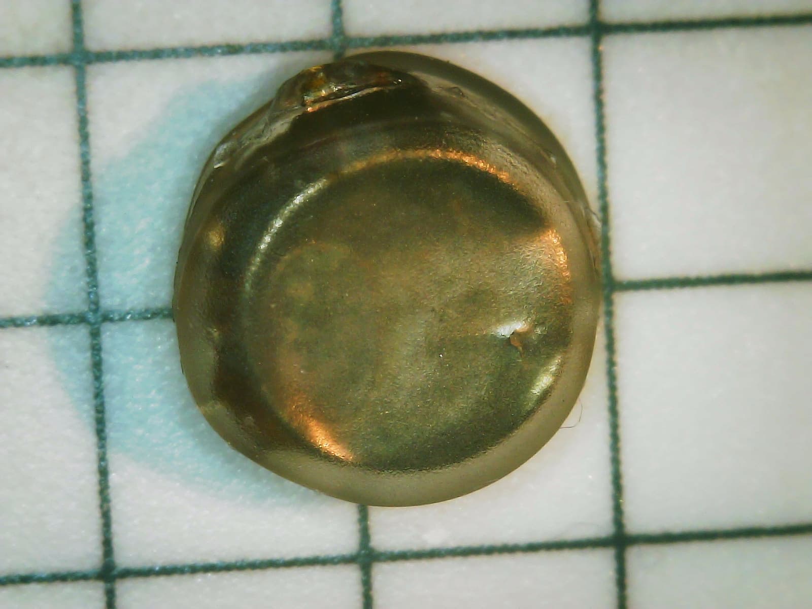

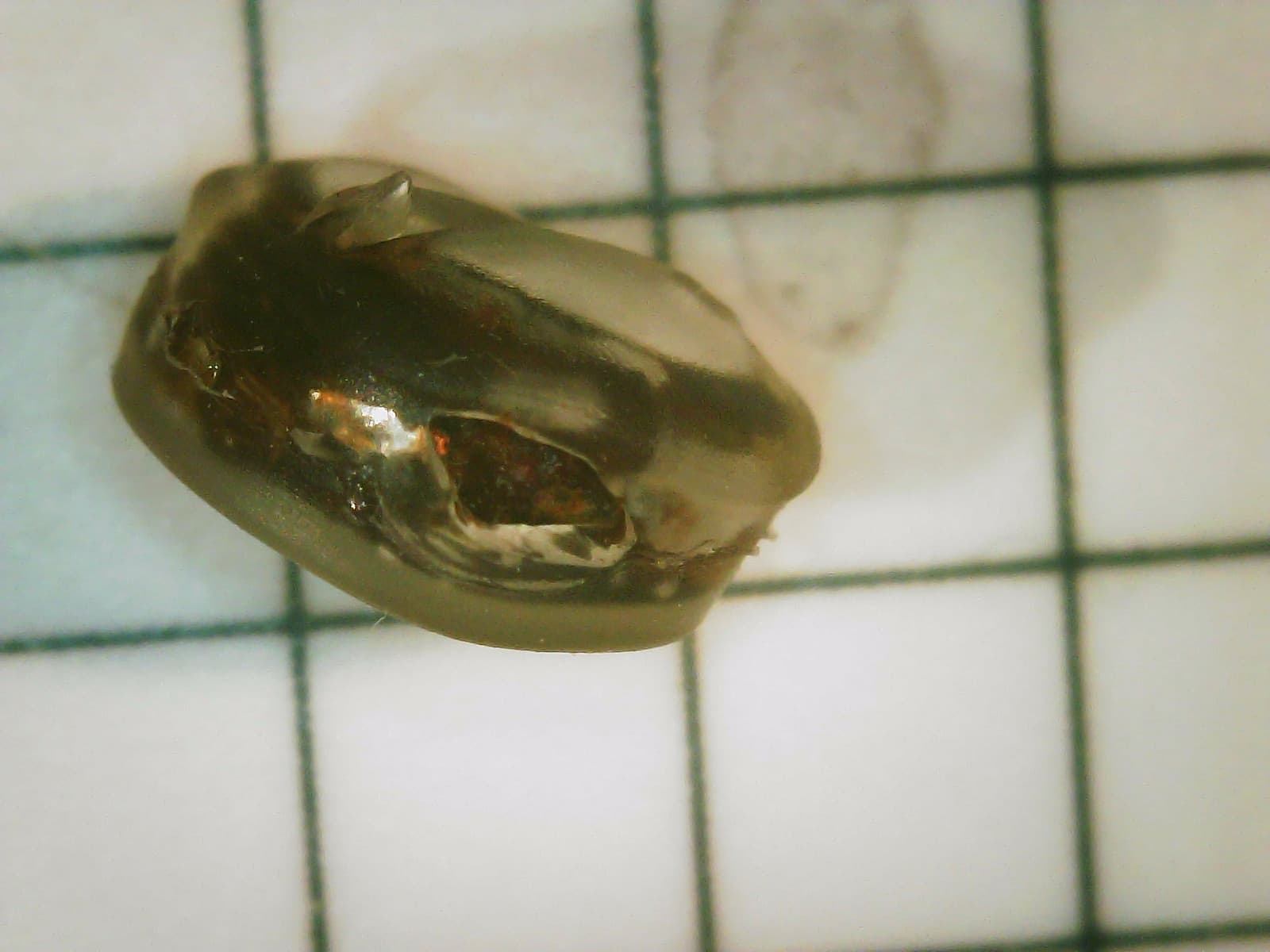

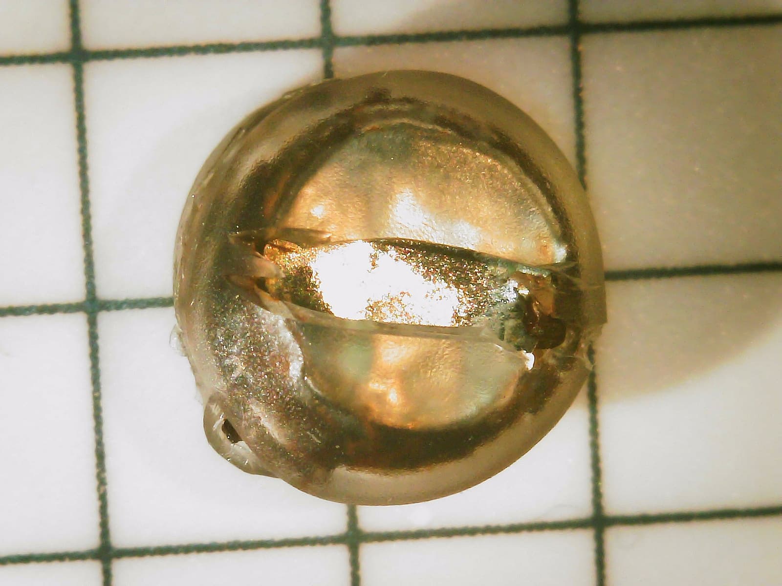

So I got it removed, the coating was indeed broken and the magnet corroded.
I kept the magnet and removed the blood, if someone is curious to see what it look like I can send pictures.
Thanks again for all those advice
edit:
here they are:
the large cut is from the removal. the fail is the hole on the side
