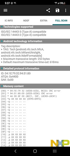

I was told to upload these to this forum.
Oh this is looking very strange indeed. It’s got crc errors and not enough memory to be an xSIID.
Can you try reading it again so it doesn’t have crc errors?

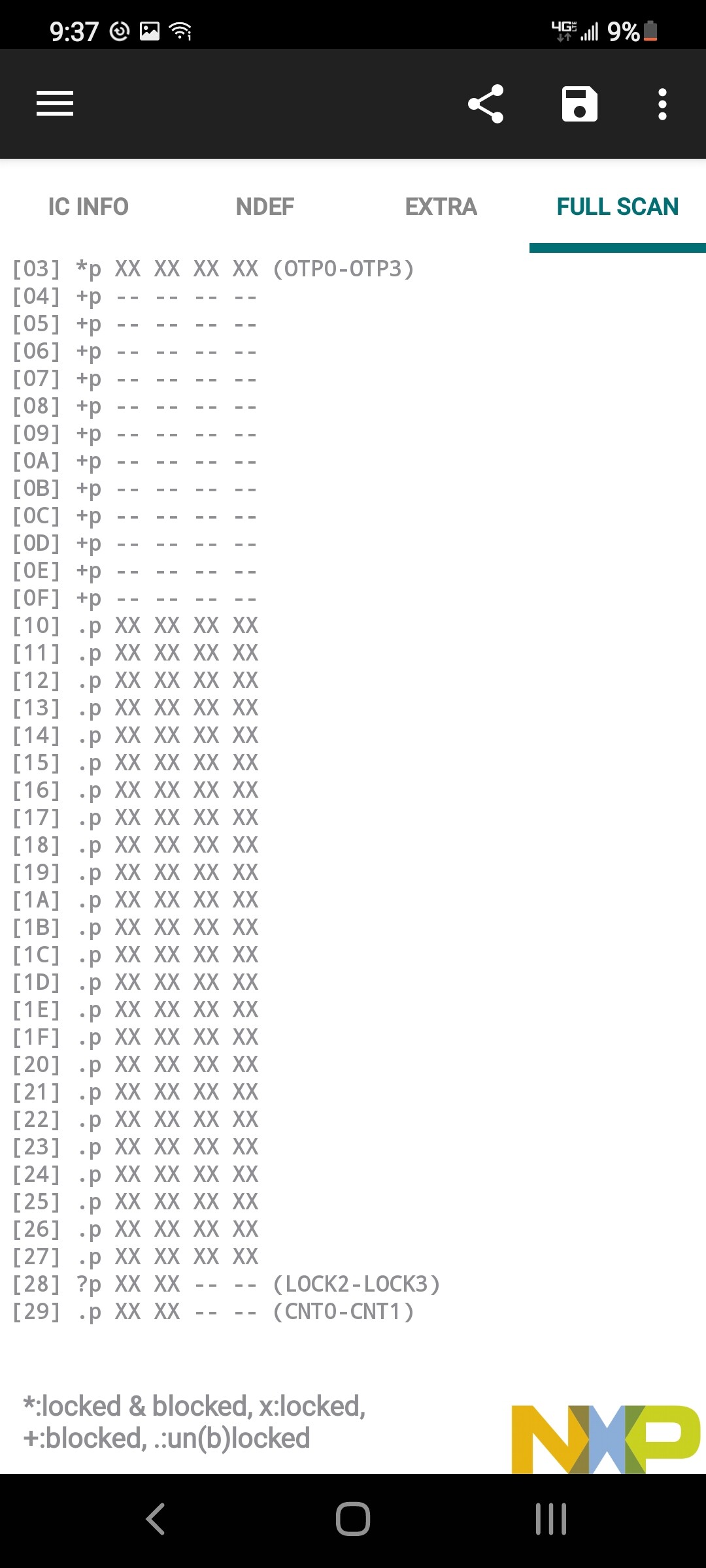

This would’ve been a lot of photos so I hope one very long photo works
Ah ok this is more of what we expected to see. Can you try running the dangerous NFC support tool to write a blank ndef record?
