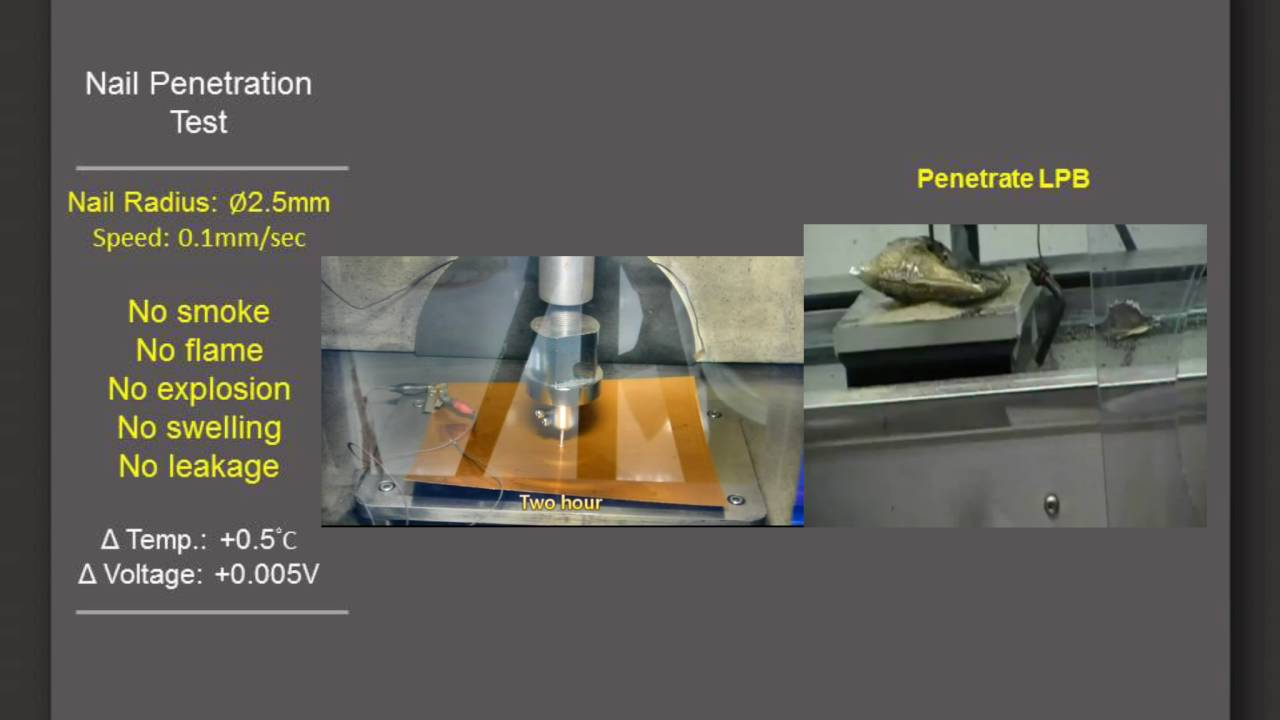

if we could find some
it would definitely be promising as it looks super safe:
I might have found some but I think they are li-po
Yeah they look like lipo’s
It doesn’t say anything about no off gassing, which is also a major concern
