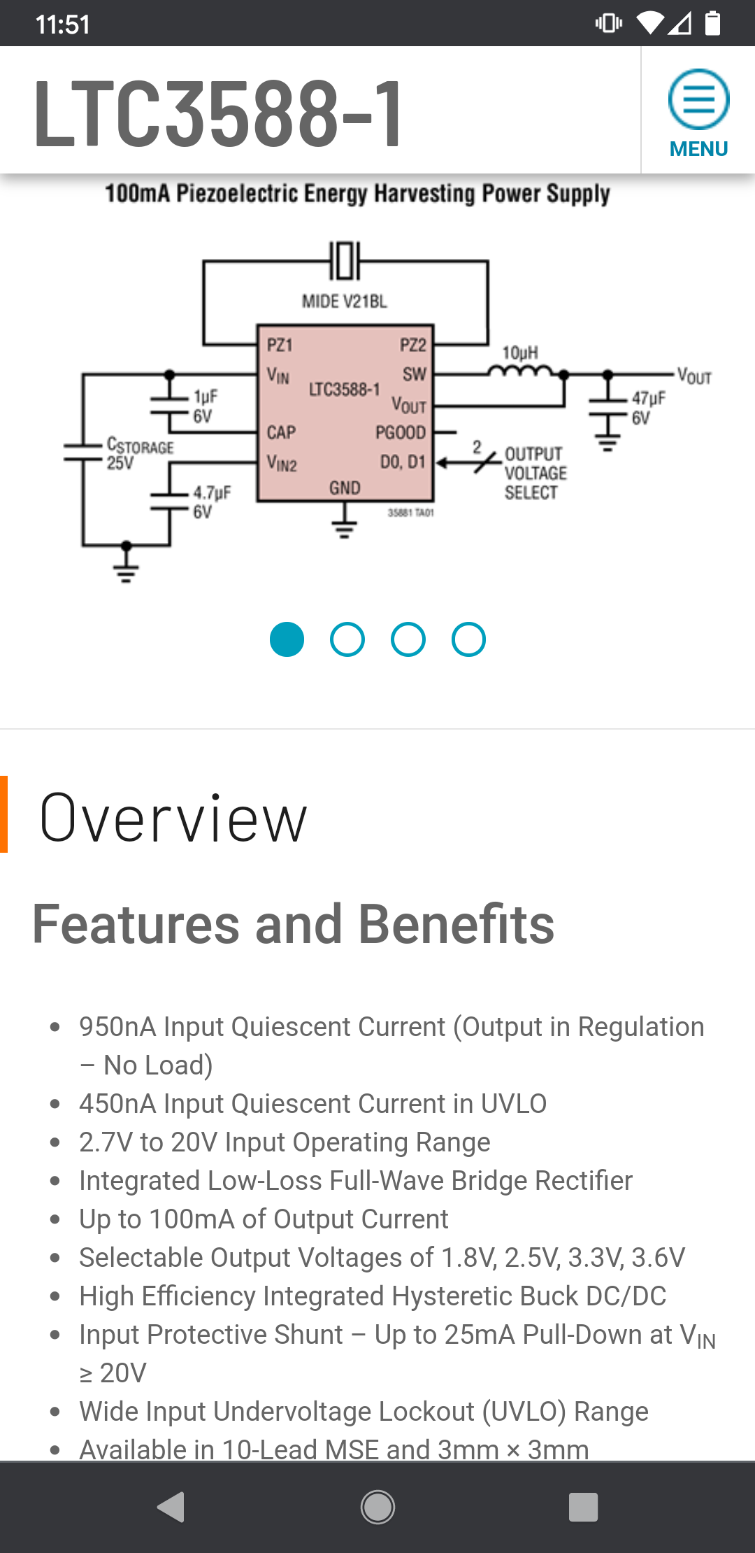

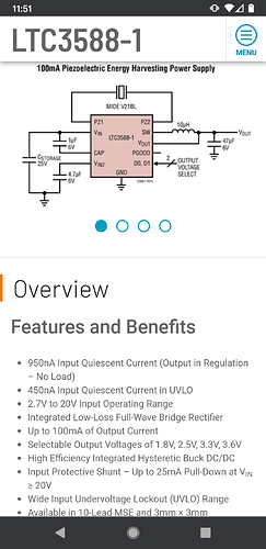

This energy harvesting chip from Analog Devices could be interesting.
I’m not a big fan of the piezo approach, because reliance on mechanical components places an inherent lifespan on the implant. If you were going to do it though, something like this would be a huge benefit.

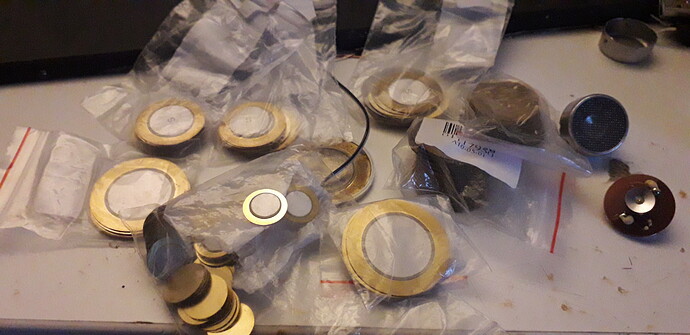

Looks like a nice chip! I don’t think though that i’ll do anything in that direction although i have a few piezo discs…
I might look into PVDF Piezos a little since they are flexible compared to the others around and they might actually work for wearables at lesst.
