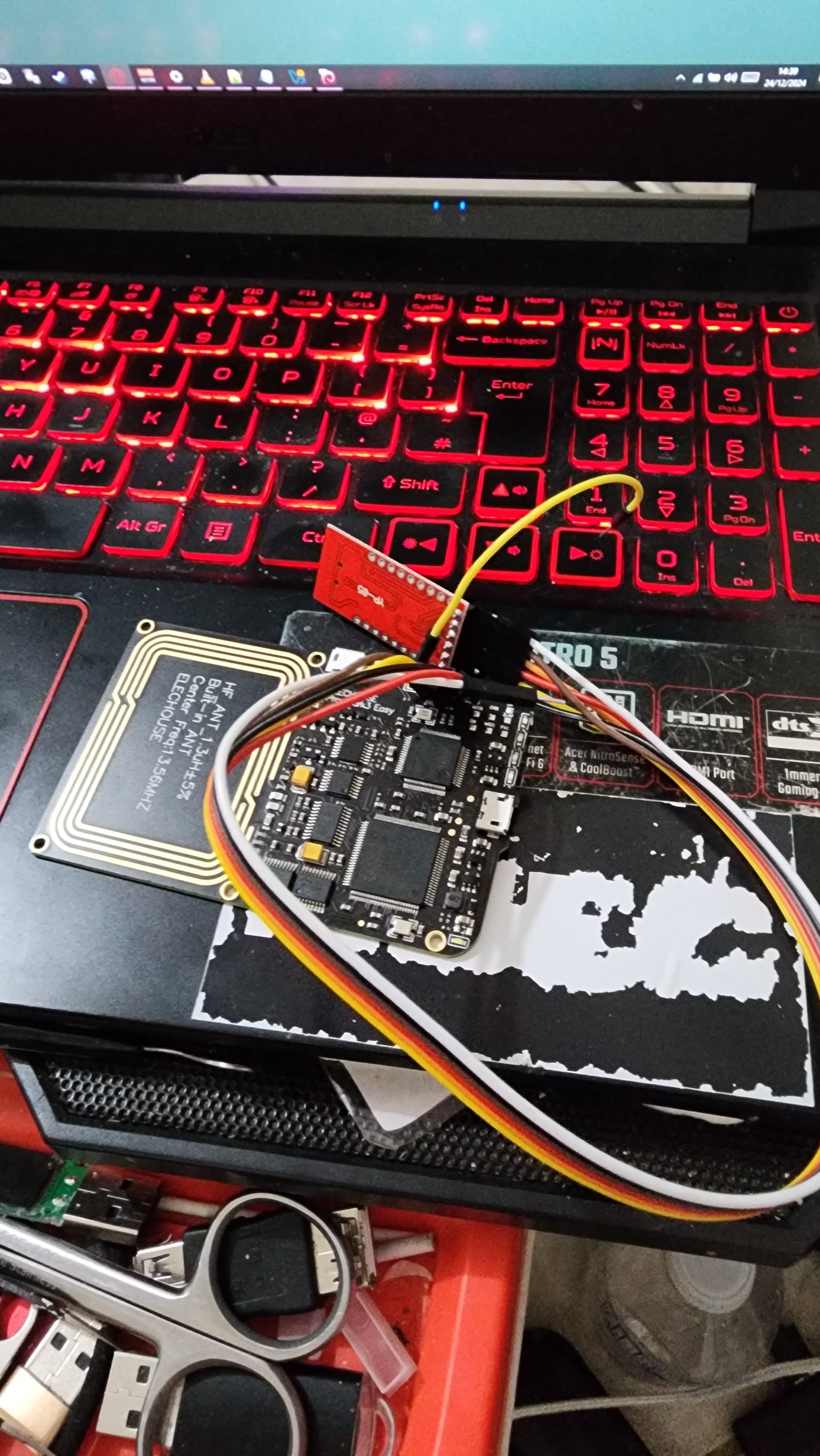

I bricked my pm3 easy a few days ago and I’m trying to erase sector 0x0000
I’ve tried the FT232H, a STLINKV2 and even a rpi4

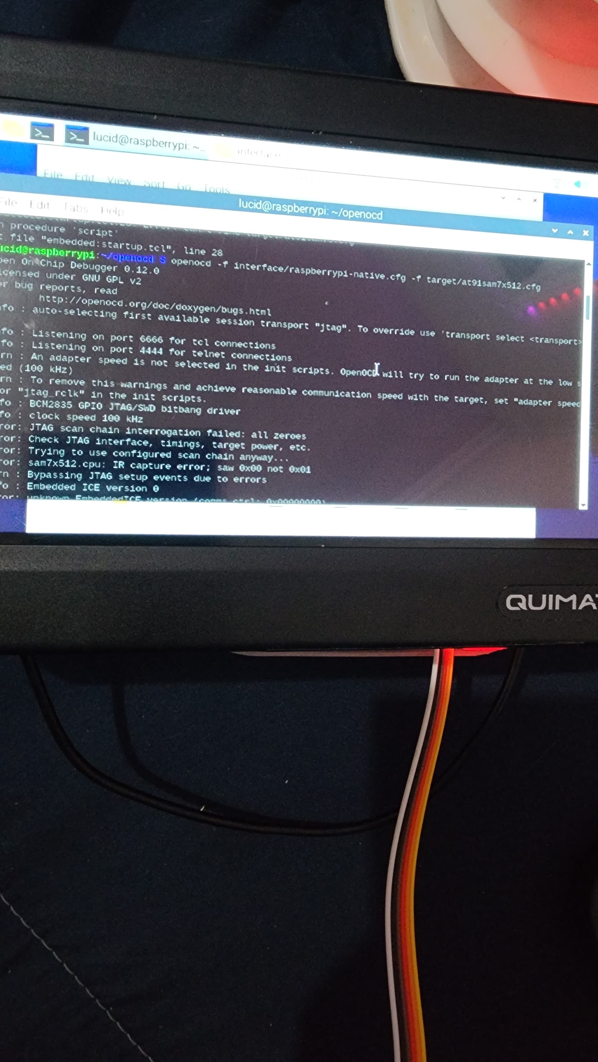

I’ve tried OpenOCD on the rpi, windows and a linux vm (with the FT232H and STLINKV2 ported) and flash magic, MPLABs IDE and even Keil uVision on windows

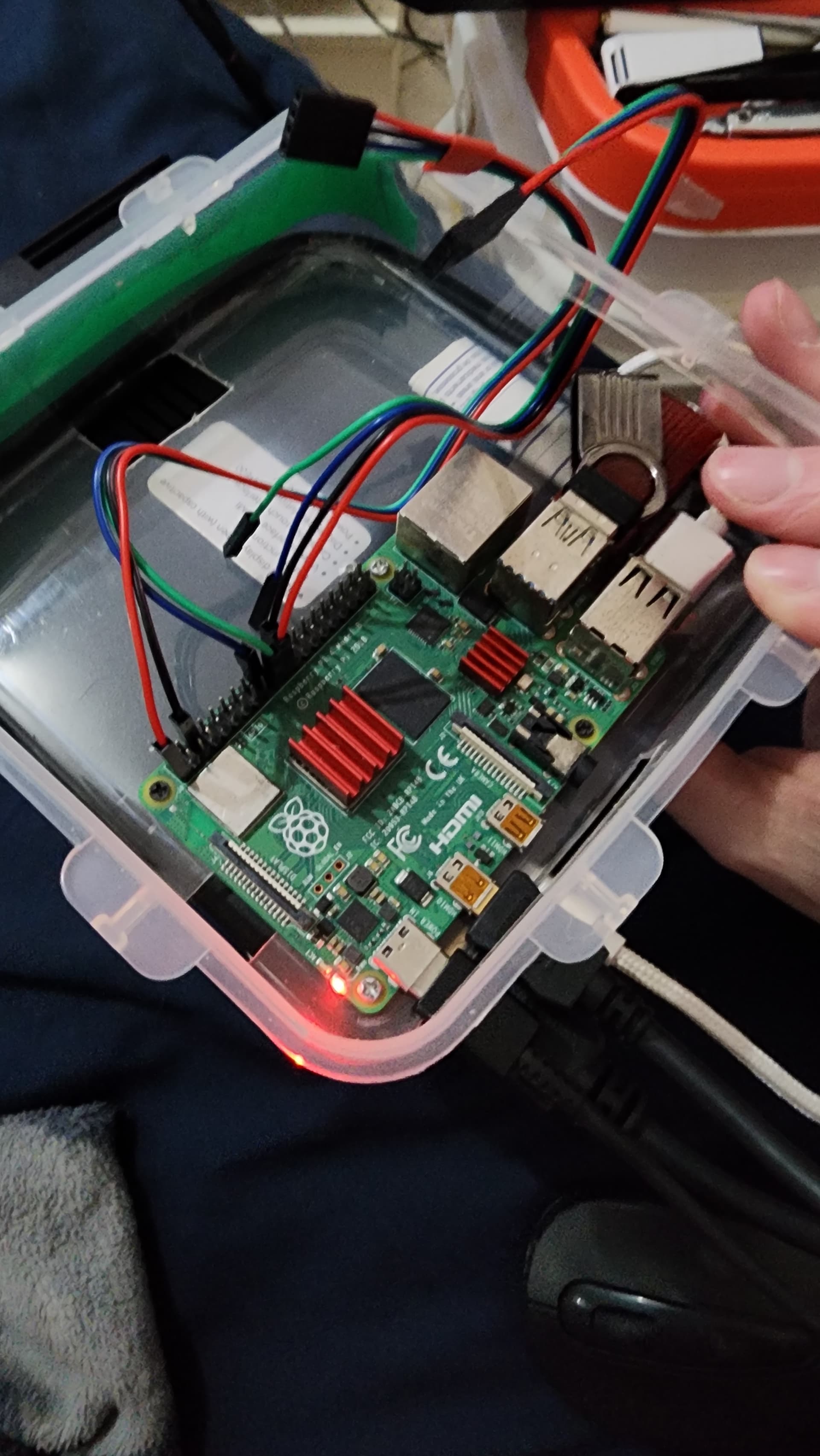

the closest I got was with the rpi4b via the bitbang driver but it couldn’t read the chip
I’ve checked wiring, cfg files, started from scratch and I’ve had no luck
I’m not sure what I’m doing wrong, I’ve already cleared bootloader protection
does someone have cfg files for the rpi4b?
Edit: Okay so im dumb lol the FT232RL doesnt support JTAG, I found a cfg file for the rpi4b BCM2711 cpu.
Gonna try it out.
Doesnt work, the rpi4b is unable to read the chip

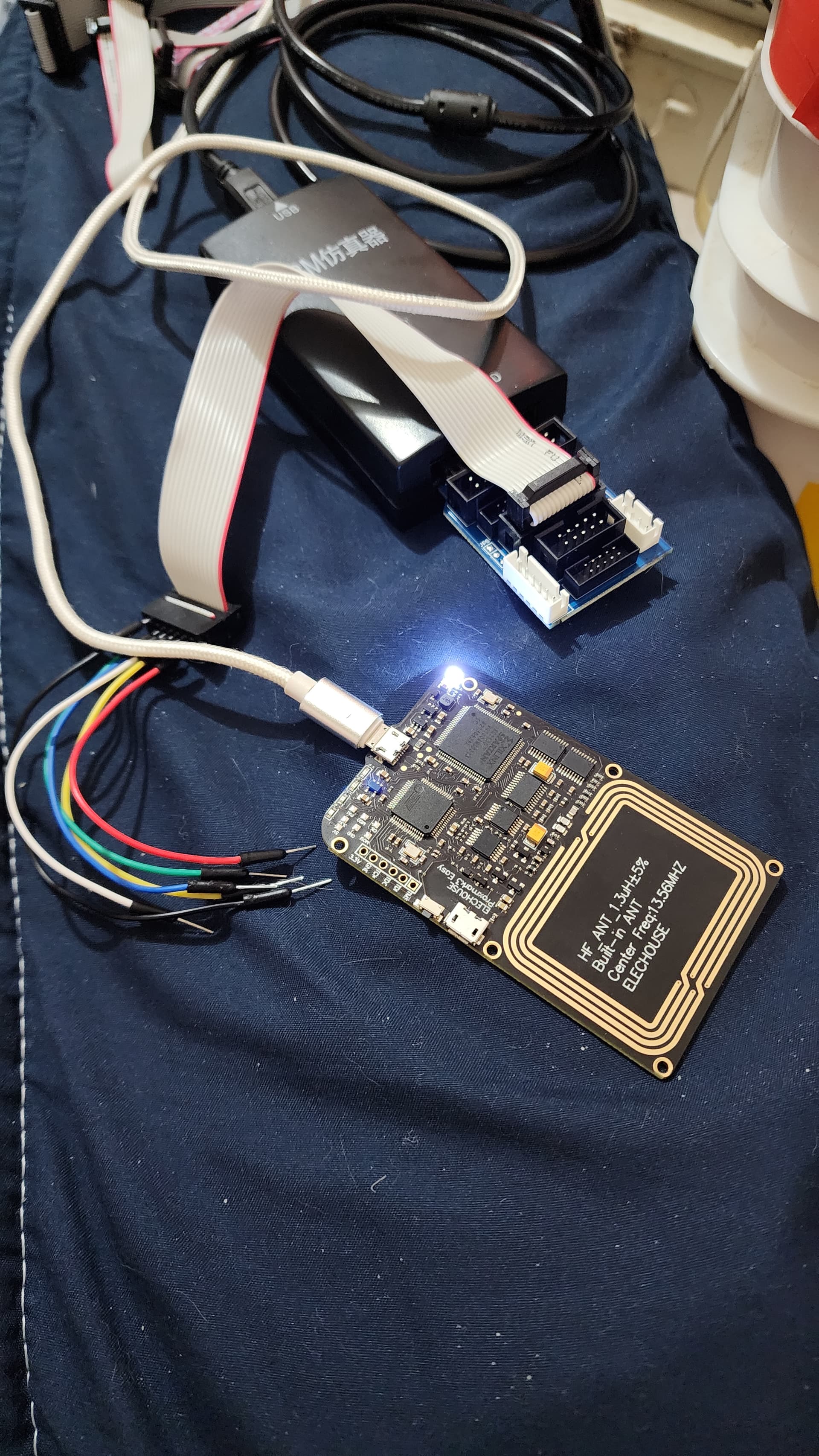

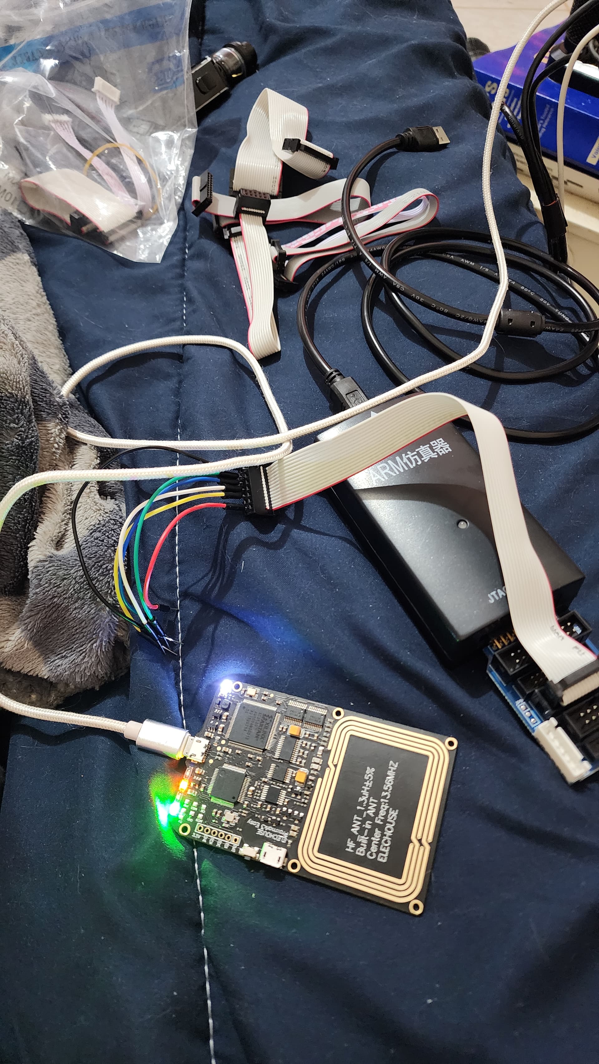

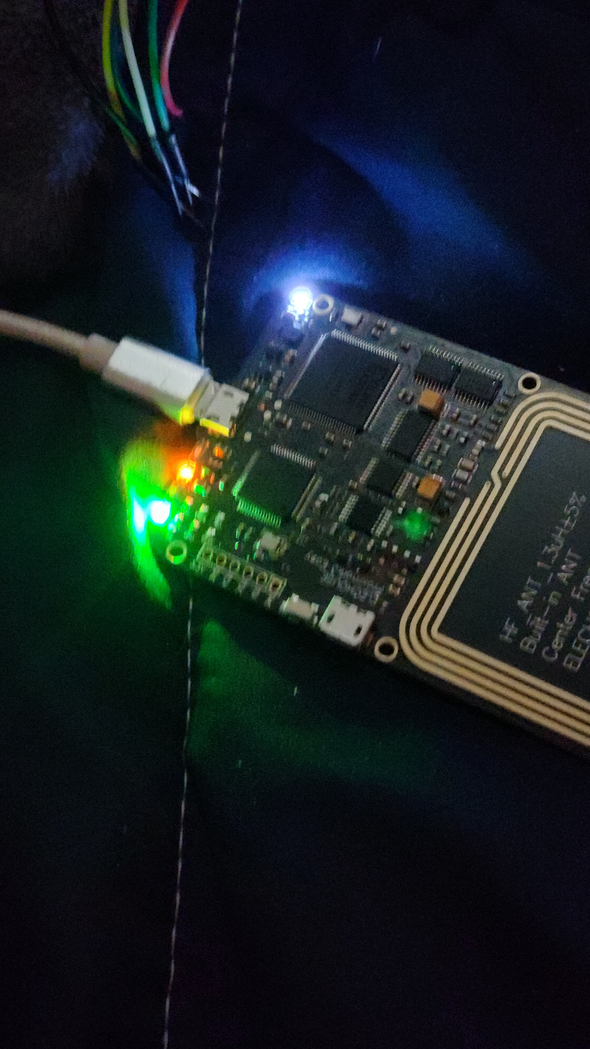

ITS ALIVE!!
Grabbed a Jlink programmer and was able to flash the recovery bin file!!
Took like 10 seconds after wiring it up
Yay!
Messenger_creation_642F146C-AB7F-441B-A8D9-ECBC444EAAB9
It was crazy how easy it was with the right tools!
I put it off all day cuz i thought it’d be a whole day of work.
From plugging in the jlink, to fixed it was a solid 10 mins lol
