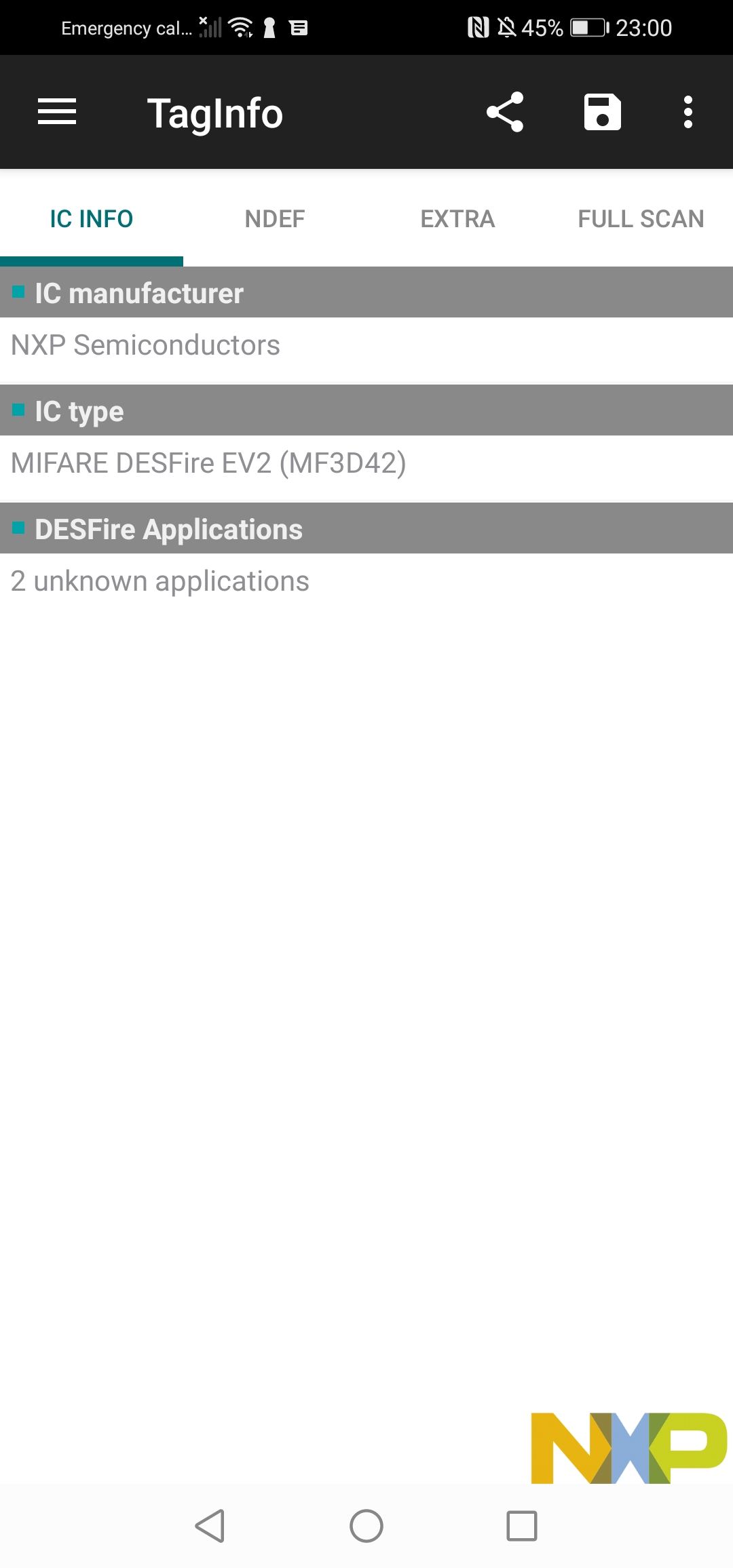

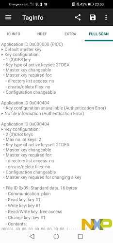

If you have an Android phone, download NXP TagInfo and scan the campus card. If it has several applications contained in it, then its most likely cannot be cloned.
2 big players in campus commerce; blackboard and cbord. Blackboard uses desfire. If the DF aid is a string of Bs, it should be blackboard from what I’ve seen.
