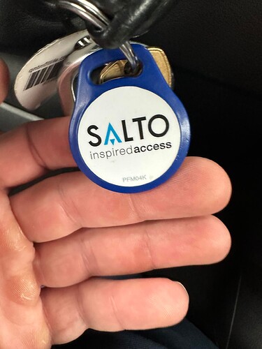

I am trying to find a chip to clone this Salto mifare 4k tag? Is this possible with the proxmark3 and is there a tag for sale that would be compatible?
There are magic mifare 4k chips out there… we don’t have any ourselves. In theory it should be possible to clone if the chip in the Salto fob is really a mifare classic 4k chip with 4 byte ID and not a new mifare plus with hardened RNG and 7 byte ID
Thanks Amal, I appreciate the reply. Is there a way to tell which type it is using the proxmark 3 w/ iceman?
