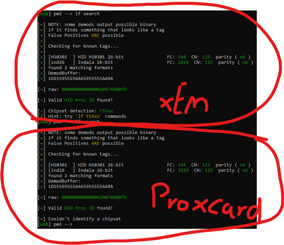

So after running pm3 → lf hid clone -w H10301 --fc 164 --cn 125 , both my xEm and proxcard appear to be the same - I cant test it at the office until next Tuesday, but until then does this look correct to you?\

yep looks good to go!
Brilliant, Cheers!
Worked like a charm, thanks everyone!
