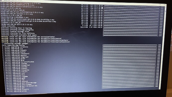

Cannot get proxmark software running for the 3 Easy
After doing the runme it start oke but stops at:
(28/132) upgrading gnupg
I do not get the Ctrl C section.
Tried several times (windows)

I’m just wondering if it is fully extracted? if it is only getting to (28/132), it might be just the first package
Did you use 7 Zip to extract it?

Used 7-zip and again stops at 28.
And a lot of warnings.
Can you delete what you have done so far, ( folders, file download etc ) and start with a fresh download.
Following this guide to the letter.

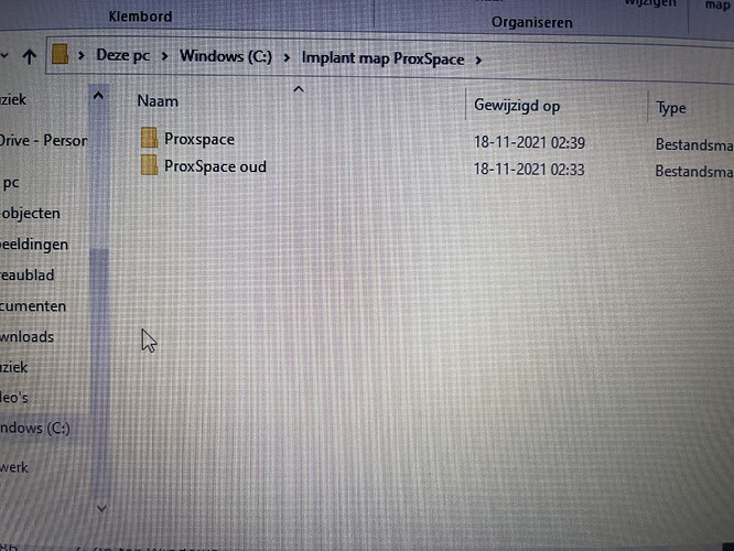

^ what he said, start over, also, specifically focus on this part of the guide:
Notice the one ProxSpace folder inside. Extract that to your location of choice… though I will say this… I suggest you put it into the root of your hard drive like C:\ProxSpace for example. It may be tempting to place it into a Program Files type location, but those folders have spaces in the path, special permissions, certain system protections, and all sorts of other nonsense can get in the way of a successfully working deployment. I personally have a little C:\working folder on my system that I put all kinds of stuff inside of… little tools… current project folders… and that’s where I have my proxspace deployment as well… C:\working\ProxSpace … now watch this handy video about how to set up ProxSpace…
The most important thing there being:
The spaces in “Implant map ProxSpace” is one of your issues, although I’m not sure if it is what’s causing this exact error.
Yep, paths with spaces or long filenames (over 8.3 char format) can cause issues. Just try c:\proxspace
