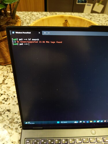

Hi Everyone-
I just bought the PM3 and I have a Schlage 9691T key fob. The problem is I can’t even get my PM3 to detect the HF tag inside this fob. I can detect LF just fine, I can even copy that to a T55 no problem. But the HF is a 13.56 MHz signal that I would assume should be detectable by the PM3 because a lot of users have these schlage 9691T’s.

Hi @amal-
Can confirm that client/firmware match. I reinstalled today to be sure. Also, I ran an hw tune. While I’m not sure what the data mean, I think this looks like the antennas are working.
Additionally, the PM3 came with CUID HF cards that are being detected
The first search is my Schlage 9691T and the second hf search is the CUID card that came with the PM3
