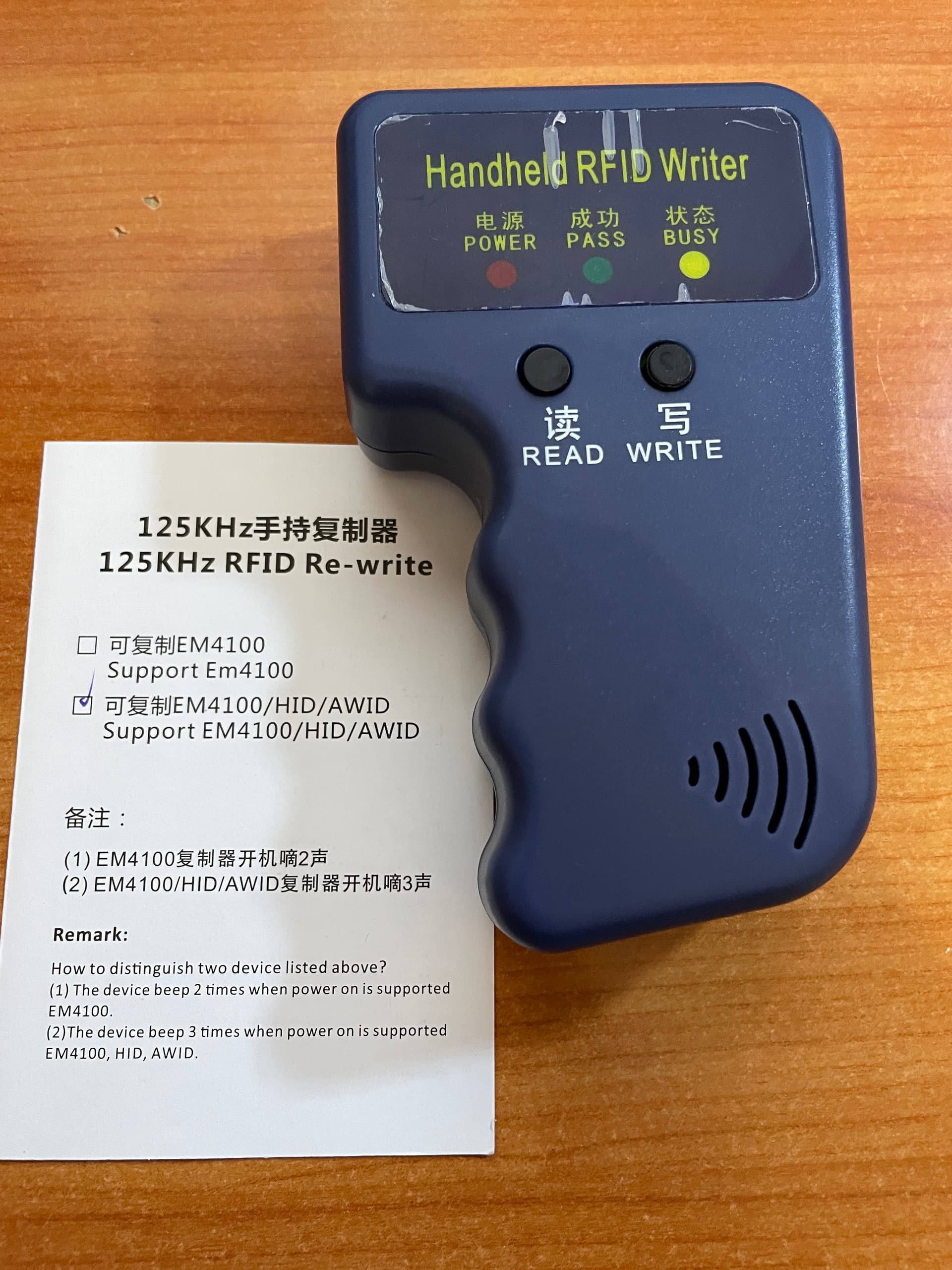

Did you clone the original with a blue clover or something similar? What are you trying to use now to clone to it? A lot of handheld cloning devices set passwords on the t5577 chip when they write to them.
This is what I originally used
Yep. That set a password on your xEM.
Are you trying to use that device to clone now? If not what are you trying to use?

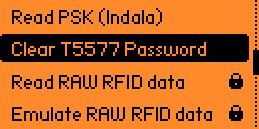

it doesn’t let you use a password when writing but there is a T5577 password remover that goes through a list of known passwords (incl the blue cloner password) to strip them out.
when removed, they’d be able to write as per usual with the flipper
Thank you. I will see what I can download to the flipper zero to strip the password. Again thank you for your help
It should be a part of MOST firmwares.
For some reason, RFID (125kHz) seems to vary a bit depending on Firmwares, you want one with “Clear T5577 Password”
Factory is limited, I don’t think it is on there, but,
It is on Momentum, and a couple of others including Roguemaster.

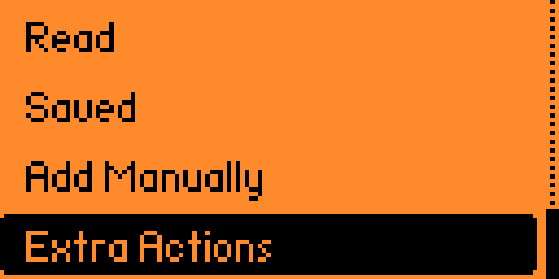

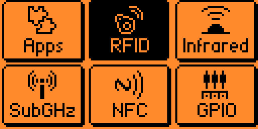

HOW TO
To remove the password:
IF IT HAS A PADLOCK, GO TO DE-BUG
SETTINGS - SYSTEM - DEBUG
Then come back and follow the guide

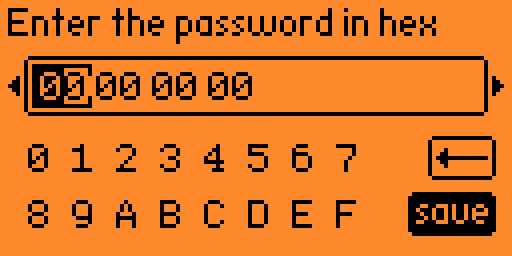

Here we can insert the password if known (which we do for the “Blue Cloner”), OR, it is probably as fast if not faster to let it auto search, so just Select “save”

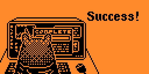

Let us know how you go
