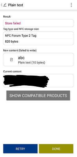

Hello, I have recently got my NExT implanted, set my contact onto it with the NFC Tools app. Since I was unable to set a password onto it, I dug around and found out that the default password is either FFFFFFFF or 4E457854 (I don’t remember which one it was, but I could write onto the chip indiscriminately). So after setting up the contact I used TagWriter to set a password to 69696969, but now I can’t seem to be able to change it to anything else and I don’t know how to rewrite the info. Any ideas?

Nope, writing fails, when I tried to add information instead of rewriting, it just said that some parts of it are password protected.

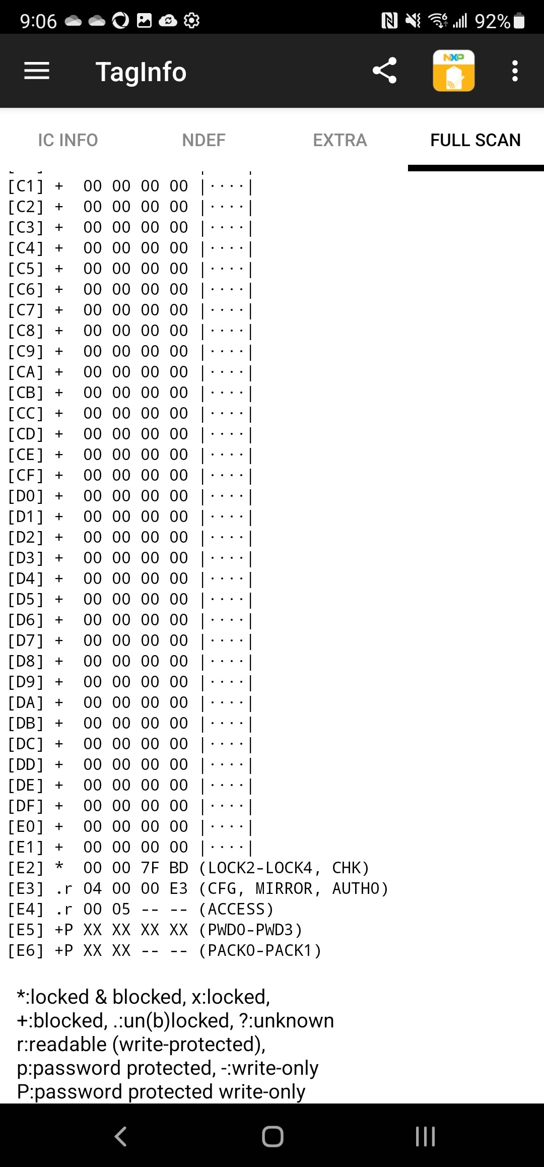

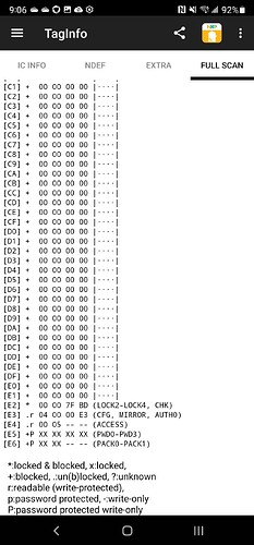

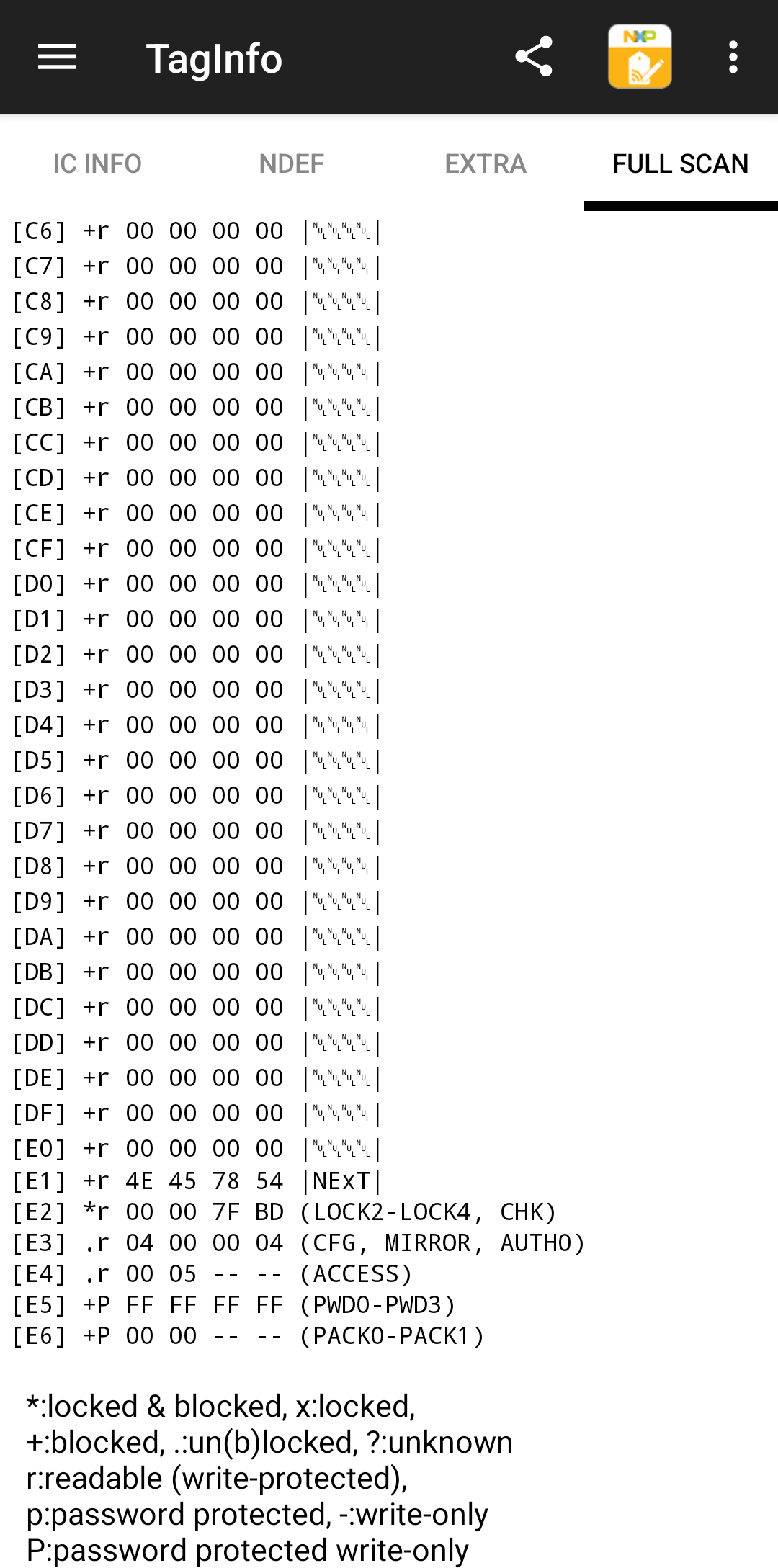

I can see from the screenshot that you changed the protected memory space from only the configuration bytes to the entire user memory. You can see the AUTH0 byte now has a value of 04 which means password protect all memory pages from 04 down.
You’ll need the correct password in order to make any changes to any part of the memory. If tagwriter is not working correctly to update information on the ntag216 then it is very likely a tagwriter bug. That team does their best but there are still bugs that crop up from time to time.

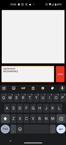

If that doesn’t work, then you have to deal directly with the NTAG216 by sending commands. You can use NFC Shell to do this;
https://play.google.com/store/apps/details?id=com.emutag.nfcshell&hl=en_US&gl=US
Send the following lines in NFC Shell;
1B FF FF FF FF
A2 E3 04 00 00 E3
The first line sends PWD_AUTH command (1B) followed by the password. The second line writes the AUTH0 byte back to E3 so only the configuration data pages are password protected. After that you should be able to write normally to the user memory.

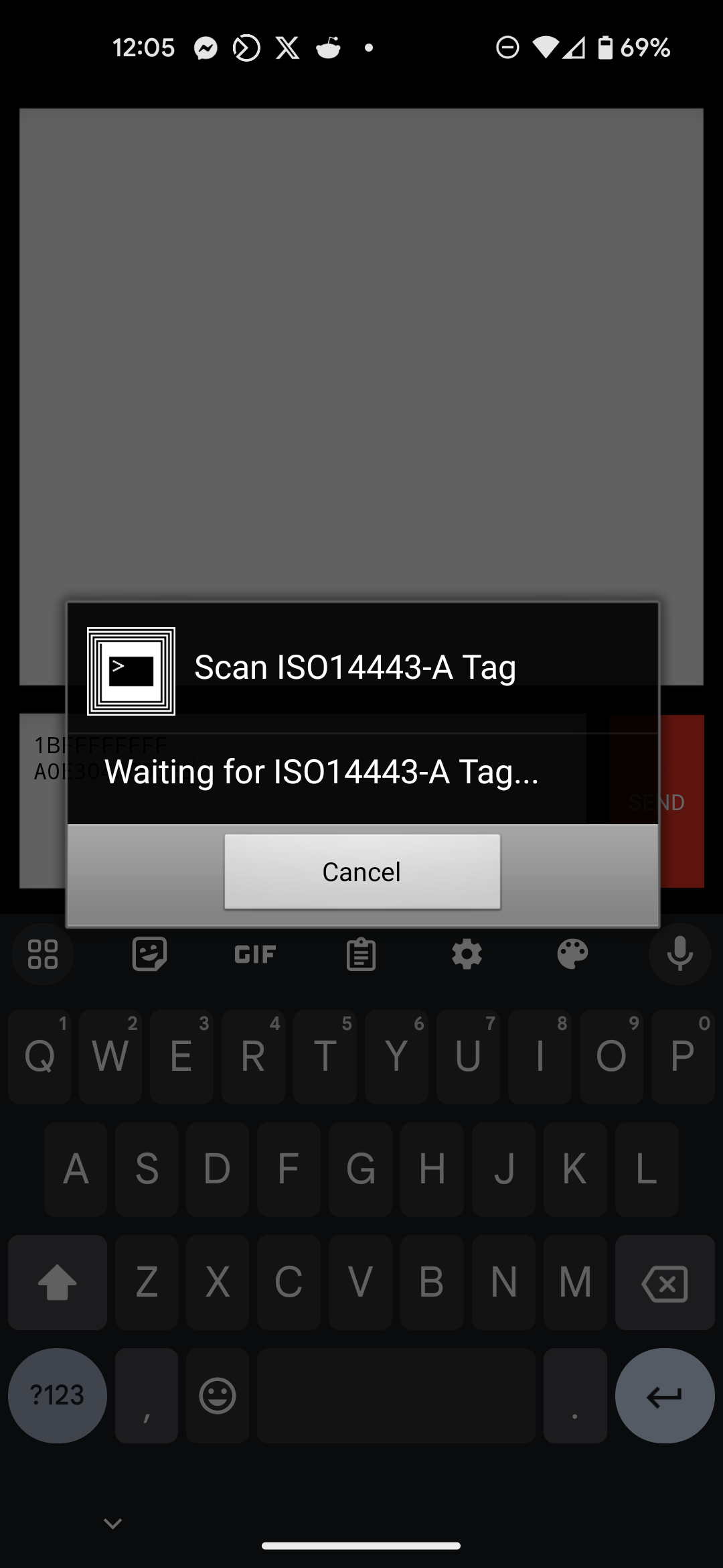

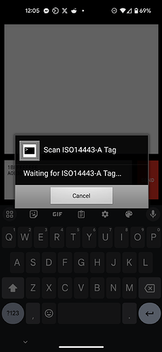

Tap send button…
Tap implant to phone

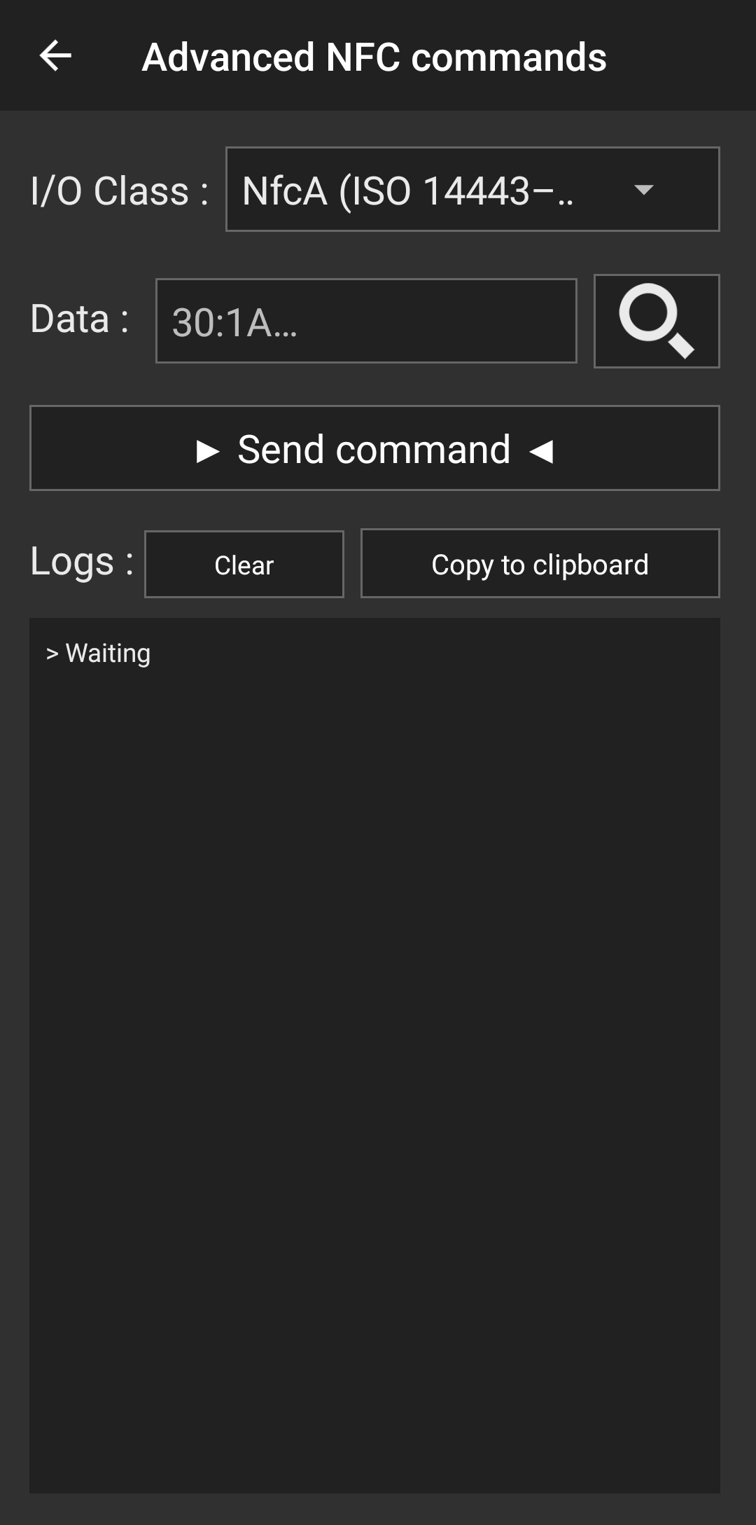

Will this tool from NFC Tools work too? I am unable to download NFC Shell
I don’t know how to issue multiple commands at the same time using NFC tools. You need to authenticate and then perform the write command during the same session (same tap). But yeah if you can issue multiple commands in a row per tap then it should work.
Great, thank you very much, everything works as it should now. Also, I found out that you can issue multiple commands in, as long as you separate them with a comma (1BFFFFFFFF,A2E3040000E3).

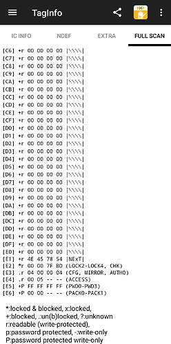

@amal I used the format memory option in NFC tools and now E0 on my NExT is 0’d out. Can I use the following in NFC Shell or RawNFC to apply the NExT password again?
1B 4E 45 78 54
A2 E3 04 00 00 E3
E0 and E1 are just normal user memory pages but due to quirks of how the capability container works and Android, iPhone, and basically every mobile phone OS not properly respecting the standard for calculating available memory pages, those two pages are basically orphaned. I just decided to put the word NExT in there. It doesn’t do anything really.
The commands you listed above will authenticate (1B) with the factory default password. The next command writes page E3 which sets some config bytes including the AUTH0 byte, but has nothing to do with changing the password.
