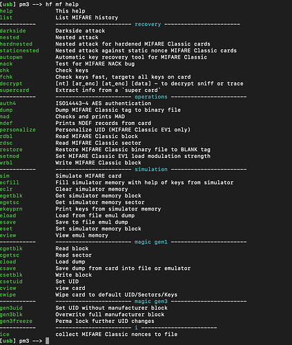

If you want to see all mf hf commands, type in
hf mf help
when I am at my computer I can feed you more info, but the step by step SHOULD be EASY enough for you to follow
hf mf help. gave me

So example for mifare classic
hf mf dump
Which would result in
Is that starting to make sense?
So if you can check you card with taginfo
Then you can try your commands with the
hf mfu commands
