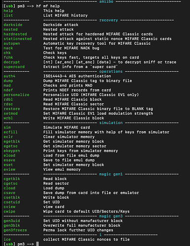

hmmm, im still having no luck. I dont know what im doing wrong, I know the hex for the "master " key. and following what I know but its not writing , ive tried various destination card types to no avail.

hf mf csetuid 04 92 7A EA A0 65 81 w
and I get this.
Set UID, ATQA, and SAK for magic Chinese card. Only works with magic cards
Usage: hf mf csetuid [h] <UID 8 hex symbols> [ATQA 4 hex symbols] [SAK 2 hex symbols] [w]
Options:
h this help
w wipe card before writing
UID 8 hex symbols
ATQA 4 hex symbols
SAK 2 hex symbols
Examples:
hf mf csetuid 01020304
hf mf csetuid 01020304 0004 08 w
[usb] pm3 →
I’ve also tried with out spaces.
[ usb ] pm3 → hf mf csetuid ############## w
STUMPED ! ? ![]()

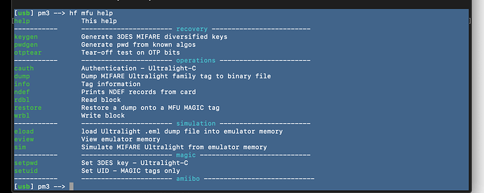

Sorry, I obviously haven’t explained myself very well.
Try this and post results
hf mfu info
and / or
hf mfu help
It’s not you , it’s me.
[usb] pm3 → hf mfu help
help This help

[usb] pm3 →
The PM3 is a powerful and capable tool, it is just not particularly user-friendly…
Anybody else playing along at home and see any errors or have any suggestions, please jump in and contribute.
I would feel more comfortable doing this on something that I own than somebody elses.
I don’t have an ultralight to test this on, so please only try this on a test card and not on an implant until you are sure it works.
What I am thinking you will need to do is this:-
Test that you can write a new UID to your TEST CARD
TEST CARD
hf mfu setuid 04 92 7A EA A0 65 81 w
Followed by a quick
hf search
to see if it has taken the new UID
ORIGINAL
hf mfu dump
TEST CARD
hf mfu restore
Then test your “Test Card” on the system.
Let us know if it works.

Can you do a scan of your “test card” you are trying to write to?
this __
[usb] pm3 → hf search
Searching for ISO14443-A tag…
[+] UID: FA 9D DD 1D
[+] ATQA: 00 04
[+] SAK: 08 [2]
[+] Possible types:
[+] MIFARE Classic 1K
[=] proprietary non iso14443-4 card found, RATS not supported
[+] Prng detection: weak
[#] Auth error
[?] Hint: try hf mf commands
[+] Valid ISO14443-A tag found
[usb] pm3 →
Hmmm, that’s what I suspected.
You have a Mifare Ultralight and you are trying to write to a Mifare Classic.
Unfortunately, that is not going to work.
So you have two options.
The Magic chips are more expensive compared to most cards
To do what you want, you would need one or both.

[=] Restoring data blocks.
[=] …[#] Cmd Send Error: 00 1
[#] Write block error
( truncated )
failed to write block 223
.[#] Cmd Send Error: 00 1
failed to write block 224
failed to write block 225
[=] Restore finished
[ usb ] pm3 →
WINNER . ![]()

For my next trick. Mifare classic to Mifare classic
yo yo, figured it out .
Mifare classic 1k
Run -
hf mf autopwn * 1 f mfc_default_keys
[+] Generating binary key file
[+] Found keys have been dumped to hf-mf-83C16184-key.bin
[=] FYI! → 0xFFFFFFFFFFFF ← has been inserted for unknown keys where res is 0
[+] transferring keys to simulator memory (Cmd Error: 04 can occur)
[=] downloading the card content from emulator memory
[+] saved 1024 bytes to binary file hf-mf-83C16184-dump.bin
[+] saved 64 blocks to text file hf-mf-83C16184-dump.eml
[+] saved to json file hf-mf-########-dump.json
[=] autopwn execution time: 11 seconds
Then -
hf mf restore 1 u ########
