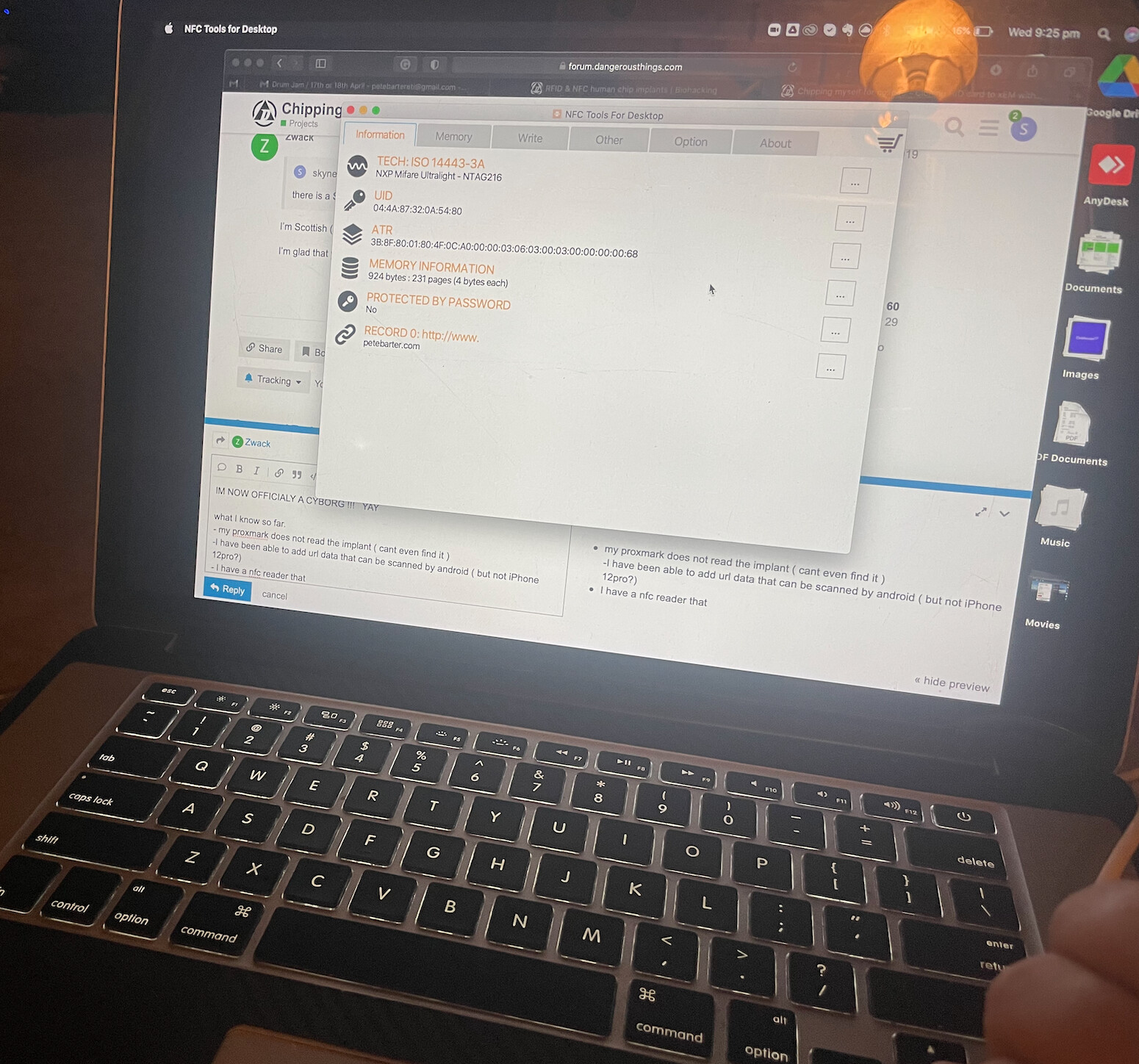

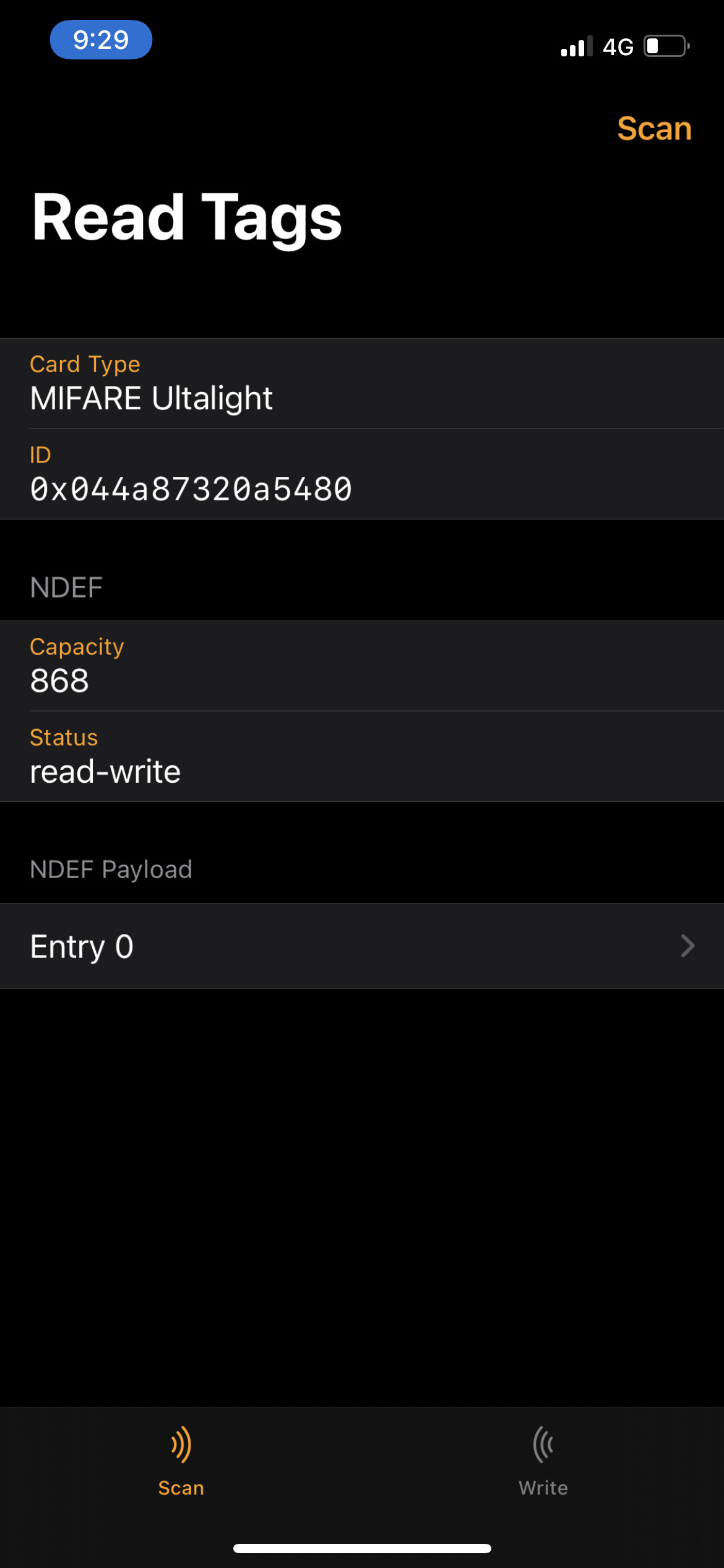

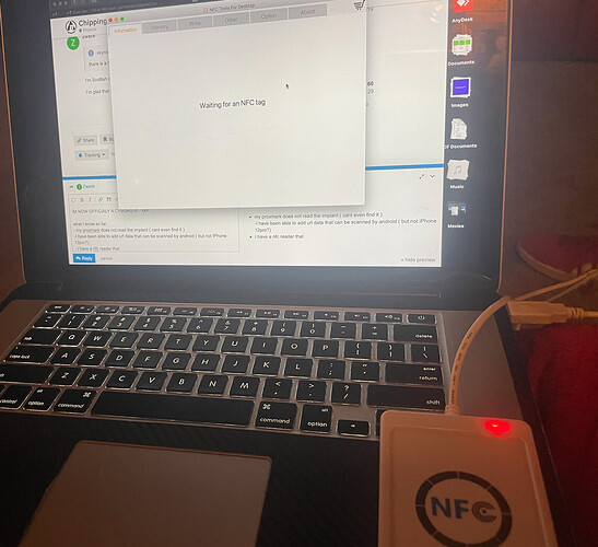

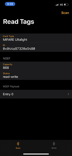

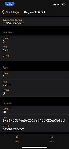

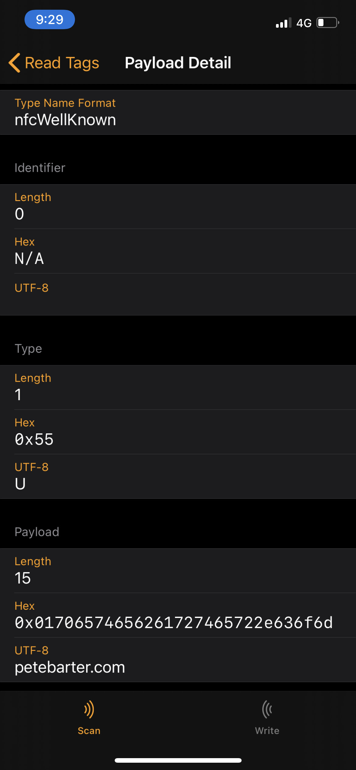

I can read the data using NFC app on iPhone ( NFC Utility )

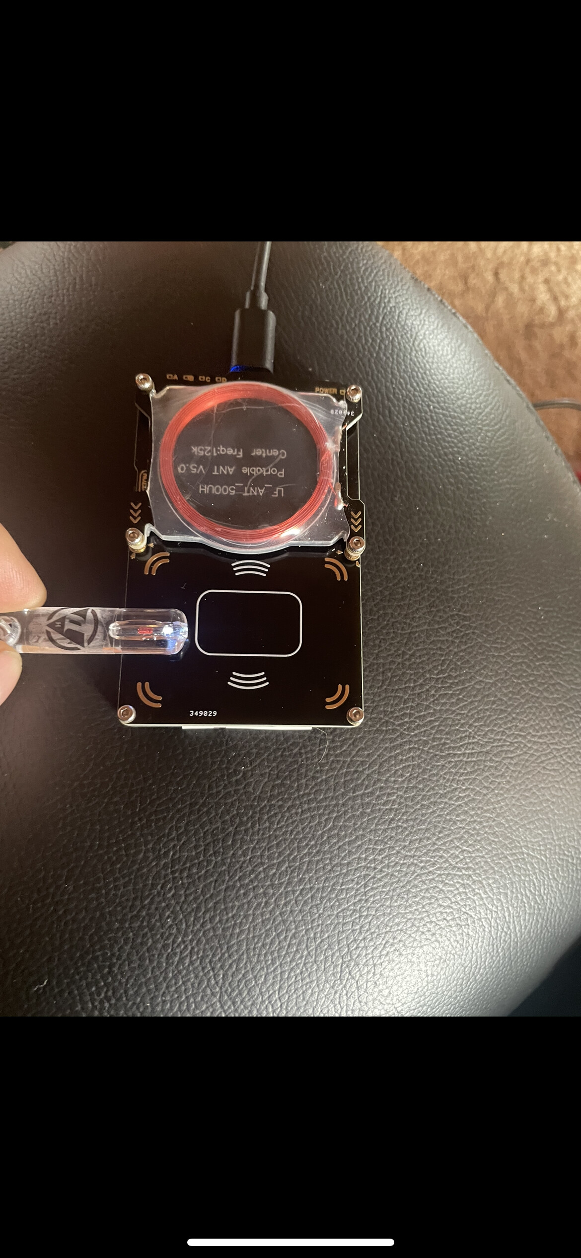

my concern is that I can not access the NExT on the proxmark. any ideas cyborg brains trust ?

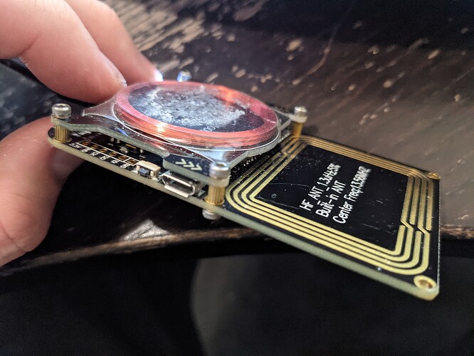

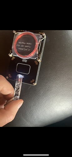

Also position on the proxmark3… what model proxmark3 do you have? Do you know where the HF antenna trace paths are? Do you know how to properly position the NExT over the antenna traces? Send a photo of your proxmark3 and where you think the HF traces are
Thanks Amal.
See this is a trick played on you by Big Proxmark! The HF antenna is actually not on that PCB… it is on the bottom PCB. You will get best coupling if you flip it over and apply the bottom of the unit to your HF implant.
Some people simply remove the middle PCB because it’s actually 100% pointless. I have no idea why they even include it to be honest.
Here is a photo with the center pcb removed…
You can clearly see the HF antenna on the bottom pcb.
bastards !!. worked instantly on the bottom. !! thanks legend !

I had been wondering that myself.
Although to be honest I would have pointed to the area shown and said “The HF traces are on the lower board under there”. I wouldn’t have thought to turn it over.
I do wonder if the extra board is to make you think it is more substantial than it is, or to improve the performance of the LF antenna (at the cost of the HF antenna).
There are eight small traces on the middle board which might be intended as passive radiators for the HF antenna. But testing that would require someone with more tools and radio skills than I have.
My hunch is that it is there for tuning and isolation between lf and hf but honestly the effect is miniscule
