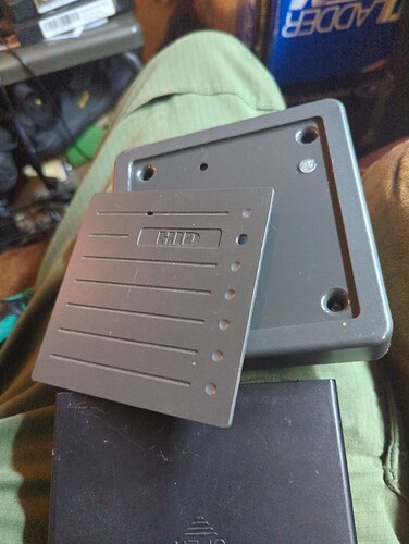

In my experience with the older readers from HID like the one below
The read is best from the sides of the reader rather than the middle, I would guess that it is a Prox credential rather than a EM card especially if the reader is branded as HID. I looked at the HID Global site and could not find a mention of EM410X readers, I checked everything they had that contained “EM” and it yielded regulatory stuff and some stuff about their old (windows 2000 era) card printers. I would hazard a guess that your Proxmark firmware and software needs to be updated or their firmware versions and software versions dont match up and you’re getting misreads. To update your firmware do this

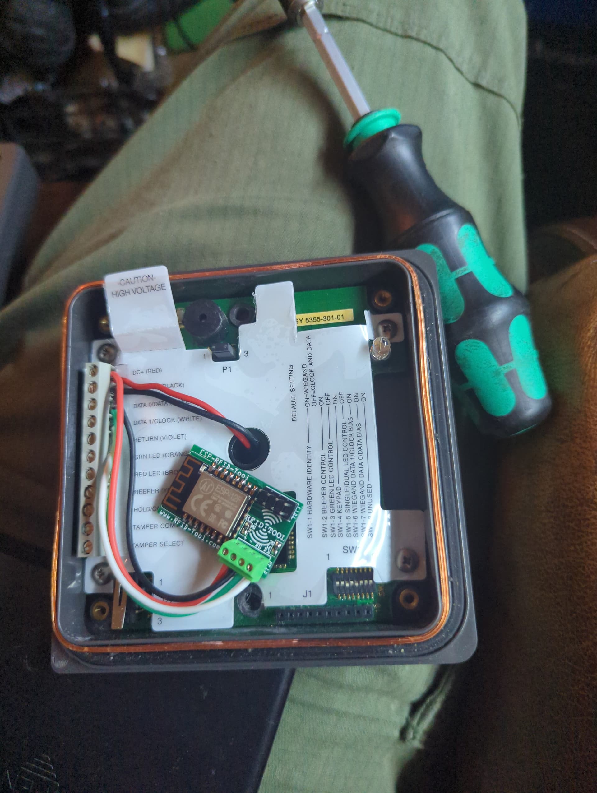

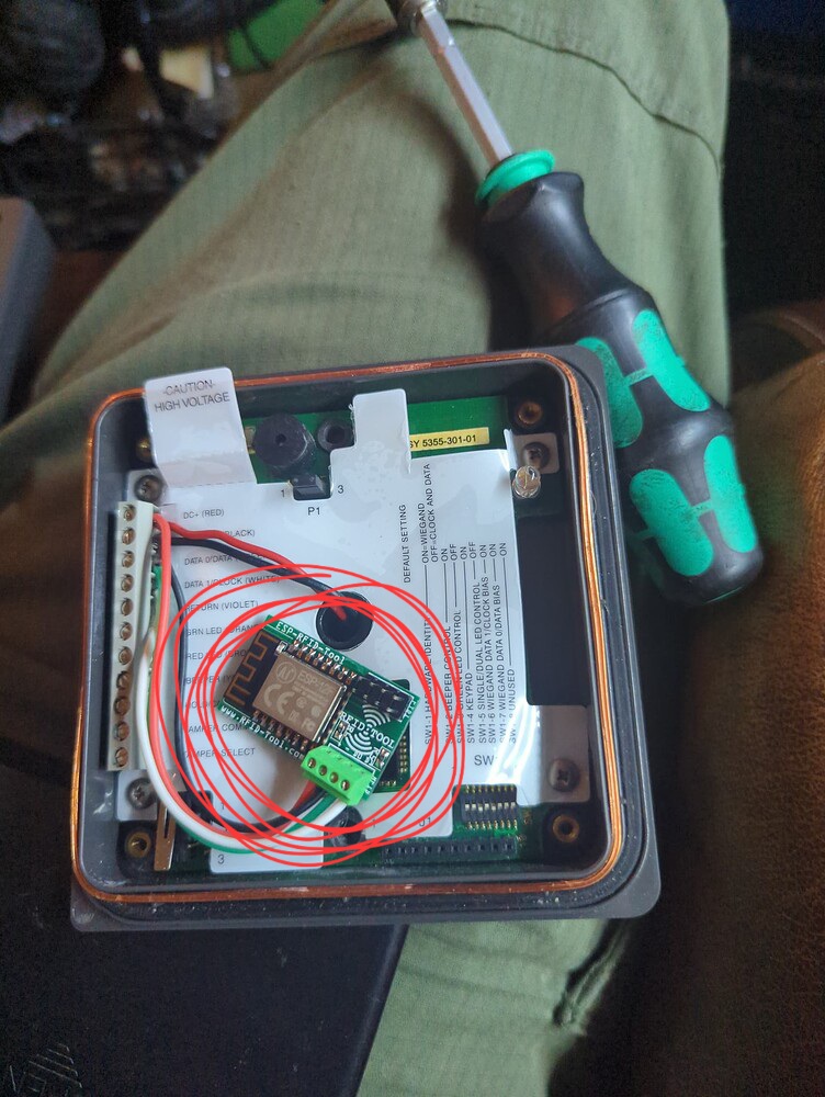

I have one of those readers and the antenna is pretty much under the square line incised around the edge. The middle is about as far as you can get from the antenna while above the pad.
See.

I was wondering if anyone would notice that. Yes, that reader is not connected up to an access control system. But it does have a cheap alternative to an esp-key attached to it (along with a battery pack).
This is why you really should connect the anti-tamper switch that is provided up to an alarm.

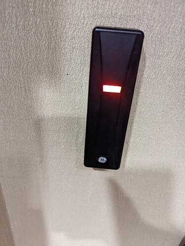

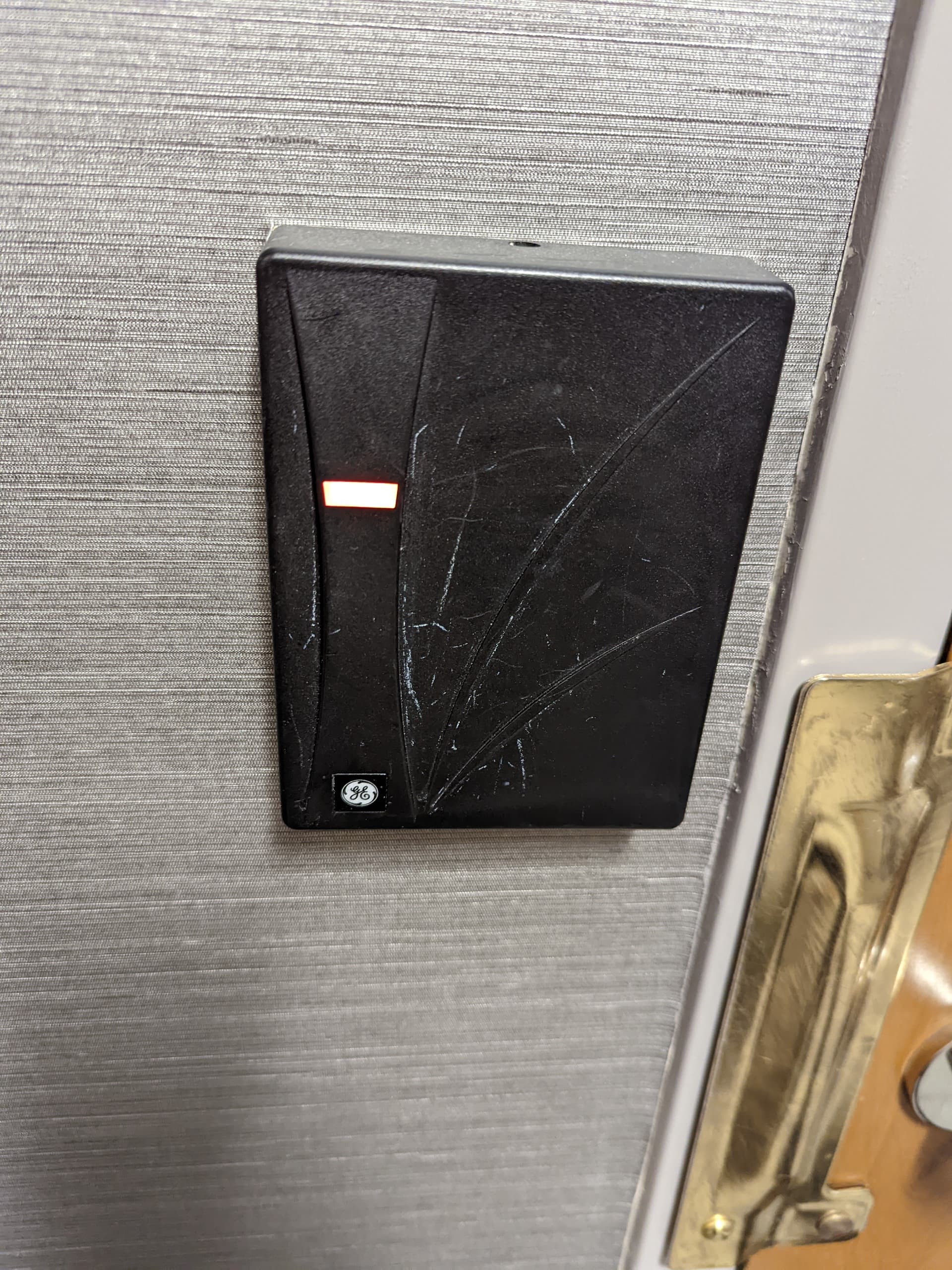

I was mistaken, the readers are all GE branded.
