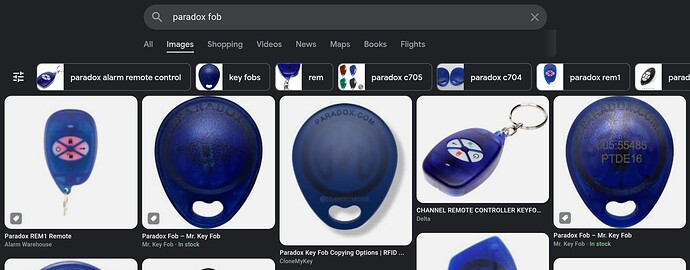

Hmmm, is that a powered fob? ( does it have a battery and button etc )
Google image search suggests, that it may be, but there are “normal” looking fobs also
