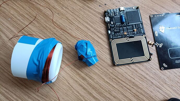

Thats all I did too. I wrapped my coil around a plastic tube that the tag just fit inside. I moved the tag around in the coil until I got it to write successfully I’ve written a few paxton tags now so it is working consistently once you get the right place in the coil. I cannot however write a hitag2 disk tag despite wrapping a coil to work with it.

Do you have an LC meter? I’ve been using that to get my coil to exactly 500uH.
Yes - I was using both the multimember to measure the inductance and then hw tune on the proxmark3.

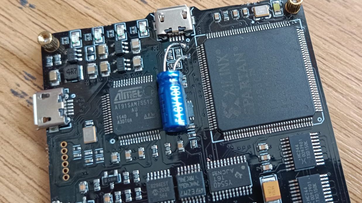

I have made a little progress - after reading your comment about the power output being higher on the RDV4 I wondered, if the USB port power from the laptop might be limiting it. I connected the side USB port to a USB charger as well as the data/power USB to the PC and that made a significant difference. I have now successfully written page 6 and I have had data in page 7 that is not FFFF’s but it is still not correct.
As power supply clearly made a difference I tried adding a 100uF capacitor just inside the USB port to see if that would help further to stabilise the power rails. The capacitor on the 5V rail has not made any further difference, so I was going to add one to the 3.3V rail as well, as I presume the data transmission bursts on the coil give the power rails a hard time.
I have also started a larger coil in the hope that changing the position of the fob more might yield better results.
Here is the capacitor on the 5V and the larger coil. I have wound it higher, and then unwind to 500uH.
I have still only managed to write page 6 on one tag. I can’t get repeatable performance. Improving the USB power was the biggest performance difference, so it leads me to think is an RDV4 with it’s more powerful antenna the answer?

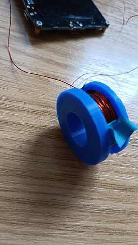

I tried a neater antenna on a 3D printed former, but no change to writes - all FFFFF’s and it measures 501uH.

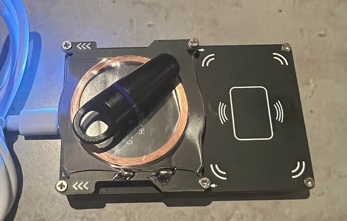

hitags are notoriously difficult to successfully couple with, don’t worry it’s probably only soft bricked but you won’t get far with a proxmark3easy antenna. you may want to wind your own
i use the rdv4.01 and proxLF to write to bullet fobs and the 4.01’s default flipped out LF antenna to write to cards

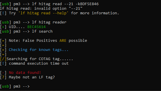

Complete newbie here so apologies in advance if I’m asking dumb questions.
I am trying to use the “lf hitag reader --21 -k BDF5E846” command but it says invalid option “–21”.
Does this mean I have a different type of paxton fob?
Apologies just not understanding the reference to “21”.
If I use the “lf hitag reader” it returns the UID of the fob.
Any help would be much appreacited :slight_smile:

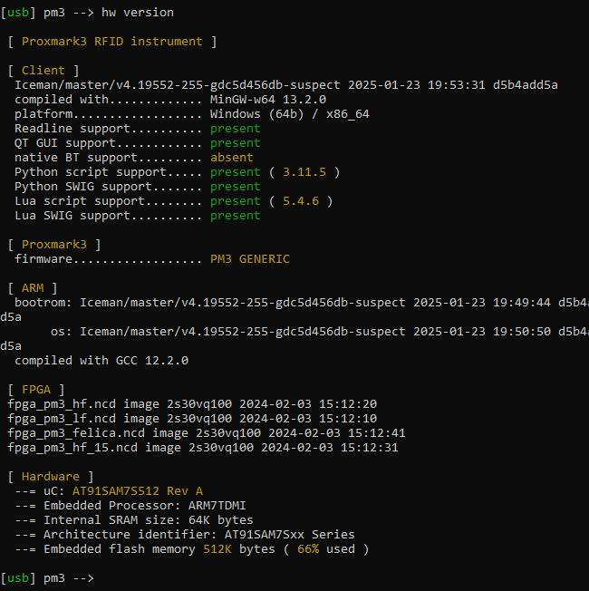

Post some screenshots… if it’s saying invalid option then likely it’s a syntax issue with the command.
What version of firmware and client are you using?
I’m actually not sure it’s able to read the fob.
lf hitag reader returns UID
lf search returns ‘No data found!’
Not sure re firmware but does this screenshot help?
Thanks for your help!
this is old command structure.
if you want to do the read command it’s
lf hitag read -2 -k BDF5E846
if you wanna dump it it’s just
lf hitag dump -k BDF5E846
ofc this only applies to paxton as that’s the paxton password (which you have)
you have a pm3 easy so i would recommend moving the chip closer so its half hanging off the antenna and placing a table spoon (yes a metal eating spoon) over it like a dome to help coupling.
edit to add:

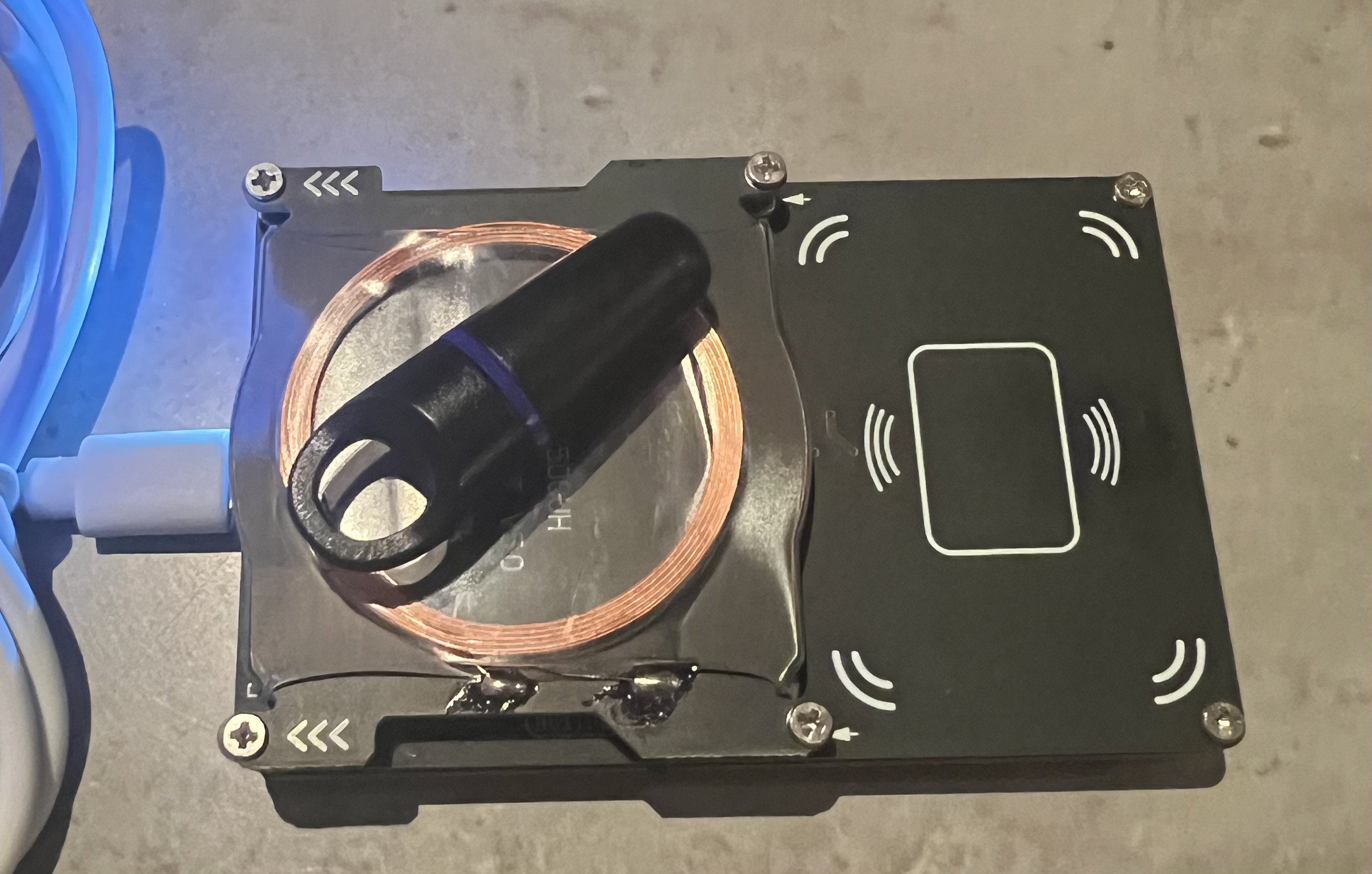

uhhhhhhhhhh your LF antenna is on backwards, you see the arrows on the middle board pointing at those two holes? now you see the two arrows on the lf antenna? they need to point at those same holes
take the antenna off rotate it (so the arrows point at each other) and continue.
Amazing this worked! Not sure if it was unscrewing and reversing the antenna or whether it was the spoon but I got the following result:
