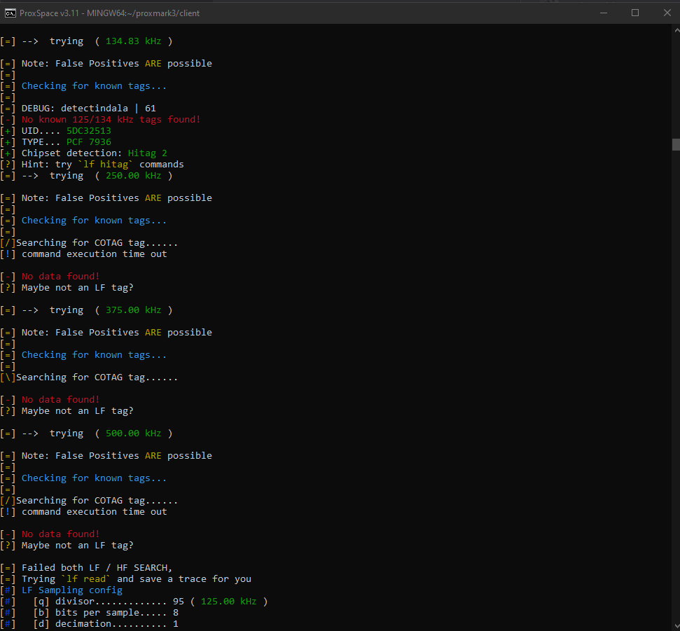

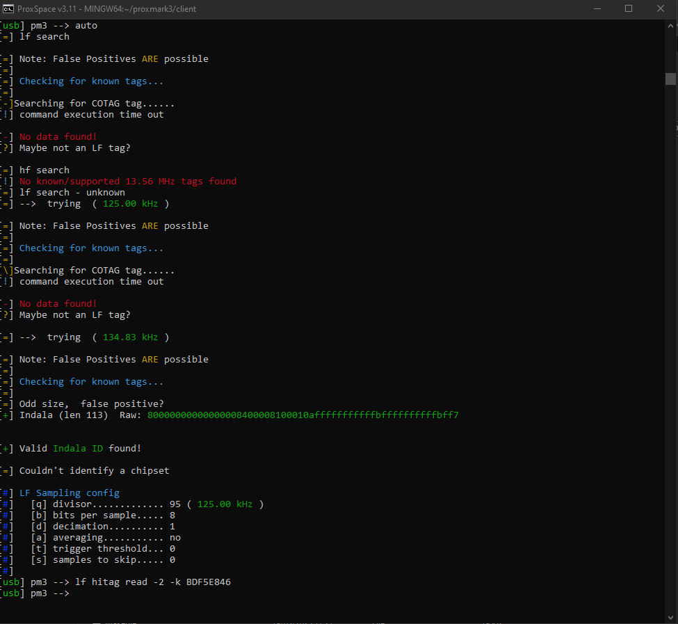

Looks like my proxmark3 easy is reading the paxton fob as shown in the image below. But when I use lf hitag read -2 -k BDF5E846 nothing happens.
Any advice or tips would be greatly appreciated :slight_smile:

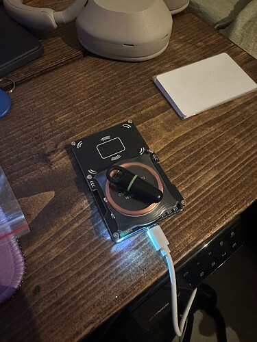

How are you presenting the fob to the proxmark? can you post a photo or video of your attempt?

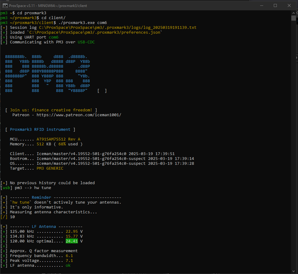

Also, what is the firmware / client version you are using (shows on first running the pm3 client)

The current setup looks like this:
I have attached the version here:
Ok the thing to note about Indala tags is that they have no CRC or parity checking at all, so if some random noise is close enough to an Indala ID signal, the proxmark3 will “detect” it as an Indala. How you can tell if it really is Indala and not random noise is to repeatedly read the tag… if the ID keeps changing, it’s just random noise being picked up and interpreted as an Indala tag.
In short, I think your coupling is a problem. The green ring indicates this is a “compact” fob so the antenna is probably very small inside there. You will likely have to hang the fob half-way off the LF antenna ring to properly couple. You can use lf tune to try to locate best position by watching for the largest voltage drop. Run the tune command and move the fob around until you see the largest voltage drop… then keep it there and run your command.
Thank you. I had a play around with the tuning and like you said the best place was having the fob hang off the antenna ring.

with it hanging half over the edge, put a spoon over the top, a spoon you’d eat cereal with.
the easy antenna isn’t a fan of bullet fobs, this sorts it.

Hi all, only got around to this today. But the spoon did the trick! Currently trying to clone the paxton fob to a T5577 which is another issue in itself…
