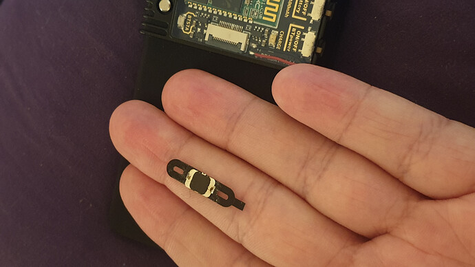

I have actually made a iClass implant antenna, not available yet but maybe soon, just finished testing the latest design and it works well? :eyes:
Prototype:
Looks cool ! Which chip did you use ?
Here is the product page for it https://dangerousthings.com/product/flexclass/
Soon to be back in stock…
