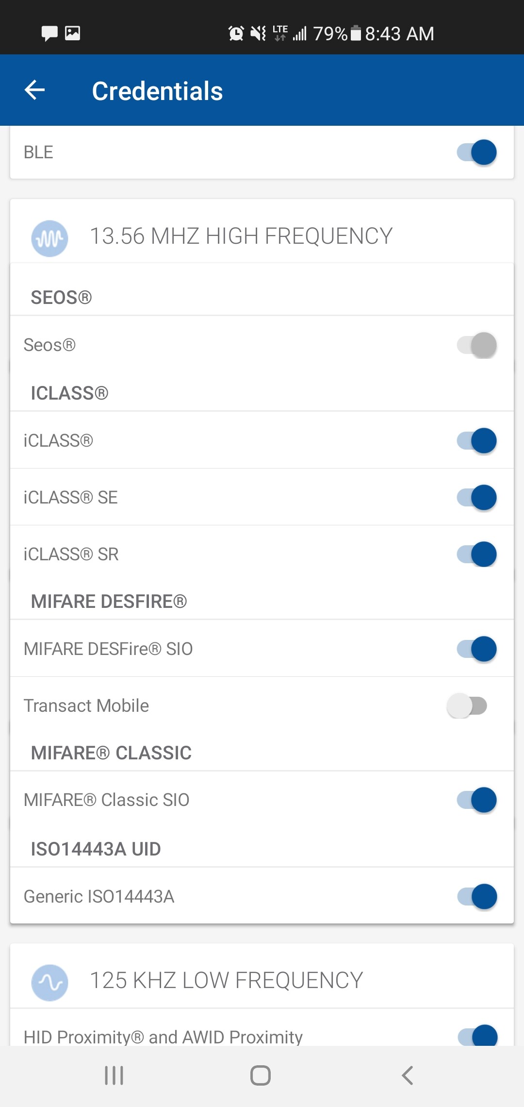

Here’s a screenshot that might sort of explain what’s going on here, does it look like it might be what’s happening for you?
On the top left we see the card dump, I’ve highlighted the part we’re interested in.
To the right of that we see the actual C1k35s format.
and under that some conversions to binary to show that everything matches up for me
I can confirm that this card scans correctly on an HID reader

Ah poop, I seem to have gone and goofed my test HID reader, it can’t read non-SIO mifare classic cards anymore.
That is to say, I don’t have a way to check the wiegand output anymore to keep troubleshooting :frowning:
At this point I am sort of leaning towards it being a reader config error on your side as well, but like I said I just can’t check it at the moment
If I can figure out how to reconfigure this thing I’ll get back to you
Attached image is the reader config. So it seems it is preferring to read the tag as generic ISO14443A UID as opposed to Mifare classic. As such, its reading the UID instead of block 5. So it seems then that I need to figure out how to encode the right data into the UID. No idea how to do this though.
hf mf csetuid wants 5 or 7 bytes, which is not what my data has. I tried appending a 0 to fill it out to 7 bytes, but the BCC0 check doesn’t pass anymore and the tag can’t be read by the HID reader. I wish it were as simple as disabling ISO14443A on the reader, but I’m not in a position to reconfigure our readers at work.
Have you tried it on one of your work readers yet, or just the one hooked up to your Arduino?
It’s possible they could be configured to accept non-SIO Mifare Classic credentials
Nope havent tried it at work yet, I’ve been off all these days. That screenshot was of the one at work actually. But mine is the same reader with the same config
