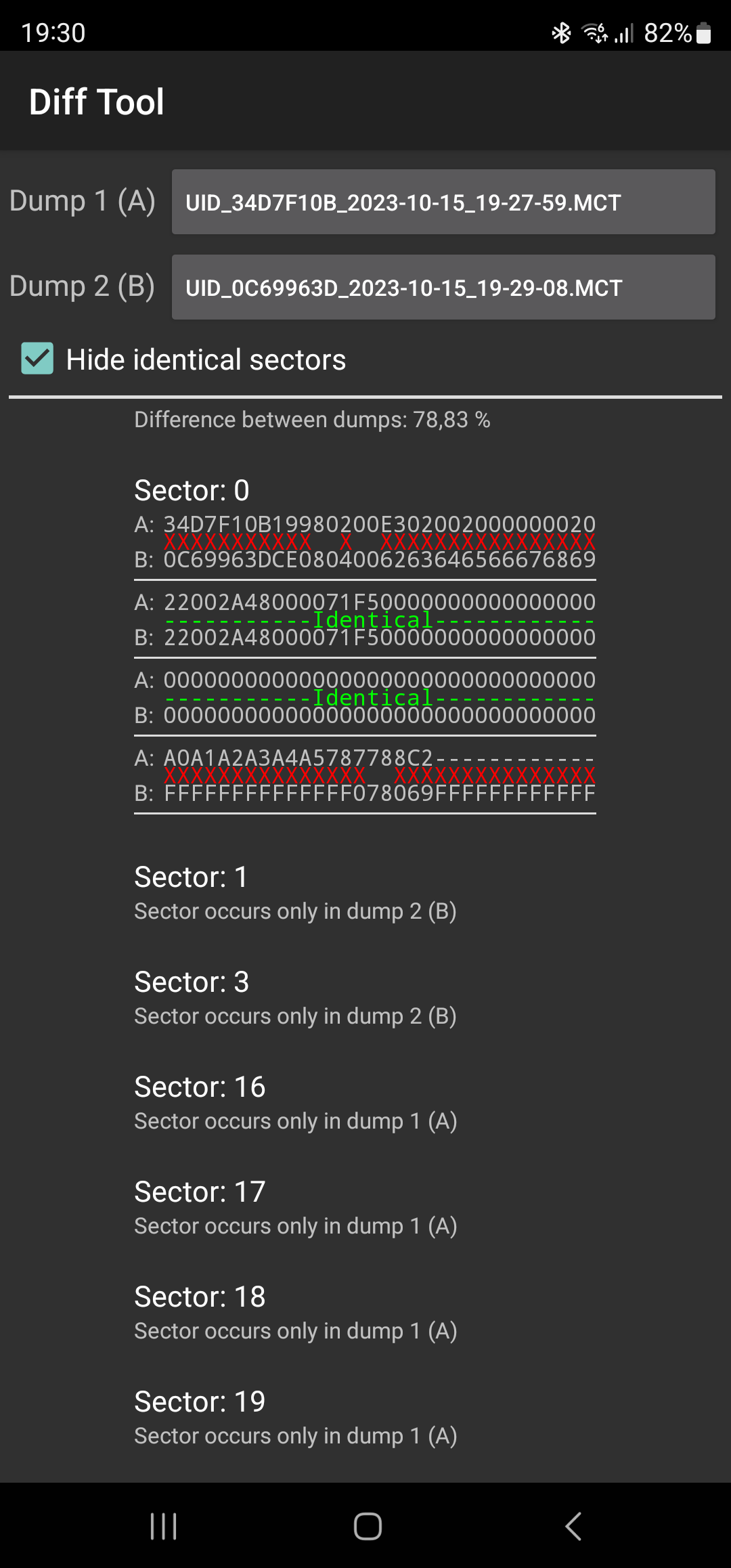

You are trying to squeese 4k of data into 1k
Best case scenario, The system reading it is only checking the (N)UID and possibly something within the first 1k. ( 15 Sectors )
I think the best tool to use is MCT
Read and save each dump
Then in “Tools” use the Diff Tool ( Compare dumps )
Tick the “Hide identical sectors” option
Share the results
everything after sector 4 or 5, is just factory. So i was thinking it might work after all, but this block 0 thing i cant figure out. Do MCT deal with the encrypted part too? Its got 3 or 4 keys encrypted. Thats why i used proxmark on it.
Yea, so this wouldn’t work I guess…
