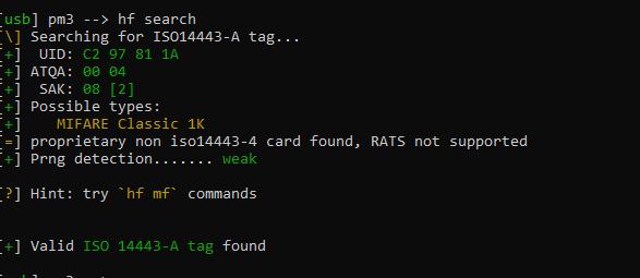

Hi, the company that deals with waste collection provides us with a card (credit card format) to open the various containers (plastic, paper, organic etc.) the card should be a mifare classic, I would like to clone it on a key fob because 'it’s more convenient, I have the PM3 easy with the Iceman firmware, but I don’t know where to start… who can help me? Thank you… ![]()
Do you have the PM3 client up and running?
You can check with hf search
Hello, thanks for replying, here’s the response,

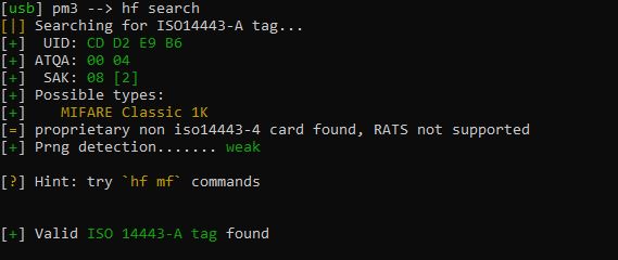

and here;s the response for the blank keyfob
They look similar / identical… (…) now? how to proceed? thanks
Do you know if the target fob is a magic tag?

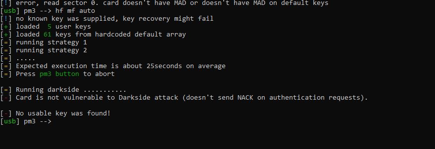

after 25 seconds eventually ii says
Card is not vulnerable to Darkside attack (doesn’t send NACK on authentication requests).
[-] No usable key was found!
Does it keep going after that?

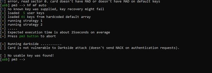

Can you post a picture of the ending of the output from hf mf auto
That’s interesting, I don’t think I’ve ever seen that particular error.
You could try repositioning the card on the PM3, trying to get better coupling, as well as making sure the PM3 isn’t over a conductive surface which could cause interference
