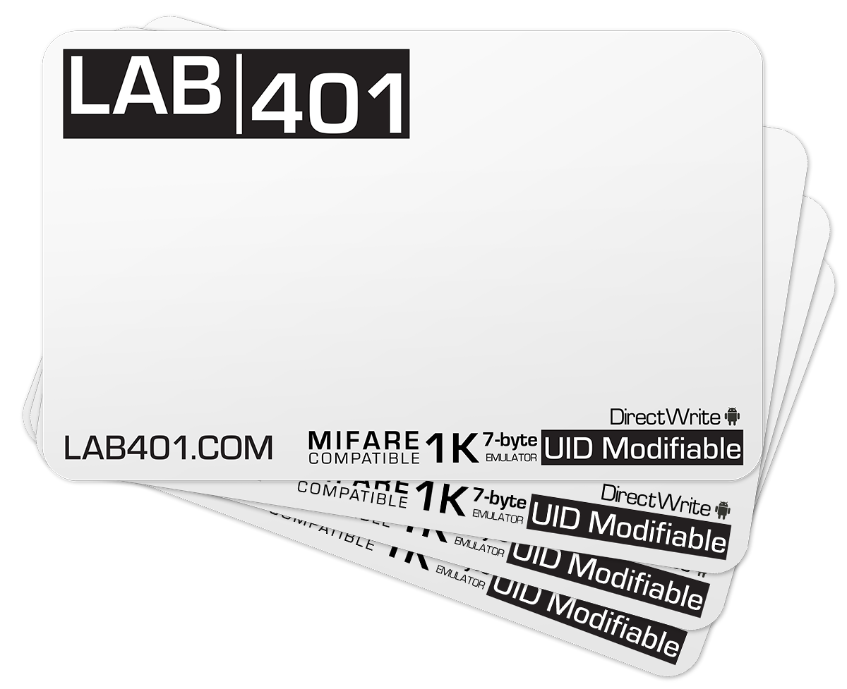

It’s entirely possible that the system is only authenticating with the chips based on UIDs, which would mean you could get away with using something like these cards:
and your phone to clone enough of the tag to spoof the system
