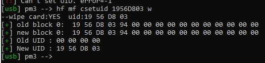

Trying to change the UID failed a bunch and then at one point it said it failed but the UID was actually changed, now I’m trying to set the UID back to what it was and I can’t even get it to do that.
I’ve now been able to both change the UID back to the original image
and the one I need it to be:

to me OP it seems like it snagged a miswrite and the coupling fell off halfway through, do hf mf cwipe and then try your hf mf csetuid 19566803 dont add the w on the end. that wipes the card and if you havent effectively written the ATQA and SAK it wont read as the card you want. it will pick up the fact a card is there but it wont be able to discern its a mifare classic. if you waanna hop over to the discord i can help you out some more

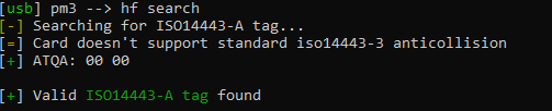

Yeah, I had to load a cached version of a proxmark.org thread and found the cwipe advice there, which HAS made it readable again but it all looks like this but still says it’s wiped at the end of it…
Now when I do hf search, it keeps getting hung up on this, even if the implant is nowhere near:

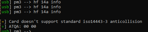

instead of doing hf search when you know you’re using 14a tags just use hf 14a info while hovering over the tag :}
Nada, it’s like it doesn’t know it’s a 14a chip.

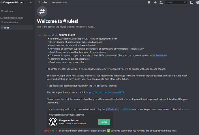

not to keep pushing it but would you be able to join the discord? much easier to debug there :sweat_smile:
Oh fur sure, I didn’t know there WAS a discord, I’m part of a slack server.
:slight_smile:
ill catch you when you land and we can go over fixin this in there
I think I’m missing something lol
what check mark?
in the #rules channel :slight_smile:
at the bottom of the message shopuld be a little tick

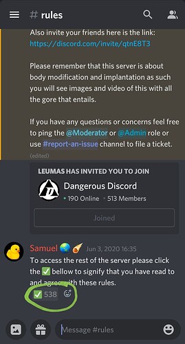

Yeah that’s where that text is from, I can’t see anything to press though.
“react to the emoticon”
