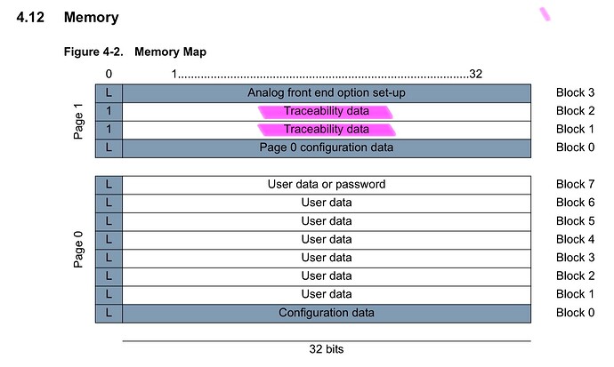

The github explanation says that some T55 clones can have that data changed, but in that case, the likelihood that a T55 clone has accurate data to begin with is low.
And this brings up the question of why that data would change if the “lf t55 wipe” command was run. Does that command include targeting the tracability data knowing that “real” T55’s can’t have that data changed?
And this brings me back to questioning why that would be important to have accurate data in an implant.
Amal, do we know for sure whether the T5577’s in the xEM (and other implants for that matter) are “real” (not that I really care, just curious).

It’d be the xEM and we are pretty sure they are legit t5577 but we did not source these our factory engineering staff did. Honestly if they are clones with writeable traceability data, I kind of think that’s better.
I would argue the same. Controlling exactly what data is in the chips inside us, and all of that.

This. It gives the manufacture date, lot no, wafer no, etc, of the chip. I’m sure it’s probably trivial, I just like keeping things as close to original as possible.
The “sibling” xEM is likely to give you something close to original. If the data was truly wiped on your xEM, it is gone unless you have a copy of it somewhere.
Others are welcome to correct me.
i can assure you it is trivial and unnecessary to keep, in some very limited circumstances, you need to overwrite traceability data in order to produce a functioning credential (usually for encoders with enrolling not readers themselves)
After doing some digging I realized just how trivial it really is, I’m not worried about it anymore. He has been using a Flipper Zero to program his, which overwrote his original traceability data with that of his work fob, and I have since done the same with mine as well.
