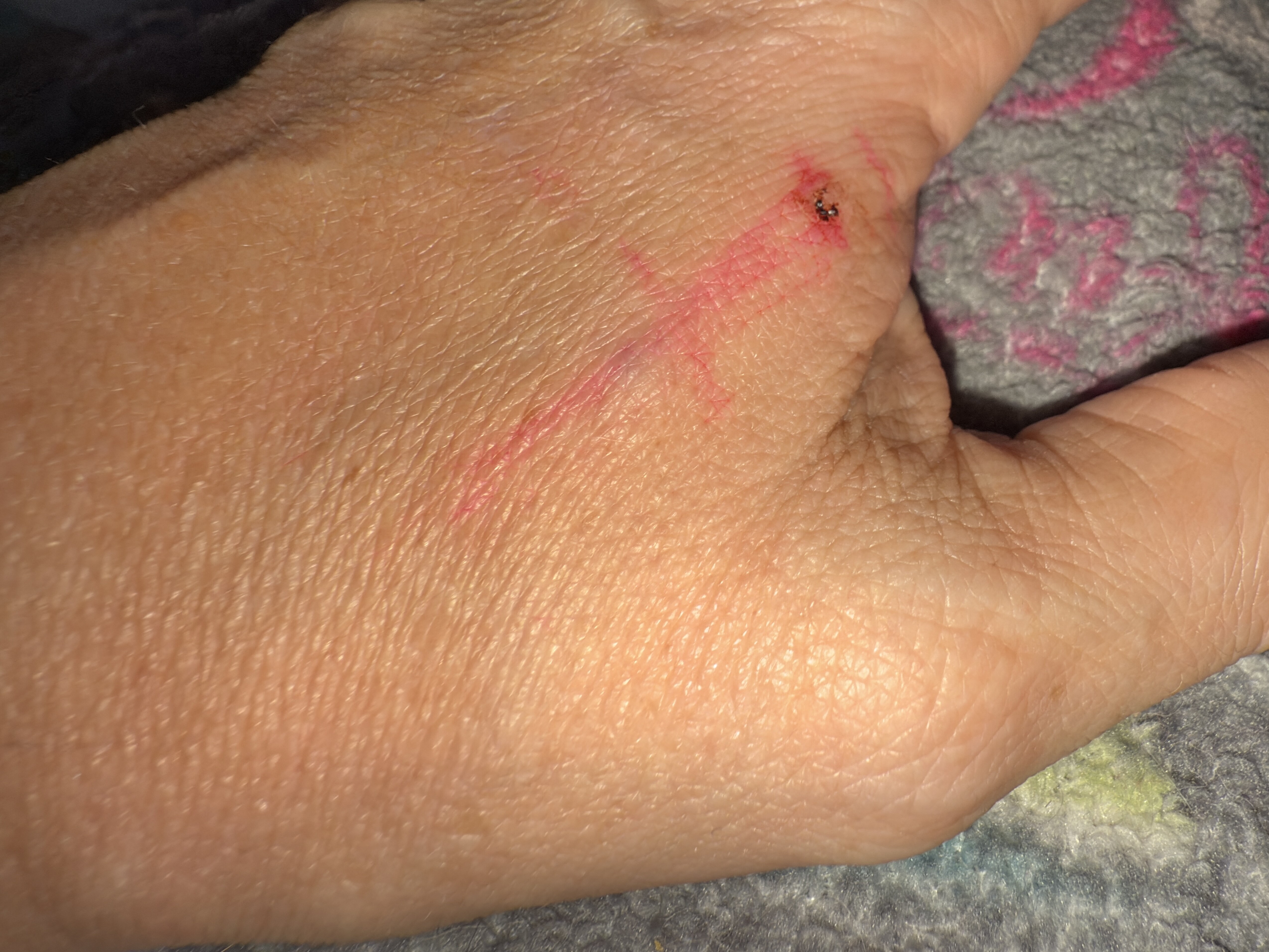

Did you want to share a picture for some opinions?
She did pull up, or ā€œtentā€ the skin, while injecting it, but thought she might have stayed too shallow because you can see the deep end of the chip through my skin. Then again that might just be because I have very little body fat and there’s not much there to hide it, idk. I’ll share a couple pics in a min.

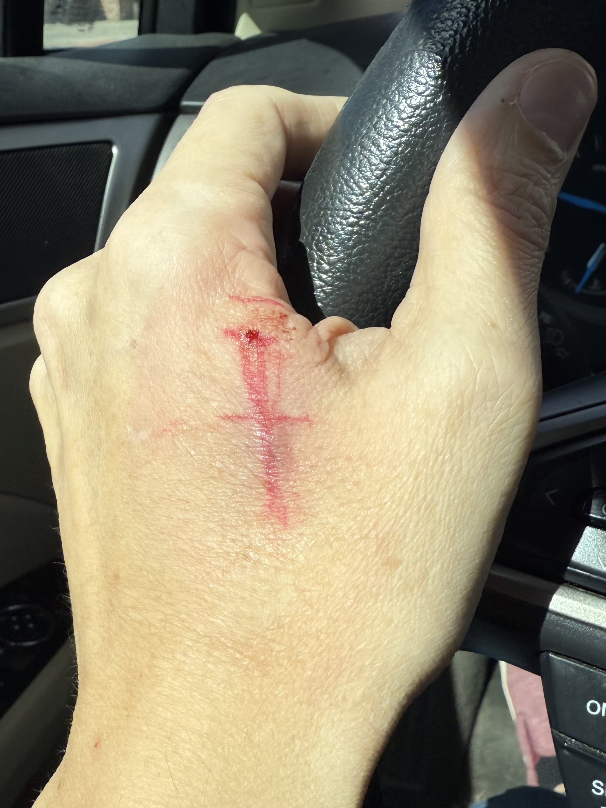

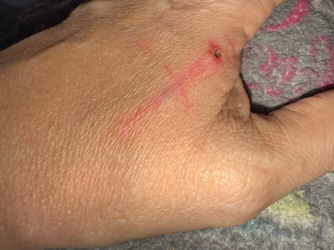

Sure! The third pic probably best shows how visible the deep end of the chip is through my skin
This was taken in the car about 30 minutes afterwards.

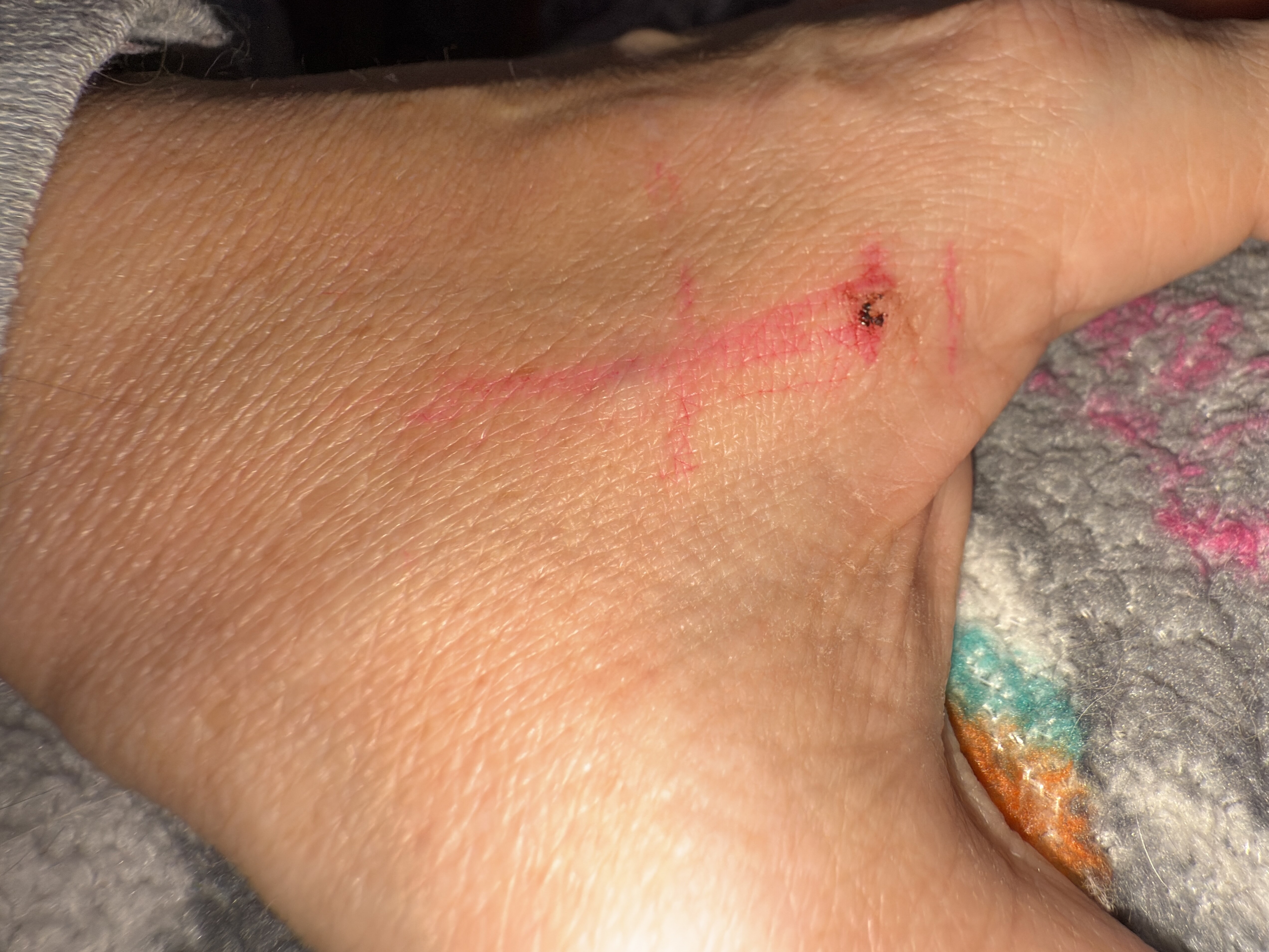

These were taken the following day.

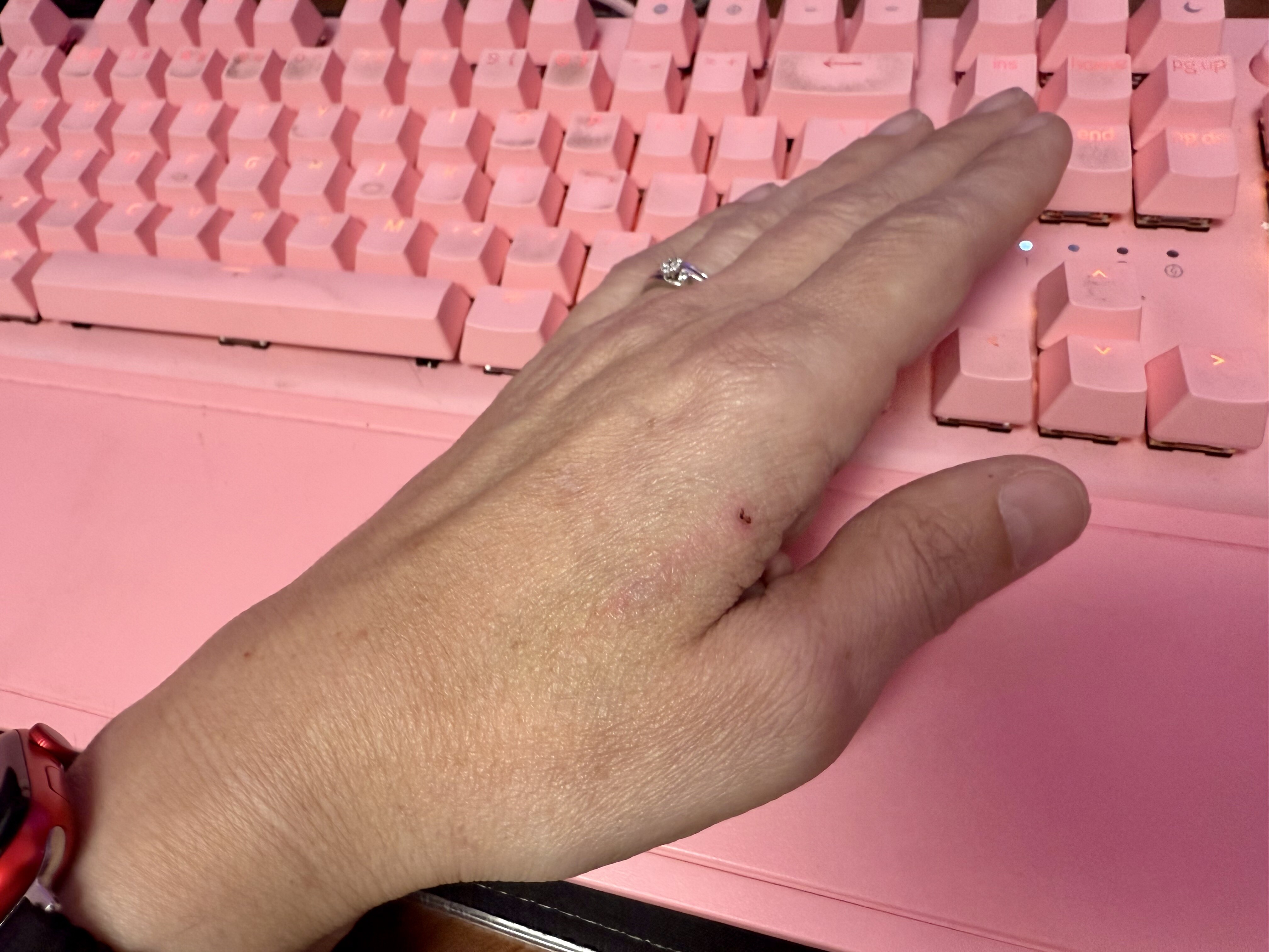

And this was taken the day after that, on Monday.
This looks ok to me but hard to tell for sure without seeing in person.
