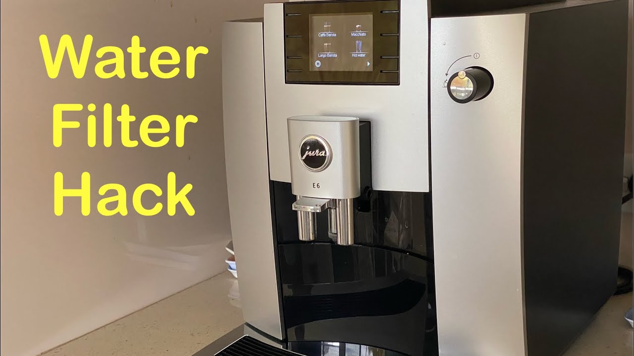

Here’s a bipass using a bit of foil lined cardboard. May be a bit more advantageous. Compared to the rfid bipass route.
Sure. When the new filter is added the uid is logged. But what dictates when it’s full. Maybe numbers of cups poured. There’s no sensor in the filter…
Thats not bypass, it just people dont know that u can disable filter and run without it but twist is.. It will ask descale which tablets cost alot tho.
Because my machine got 2 options:
Run with filter
Run without it (but every couple months it will prompt me descale it)
Red line is where ring chip around there
My whole goal is make old filter act like its new
I thinking might even try copy new data of new filter and apply it on older filter and maybe even change serial number if it would be possible
How does it know that you descaled it? Do you have scan the tablets. Or can you just skip it and tell the machine you descaled it. There should be no scale to descaled if the filter is in and not logged as present.

System works based on water hardness (number you set up) and based how much Litters of water you used. So machine follows it and it prompts once you reach that numbers
It likely resets when you run the descale cycle. Although it might be possible to run it without the tablets.
Yes that too. If you ran that clean program, system it resets till next time prompts it
Pretty annoying like 50min cleaning program and bit messy and ofc with filter u just swap it and dont need descale it. But buying filters it getting annoying while me using clean filtered water
can water hardness be set to zero? no prompt to descale?
to reiterate, put a filter in and say no filter,
water harness set to 0. no descale prompt
there a cloned filters available for significantly cheaper,

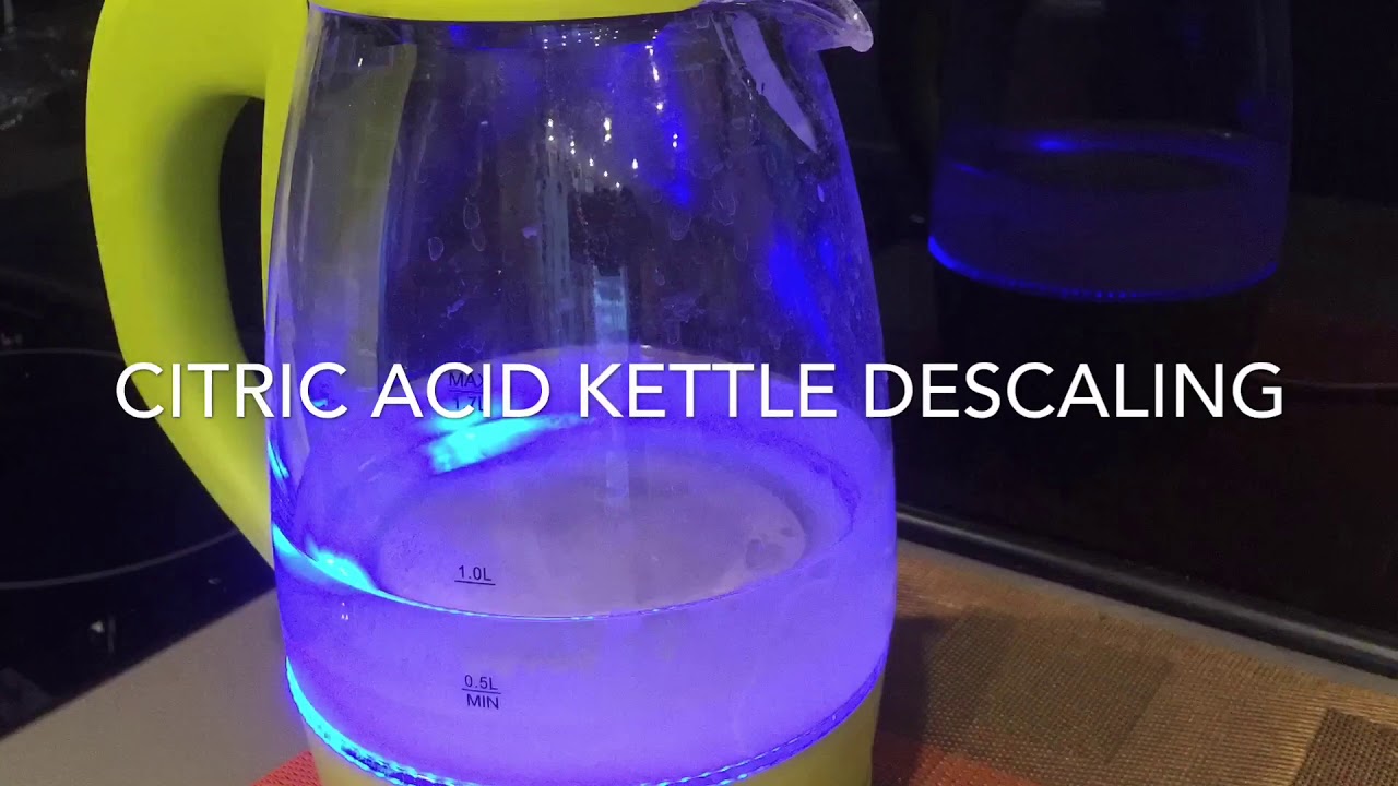

Derailment aside, descaling the machine from time to time is a good idea.
citric acid works great on scale.

You could try unplugging the antenna, it MIGHT error out, or it MIGHT work.
Worth a try? :man_shrugging:
The fact that there are clones that work, means there is a good CHANCE you can make clones using just cheap compatiablechip and antennas and just pop those in
with clones are lottery.. I try mess around with original ones
Alright guys.. i recieved my parcel. today will try set up on my pc and explore what i find it
