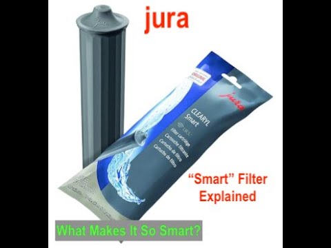

I got coffee maker and it uses Smart filter with rfid chip. After some long time use filter get expired and machine asks to replace new one (Why do i need replace them if i use filtered water)
I know that filter RFID data gets written and its impossible trick machine with used filter.
Its possible rewrite RFID data and trick machine its like new filter inside machine ? Some says its possible. Any help or tips would be nice
By the way phone reads that RFID data but cant do much without seeing what is inside
And filter i am using is Jura 72819 Claris Pro Smart Water Filter
