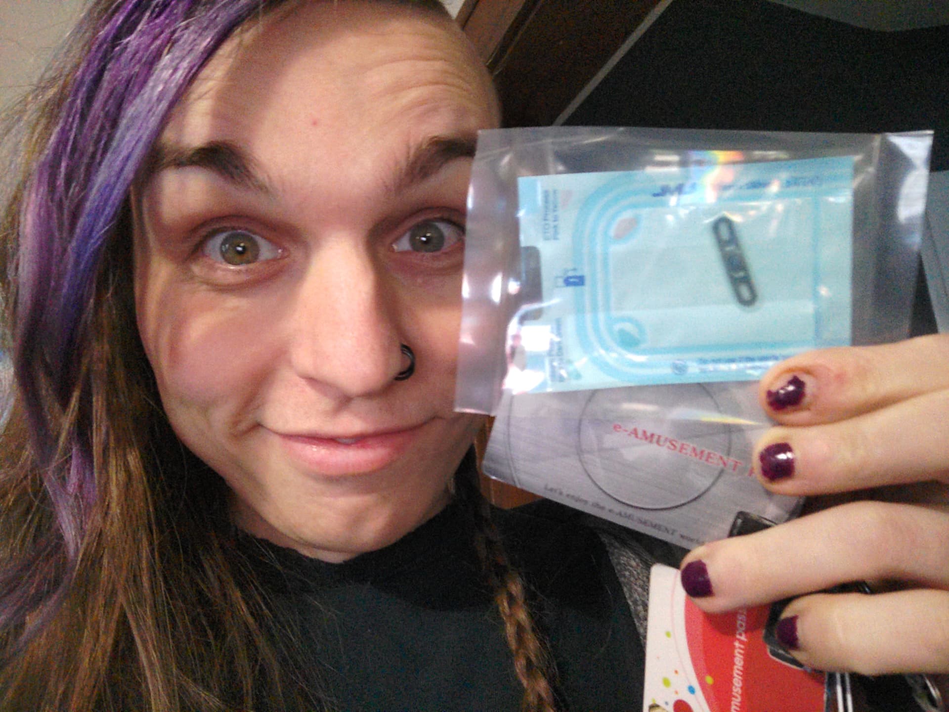

These are migrating to FeliCa/NFC-F (right), but older ISO15/NFC-V cards (left) are still supported. NFC-F being arcane magick, I sought an implantable NFC-V solution.
The DT xSLX is the right spec, but Konami’s servers have a UID whitelist—while an xSLX would work on third-party networks, it wouldn’t be guaranteed for official network login. Thus, I needed to find a magic chip…
I made several purchases of pieces to test; Amal was very helpful in describing the issues with each candidate piece I inquired about. Eventually I found this listing (the CoB variant).

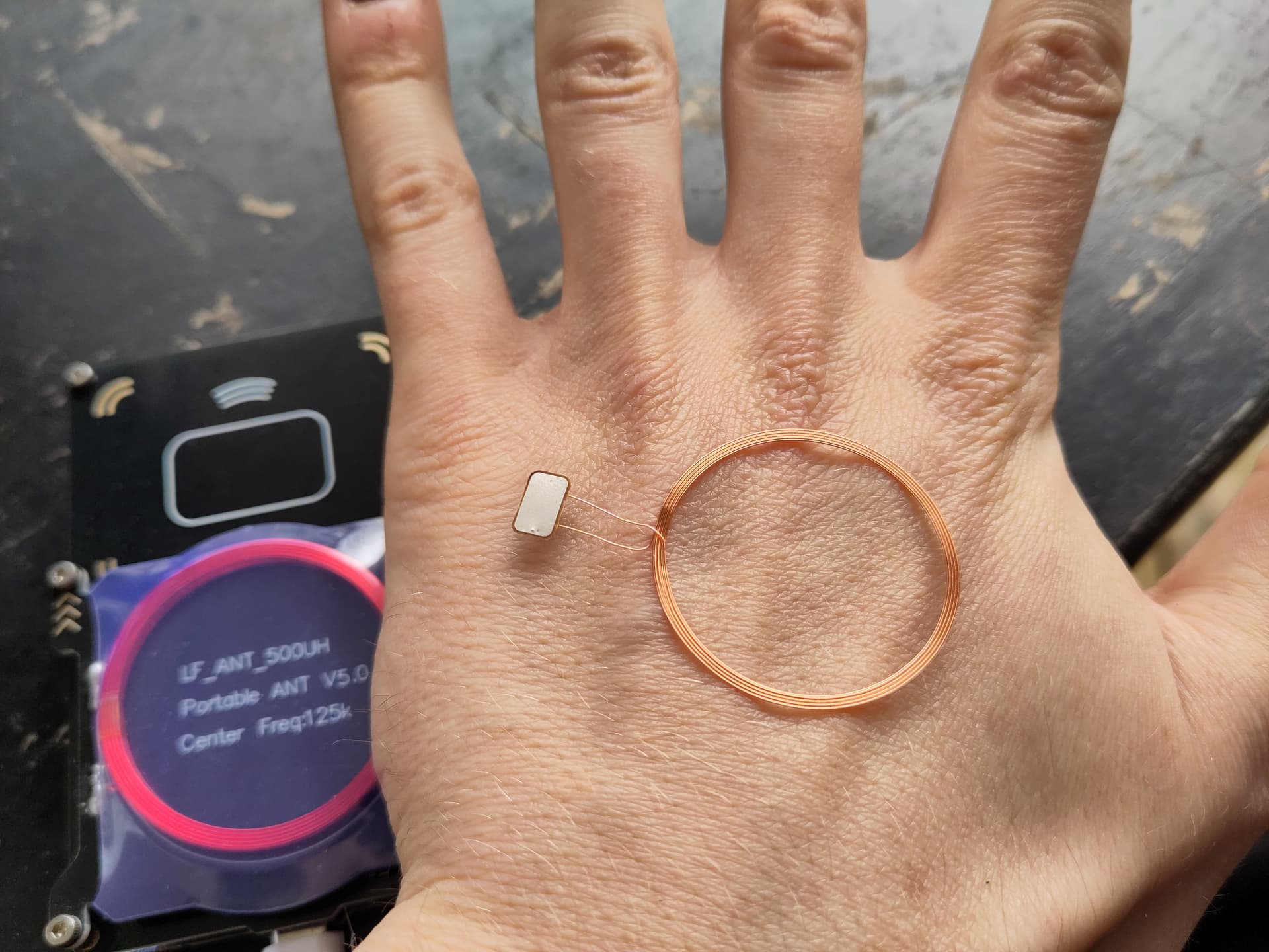

CoB has its issues, but proved workable. Amal was able to adapt the chip onto an antenna, and after I confirmed the samples had sufficient performance for my use case, I was able to get one implantable…

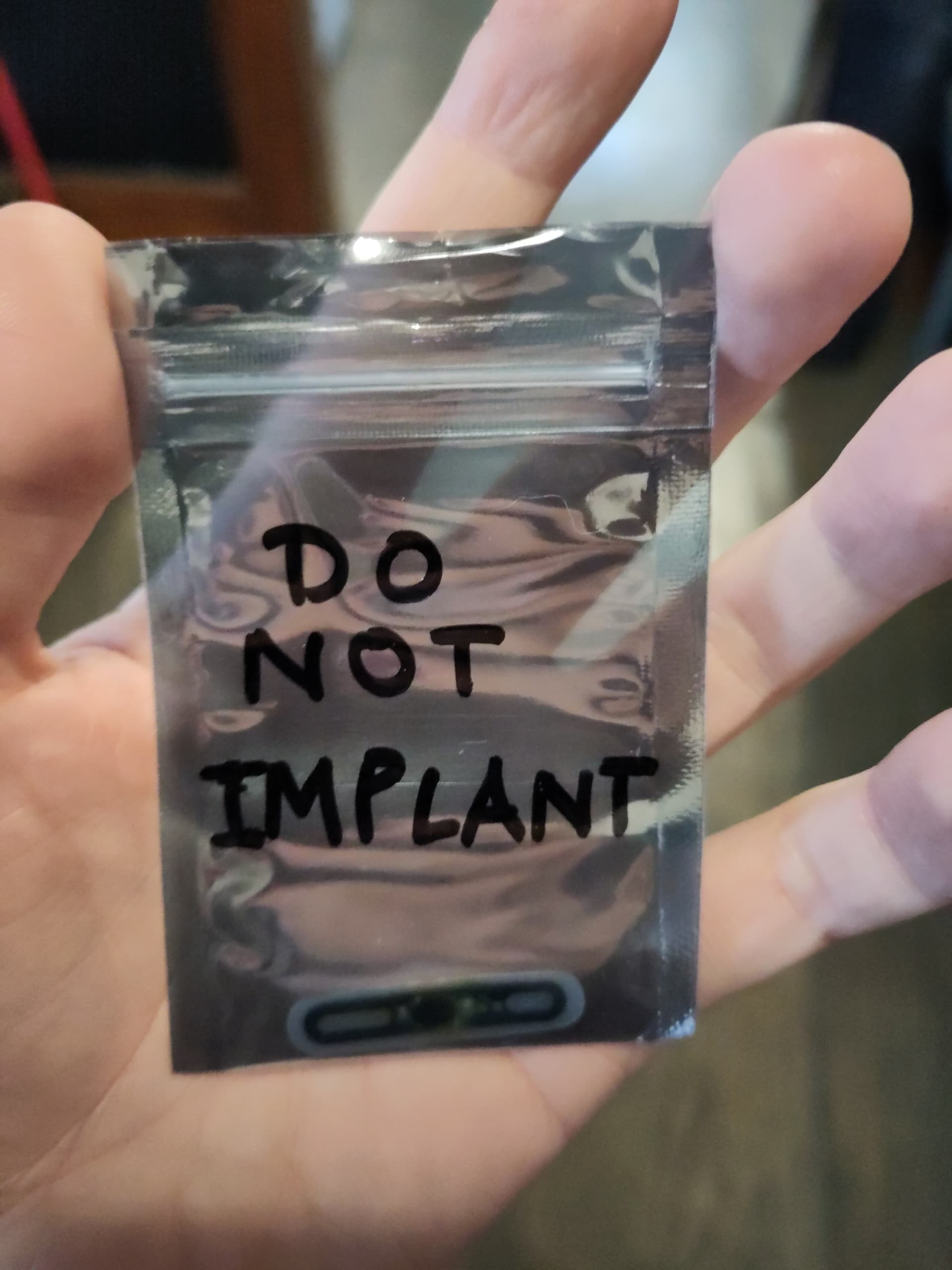

Though the spare didn’t survive… :cry:
…two were made, and the other did! One install later… it works!
