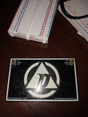

Does the diagnostic card (black card in your next box) glow when you hold it to the reader (what color)?

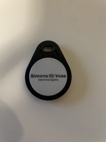

Maybe send some pics of fob and reader so some people who have seen them can help.

I didn’t get any diagnostic cards with my tag. Is that something I should have gotten?
I’ve added a picture of it here
This is the card you should of gotten.
Hm. I had to pay extra for that. I bought it from Digiwell as I’m in Europe and that would be cheapest then.
Should I order one?
You don’t necessarily have to. But it does help identifying whether whatever device is reading the tag is LF or HF.
Might have to buy one at some point then.
But I found the tag. It’s this one:
And according to this it’s operating at 13.56MHz, which would explain why I can’t copy it with the copyer
Your phone should read it though.
It won’t tho. I’ll just throw together an arduino and an rfid-rc522 to try
Oh you know what, that keytag has a desfire chip, that may be something.
Search the forum for NeXT and DESFire. Your chances of cloning that tag appear grim though from what I’ve read.
I will. Thanks. Keeping my hopes up

it only reads 13.56MHz. and reads it as a PICC type: MIFARE 1KB
Try the Mifare Classic Tool app to read the tag.
If that works you can get a flexM1
