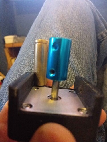

another update, i managed to find some pre existing couplers for a 3d printer. its a 5mm to 8mm inner diameter with grub screws which is perfect. however they are 14mm wide and i need 12.5mm, so im hoping i can just spin it on a drill and file it down.(EDIT : found someone locally with lathe) i managed to get 5 from ali for about 5gbp

Couplers came today. Looks like they will be a good fit after modification.
