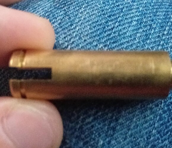

little update, theres one part to source, that is the coupler that joins the motor to the lock barrel,
heres the one i removed from the barrel( minus the thumb turn), it needs to look identicle to this but with a 5mm hole in the plugged end with grubscrew, previously i have just 3d printed it. but im trying to go all metal for fire contingency (melty locks dont turn). befor i start harassing china, does anyone have a lathe?
