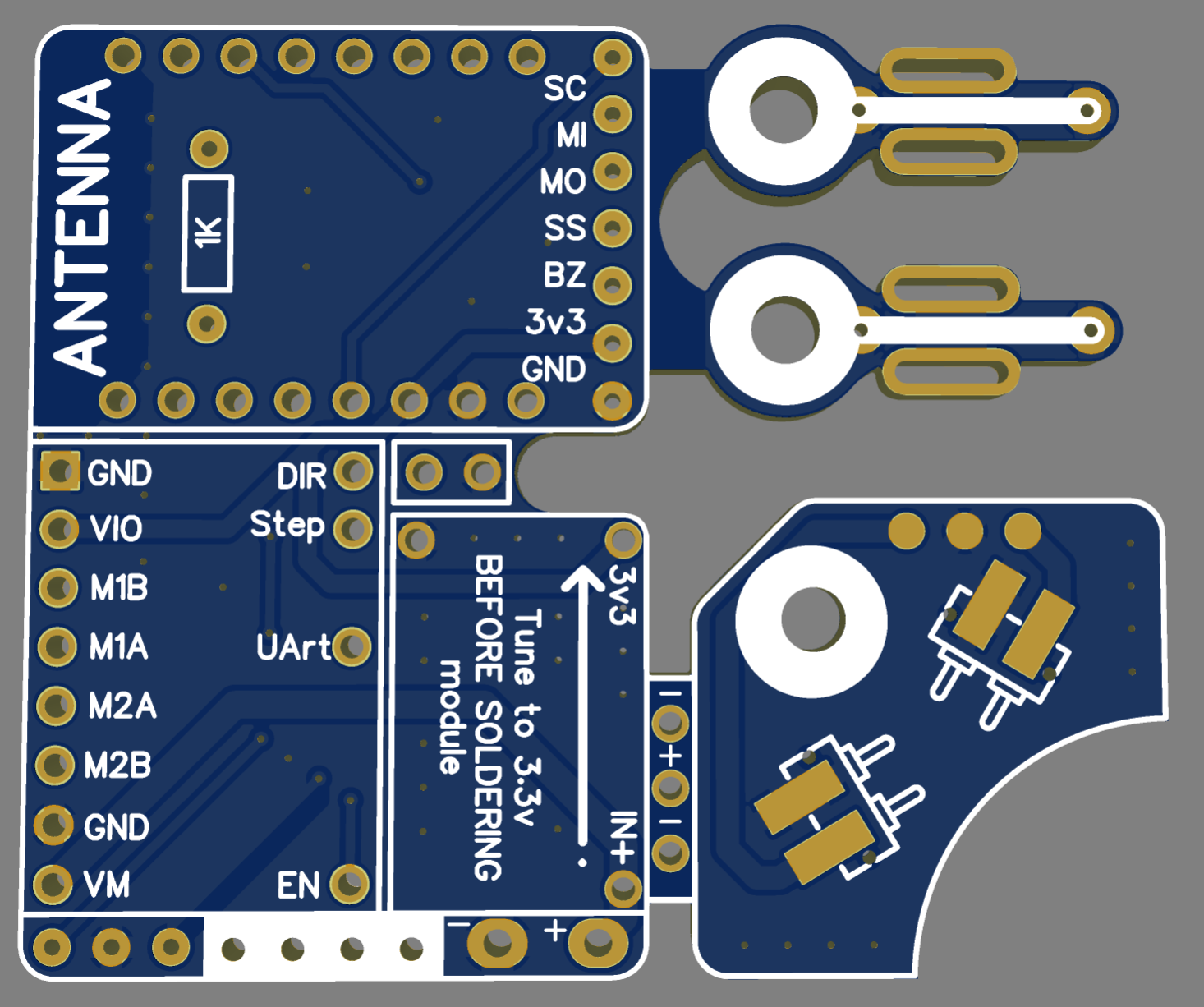

The faulty Pcbs came today. Apart from not working. It fits all the modules and componens great. Will amend and reorder…
if instead of Mousebites you added Vscores will they still consider it seperate designs?
yeh… ive even tried being sneeky and putting traces through mouse bites,strategically placed via, blatant holes labled mounting screws .im suprised the dont flag the 4mm wide tht pad, thats just so i can snip it off and get free side plating coz thats also extra, spent hours arguing with jlcpcb to get that . this is my 48th pcb… just print the dam thing, they offer 100mm x 100mm, im using a quarter of that… i guess i need to time it right so i catch friday afternoon in china, to take advantage of the ''fuck it ,that will do, its friday ‘’ mentality,

The git hub 's code and wiring diagram has been updated - GitHub - chiplocks/Sexylock: Stepper motor driver with NFC and WIFI
… and yes… i put our “logo” on the pcb…
