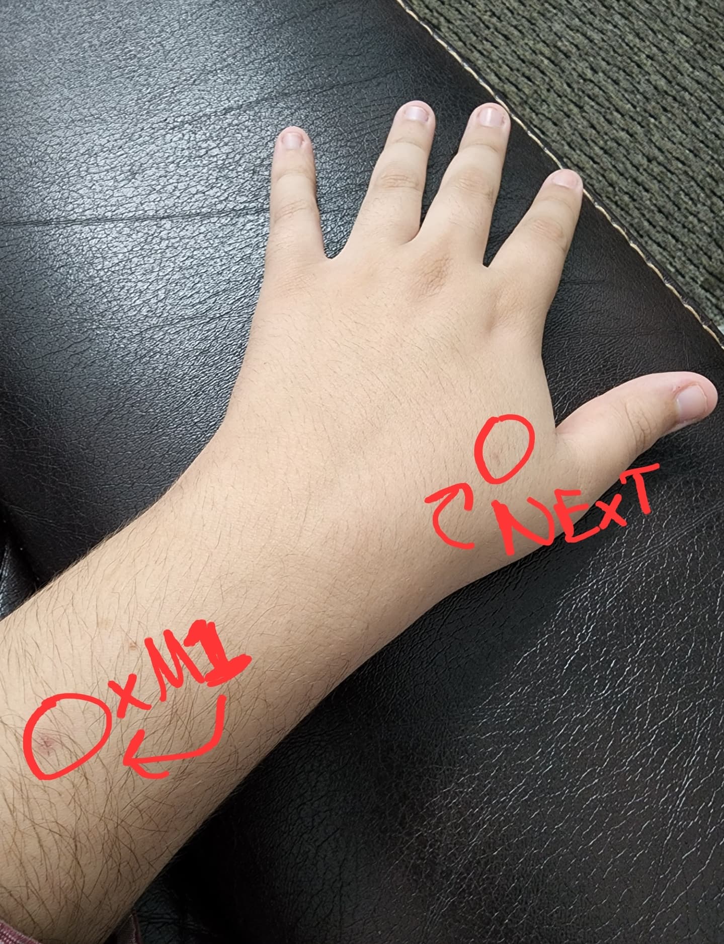

All that to say, if you would like a hand to play “Implant Tetris” ( Thanks for that term Eriequiet ) share an image with your current implants and locations and we can all play a game of

your whole left hand is viable #1 - #4/5
Don’t worry about the proximity of your NExT to the APEX flex in position #1, because they will be at right angles to each other when presented to a reader.
I have xM1 and xEM in #L0 and my Apex Flex in #L1 NExT in #R0 and my FlexM1 in #R1
I have zero issues with targetted reading
Plus on top of those real world experiences / examples, I have done tests in the past with my NExT in #R0 and I was going to put a FlexMT on the back of my #R hand.
I had no issues with that either ( I didn’t put the FlexMT in, because I thought it was too big for my little girly hands, although it was tempting, because the read range was amazing )
If you go for the MEGA, your whole Left hand would be viable ( and the MEGA, is much smaller than the FlexMT I was looking at )
RIGHT
Ignore the xSLX for the same reasons as above, you should have no issues there
I would look at #R1 easily, R2 probably and (maybe R3, but you would really want to test that)
The xG3 is a bit of an obstacle, and if you are not super happy with it there, that would be a good reason / opportunity to relocate it. ( I have personally removed 3 xSeries, all without issue and I relocated 2 of them with no issue)
If you want to leave the xG3 there, and because your xSLX is in a “less than usual” location, you probably only have one viable location for the MEGA on your Right hand

Sunday is the day! Getting the Apex Flex put in. Due to my FlexClass failing, I wasn’t sure if that was due to placement or not, I think I want to avoid the hand for the Apex Flex.
I removed my xM1 from my left arm, and I’m thinking of placing the Apex Flex there. Do you guys think that will be a good spot?

Just above the wrist, in the opposite of your dominant / phone hand.
Approximately where a watch WOULD go, so long as you dont actually wear a watch.
therefore easy to tap your phone to.
mid-forearm is another option.
I have one in each of mine and easy to read with a phone.
however, i would say in my experience, the thinner the skin the better/easier for reads, and neither of those positions are as thin as the back of the hand, so you may want to consider a hamspiced resonant repeater hust to make your life and Apex experience even better.

Yup, that’s what I’m thinking, on my left wrist. Where my xM1 was.
