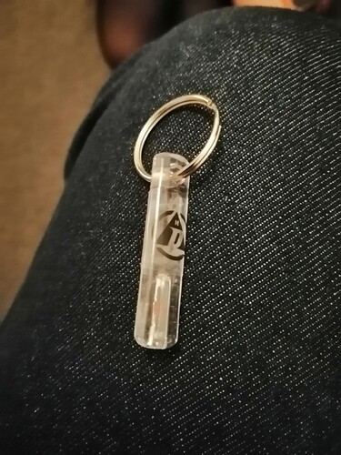

Tested with my NFC on phone it flashes on off not a steady beam of light also I have to hold phone direct on it meaning once implanted you Wouldent see it surley
Bought this to see if I get better or stronger result hope this helps as if not I won’t be going threw with the instalation.

That’s fairly common with some phones, particularly IPhone,
You’ll usually see a stronger/brighter pulse at the beginning then weaker blips
Depends on phone, and position, but it can be seen
Wrong clip, gimme a second to find an example
That’s because there is no chip in the field detector keychain. Because there’s no chip for the phone to read, the flashing is simply because the phone doesn’t want to spend a bunch of energy and battery power on looking for tags at 100% duty cycle. Instead it pulses the field on and off to look for tags only momentarily and occasionally it does a high power pulse, again to check for any tags on the field.
