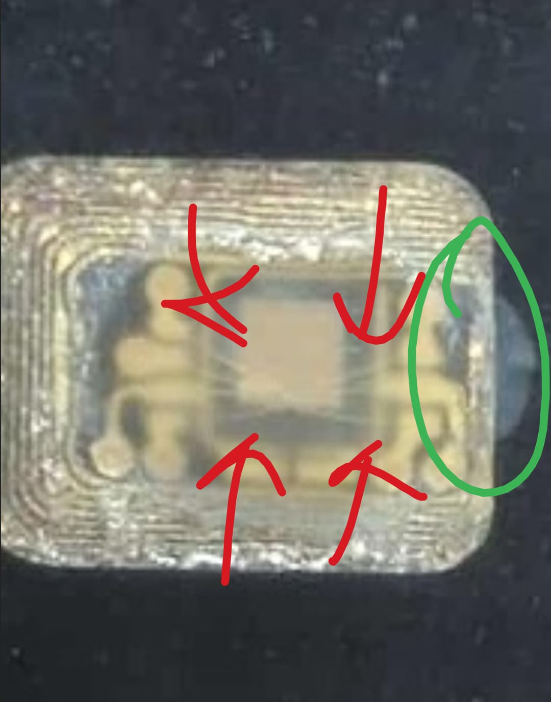

Its been a couple months but I have an update!!
So earlier today i had a few chips swapped out (a UG4 and my conversion). After ensuring all of the blood was off of the old conversion chip, it definitely looks like some blood started to seep into the biopolymer. I dont see any little hairs that wouldve acted like a wick and there doesnt look to be any blood on the edge of the implant itself. So Im sticking to my theory of smacking of smacking my hand on something and possibly pushing the chip forward to the point of cracking the biopolymer.
I’ll definitely take a look at it. There’s one possibility that makes it look like the blood is under the polymer which is that the polymer can kind of form ruffles over areas of unevenness. Without a stereoscopic microscope it would be very hard to tell the difference. I’ve even tried to clean some of these ruffles using isopropyl alcohol and a toothbrush and still some remains deep in these little micro crevices.
I’d be happy to take a look at it though because if it did get under the polymer then I really want to figure out how.
I can also say that it’s not really possible to “crack” the biopolymer. It’s extremely “stretchy” and resilient to the various mechanical forces like torsion, shear, bending, compression, and tension. Often it’s this flexibility that allows forces to act on the electronics inside and damage them.
The area circled in green indicates the spot where the polymer decoupled from the surface of the CoM resin glue.which covers the silicon chip inside. That would indicate some force may have impacted the module.
The red arrows point to the very fragile wire bond connections that lead from the silicon chip to the pads, two of which connect to the antenna on the module. If those wire bonds were broken, the module was no longer work as a contactless device.
i can send it in, its a dead chip so at most i would use it a souvenir or to show off to people But id much prefer it be used to research and learning. Ill get it sent out as soon as i can.
We can send it back after evaluation
The top contacts definitely look corroded. Is that due to exposure to the uncured biopolymer or from possible blood intrusion?
