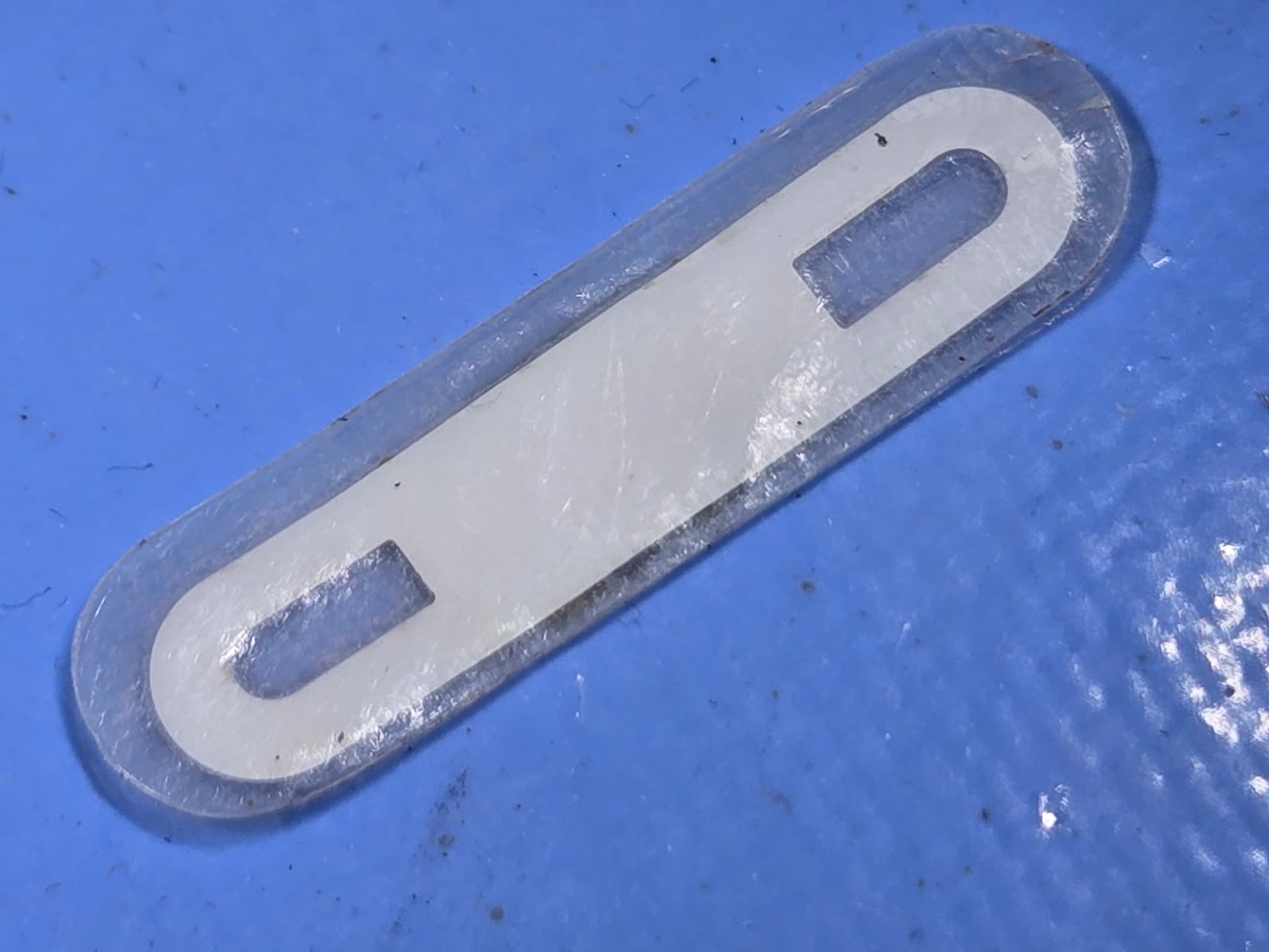

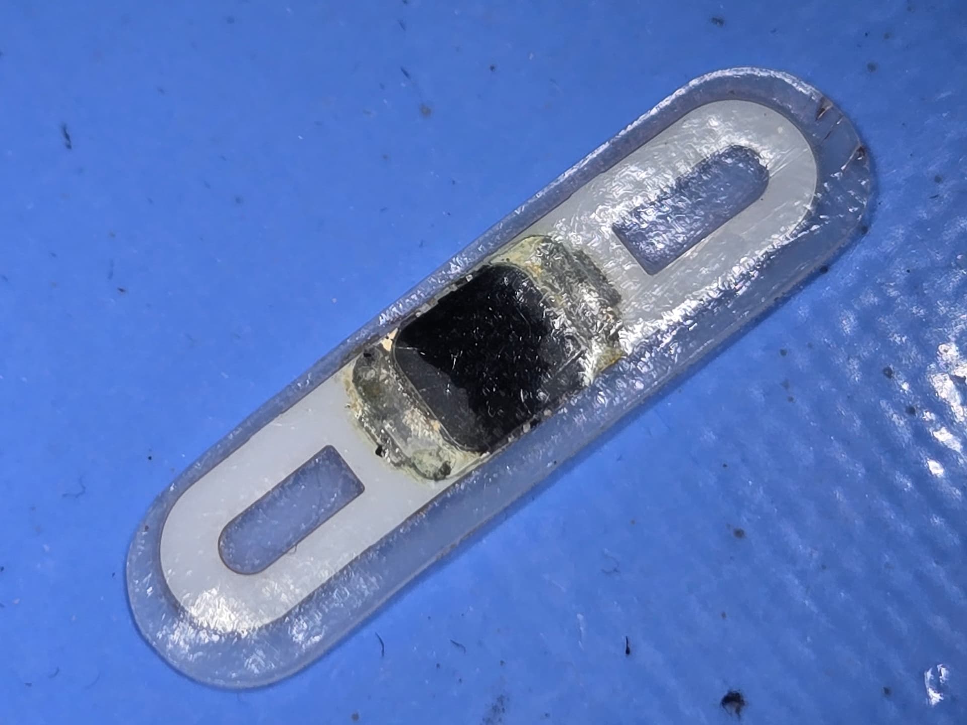

Hey, just thought I might chime in. I had a Walletmor fail on me due to moisture infiltration and mine also slowly, over multiple years, started to be harder to read on some readers while others were fine. Mine was installed in the knife edge before that location was known as a no-go. I experienced joint pain and muscle aches/stiffness due to increased systemic inflamation, which was confirmed via a blood test where my CRP levels were elevated. I was also tested for trace metals contained in solder and PCBs, these tests were negative however. The implant stopped working about 2-3 days after removal, but was somewhat functional until then. Here are some pics that I haven’t shared yet. (This was about 2 months ago and I haven’t come around to making a full write-up yet.)

Also, I’d expect the performance degradation to be caused at first by the resistance of the fluids that make it into the implant. Circuits that are exposed to moisture while powered tend to suffer from galvanic corrosion but unpowered electronics don’t corrode as fast, especially if the solder mask is in good shape. Although moisture and oxygen can make it past this layer and corrode the copper traces but this is rare.

yes if it’s due to a fiber… to be totally fair, very early encapsulation processes had serious issues which would allow some flex to kind of “split”, opening quite the hole… though this has not been a problem for many years now (since ~2018ish).
It has more to do with the “salt water” that makes up most of your body fluids acting to change the antenna tuning and performance… if anything resistance goes down as it starts to form shunts across antenna traces as it infiltrates.
Yeah, there’s also a capacitive component to filling an implant with salt water…

It started about 1 year ago. I had the implant installed for about 4-5 years at that point I believe. To be fair, I have an autoimmune disease and my body reacts quite aggressively to inflammation changes, not everyone would get such symptoms. However, I would still think that inflammation would probably be higher than usual, even without symptoms. This can be measured with a CRP blood test, if you are willing to get some blood drawn. However, a normal CRP value does not have to mean that it is not failing. Hope I could help somewhat ^^
