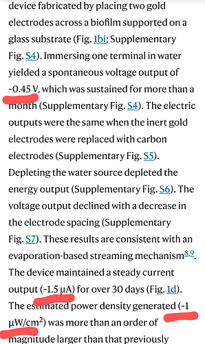

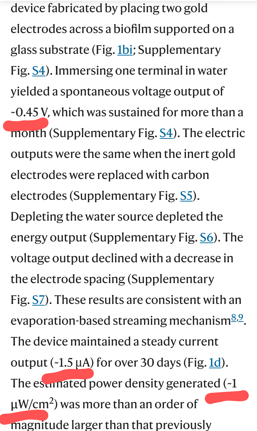

The most important question with these types of articles is how much power is actually being created. Researchers rarely invent a new mechanism of action, they just do it in a novel way. The hydrovoltaic effect is an understood phenomena with pros and cons. Here’s the relevant electrical specs.
So this can generate 1uW/cm². For comparison the Widetronix betavoltaics can generate 3uW/cm² and that glucose fuel cell we talked about recently can generate 48uW/cm². A photovoltaic cell could hypothetically provide 150mW/cm². Honestly it kind of surprised they got the LED display to power up. They did use a large surface area in direct contact with water and lasered the surface into 6 series segments to get the necessary voltage though.
