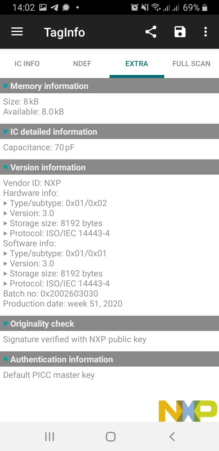

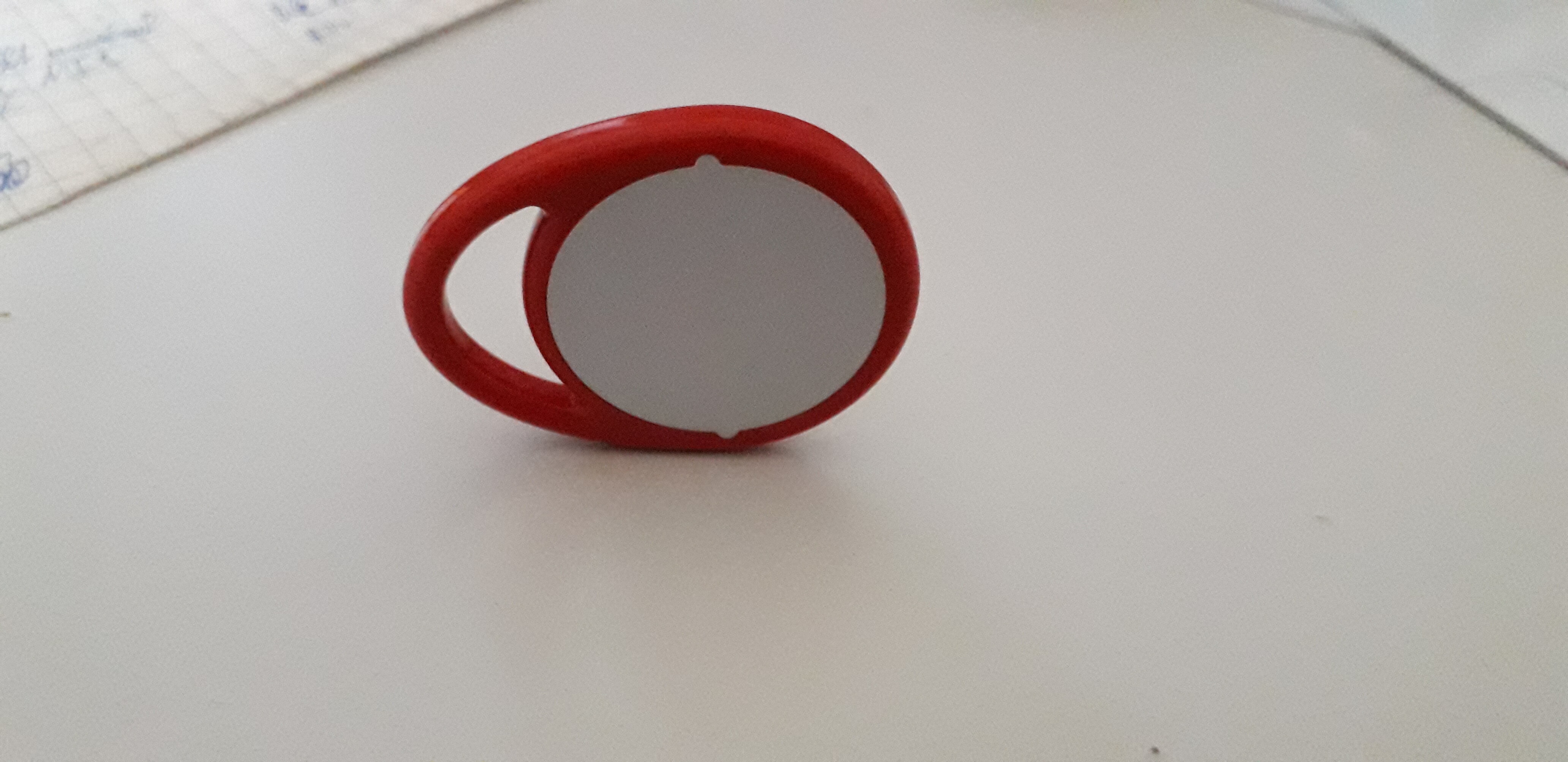

Lets revive this thread a little. Sooo i got a few Desfire EV3 to toy around with at work and so far it’s pretty promissing. I just tested 2 transponders for range on my phone. One is a Desfire EV2 8k and one is the new Desfire EV3 8k. EV2 has a Range of 22mm, the EV3 has 26mm of Range. The reading speed is also a bit faster on the EV3. The website of NXP slso has it listed now.
