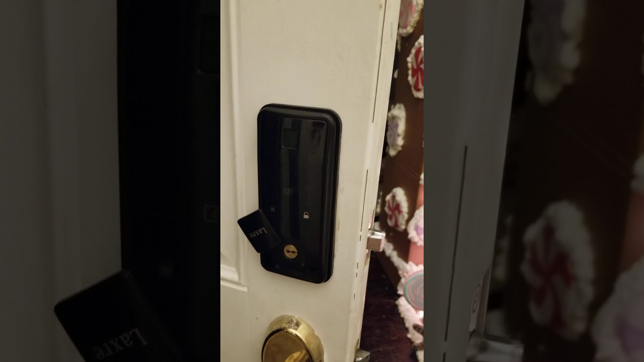

I used my NExT implant to open the lock which you can see in this video:
It’s very simple to program the lock for particular NFC chips, just use the Phone-App for the lock and that’s it.

The lock comes with two NFC cards which I’ll scan as soon as I’m back home, where you wnat me to send the results?

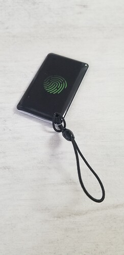

Here is a photo of one of the cards:
Here is the scan:
E6-FD-99-92_2020-12-31 13-08-29_taginfo_scan.txt (7.0 KB)

Nice one,
looks to me, to be a Mifare Classic 1k 4 Byte NUID.
It worked with your NExT, so my guess is it should work with ANY of the HF ISO14443A implants.
I’ll put it up on the Matrix today :+1:
