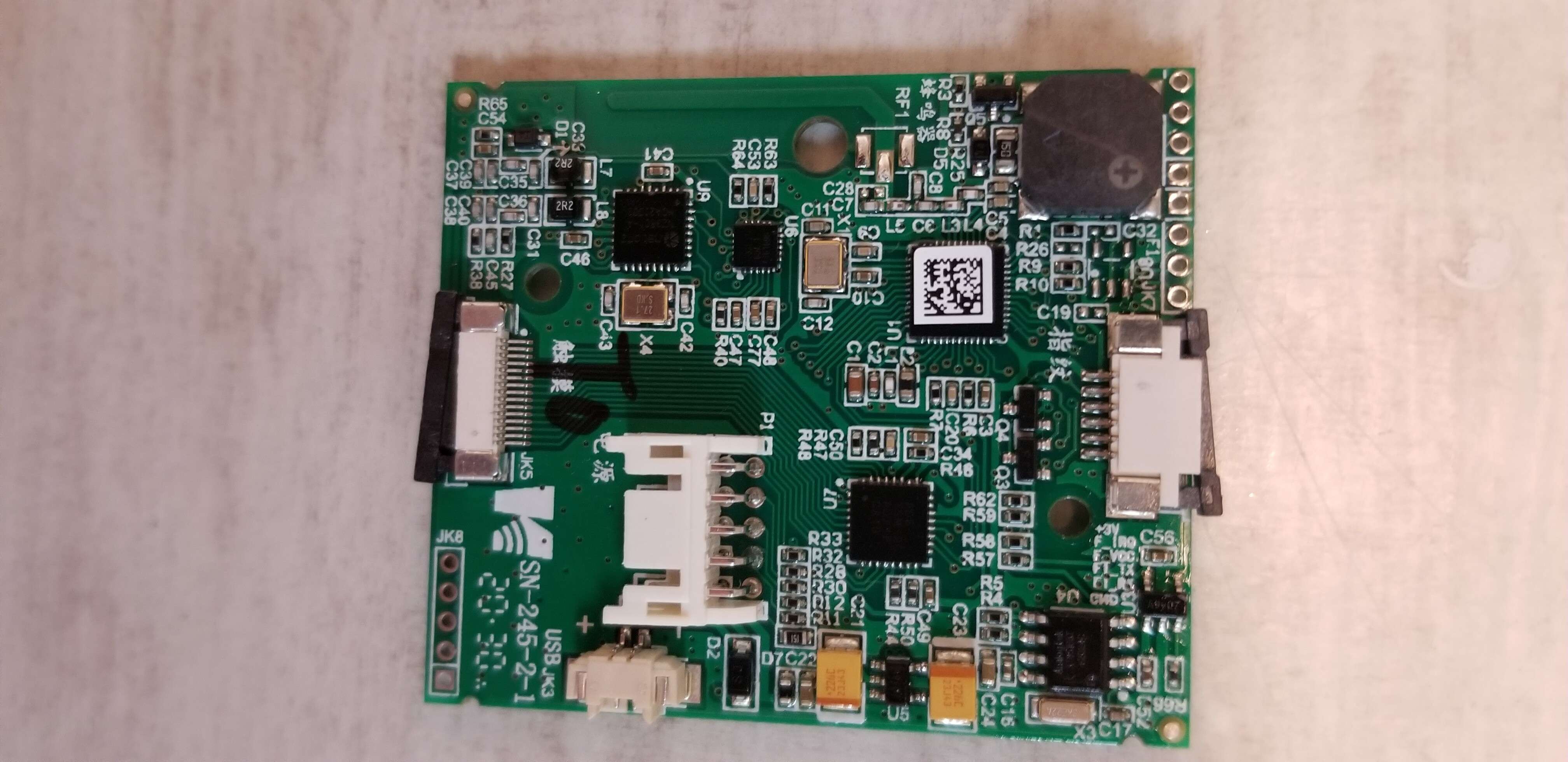

here is now my update on my new door lock from China. This seller has an Amazon store and offers his products with Amazon Prime, very fast free shipping. The lock came in yesterday and it looks awesome. Here’re the parts that come with it:
The black device is made from metal and very sturdy. The actual keys are special security keys which makes the lock hard to pick. Well, I know if one want to break in they’ll find a way, but hey who ever brakes into my house will just waste their time.

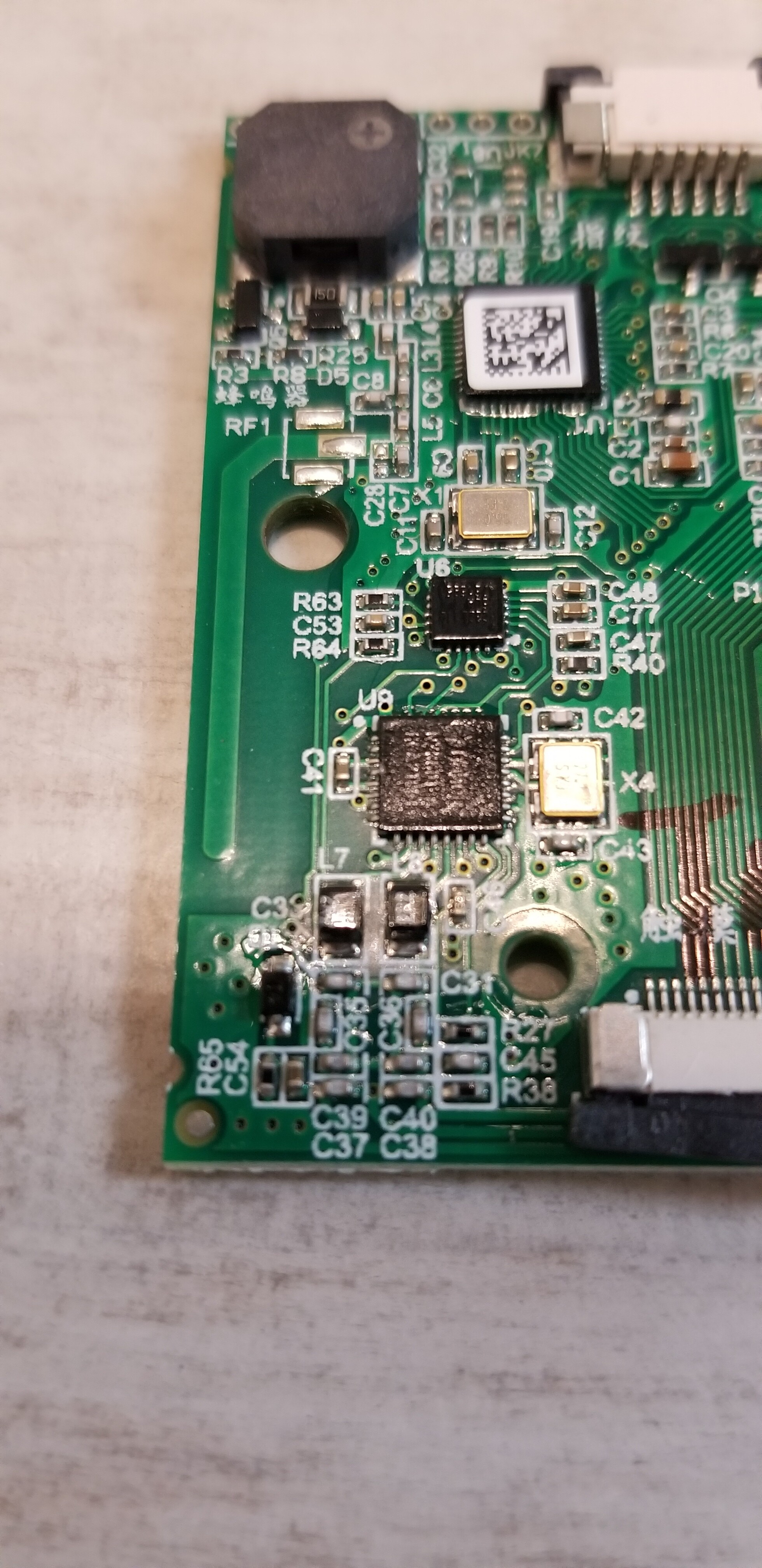

Out of curiosity, I took the lock apart to check on the internals. The PCB’s and the assembly is very good quality.
Here’re some pictures of the main board:
It’s kind of hard to make out what chips are used, but with some effort it probably would be possible. The keypad is made of a flexible PCB and has the NFC antenna incorporated. The keys are capacitive sensors, no mechanical parts. The fingerprint sensor is a module and can be easily replaced in case it gets damaged.
