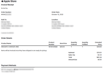

Are you saying this is an Apple certified magsafe charger that blew out your card? I only ask because chargers that comply with the standard will not do this. Only Chinese garbage chargers that ignore the standard and ust pump out tons of power will burn things out. I’d be very surprised if an Apple certified magsafe charger did this.
Yep, if you can discount a replacement I can video it for you this time
. I got the charger through the apple store so that’s as legit as it gets from what I can see.
