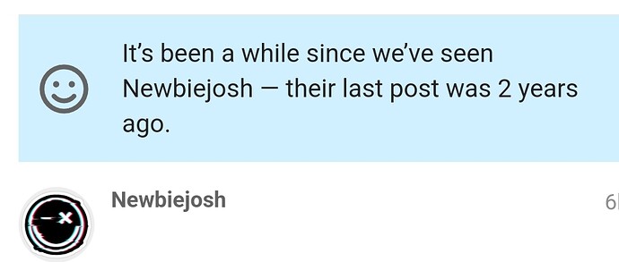

Oh, so that’s how it is, is it?
We don’t see you for 2 years, and then you come crawling back when you want something!!!
Cool, Welcome back :pbjtime:

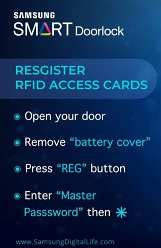

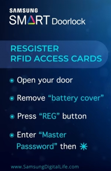

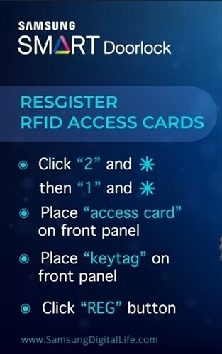

I might be popping into a Bunnings today, if they have one out on display, I’ll give it a try and let you know how I go.
The master password on the demo I watched was
1234
Was that the same for your display lock?
Hahaha one truely never leaves this forum, just lurk in the shadows :wink:
And yeah same as my local Bunnings, i could get it notice my tag when it wasn’t paired. Removed the “door closed” tag and put it into that pairing mentioned but just couldn’t get it to notice the chip.
If you manage to try/get it to work please let me know!!! Possibly the em part of my next that I’ve never played with?

Unfortunately, as it was an off the cuff visit,I was ill prepared, I only had my phone and me FlexM1 gen2 to test with. I would normally have my backpack with enough “stuff” to do better testing But I didn’t.
I can confirm though - again, as expected - The lock requires more than just a (N)UID to unlock, I got a “~This card is not registered”
I didnt want to do a Info dump and put that on my FlexM1, because I remember there being something peculiar with the Samsung Mifare Tags and didn’t want to risk fucking up my implant.
Also the same reason why I didn’t try to enroll it ( In hindsight, I should have grabbed the dump on my MTools App, and saved it for later )
Next time I will take a sacrificial fob / card, Flipper and give it a proper try for you.
